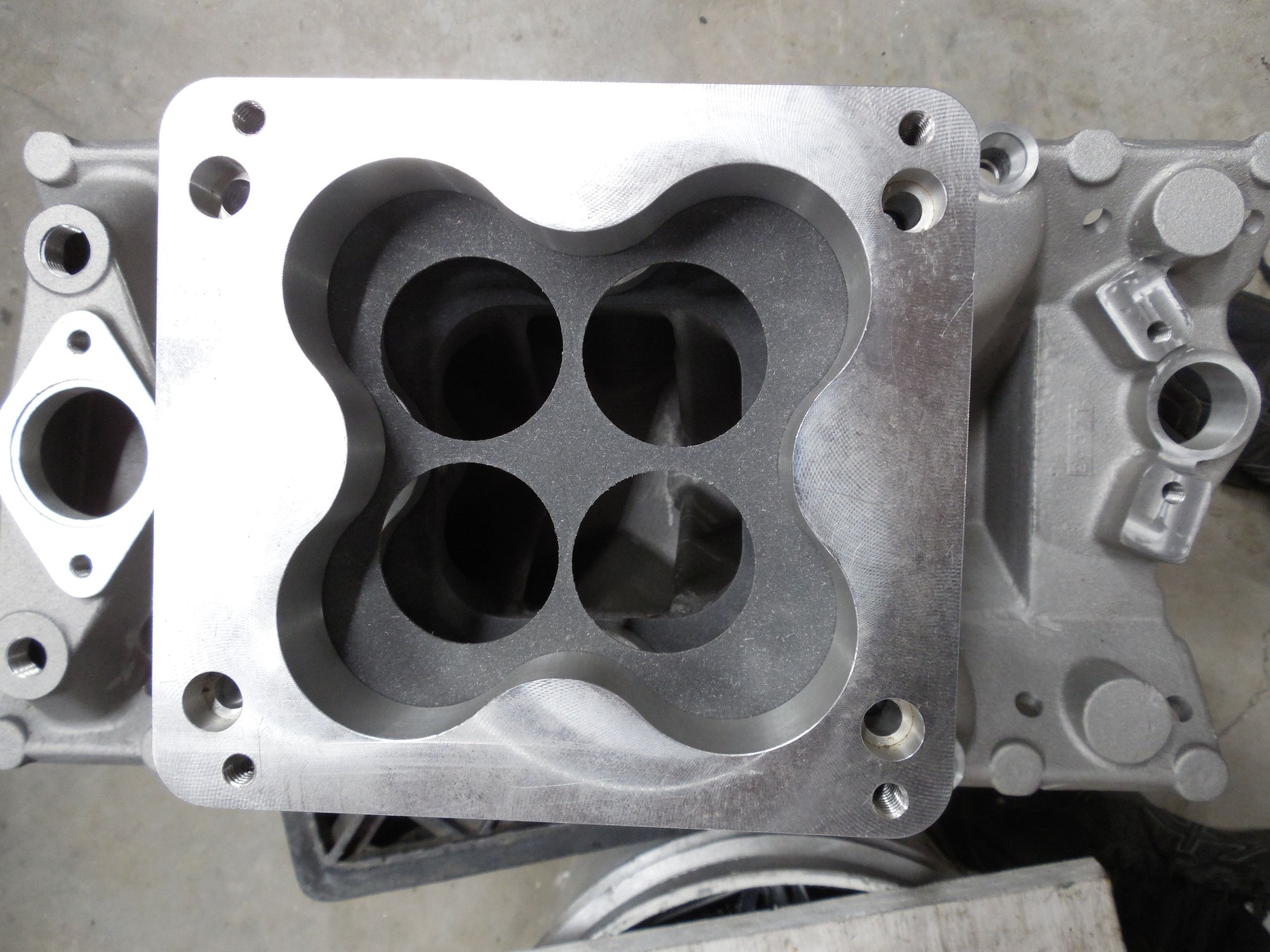

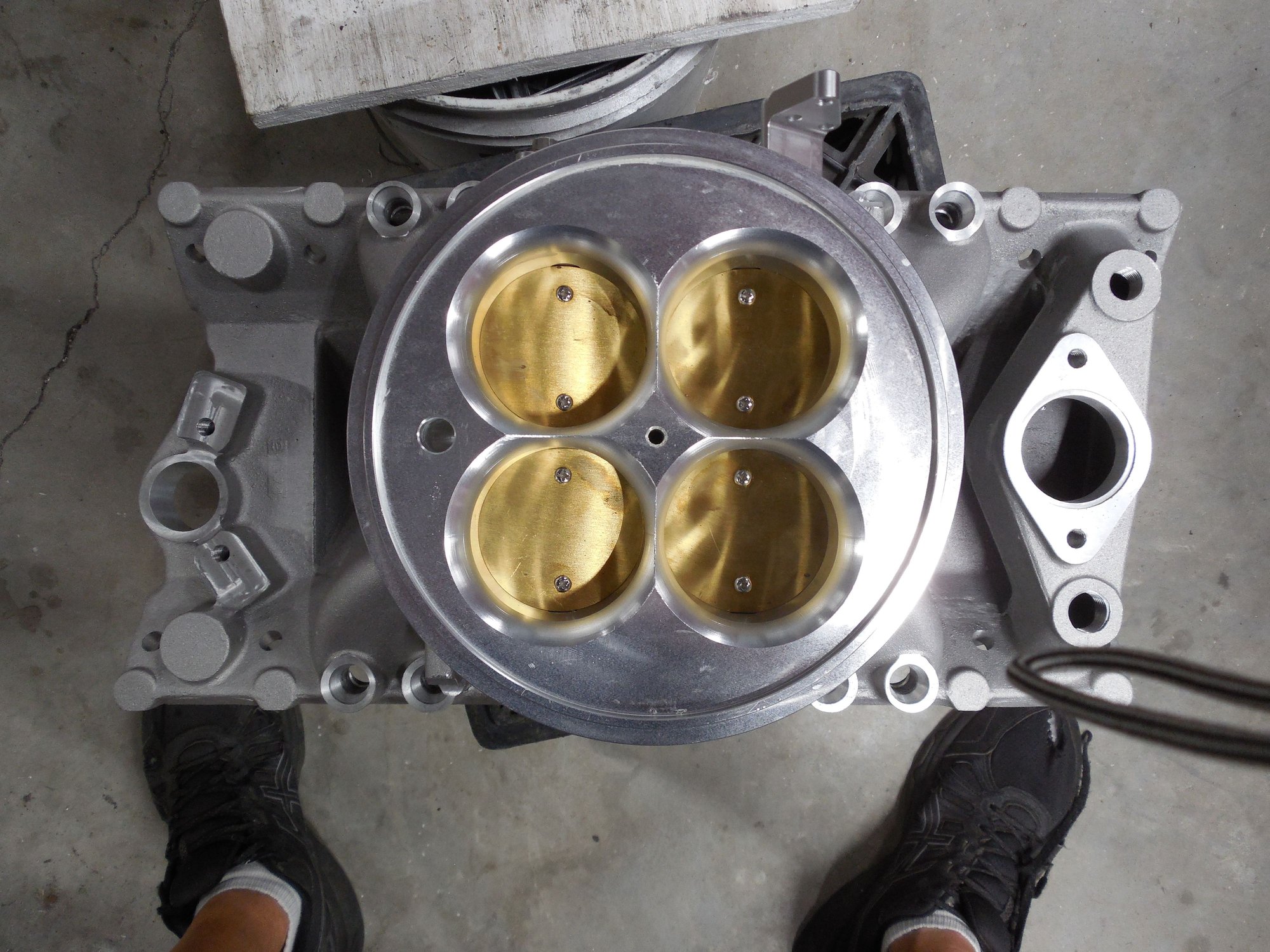

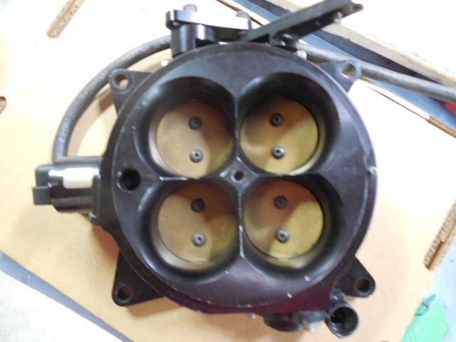

..... I have noticed from day 1 on the engine dyno that the datalogs were showing some vacuum at W.O.T. ... eg ... on a 101kpa pass , the MAP is dropping to 94kpa ... my 421 with a very light rotating assy likes to suck air through the 227cc intake ports and the professionally ported Victor E intake manifold topped with an Accufab 4150 1200cfm throttle body ... sooo ... I finally found a 1/2" adapter plate (hood clearance issues) to try a 2200cfm 4500 Dominator Throttle Body ... both TB's are 1 3/4" tall ... due to the proximity of the hood , the extra 1/2" might cause me to forego an air filter ... I presently have the shortest K&N 14" round filter @ 2 5/16" tall and a K&N filter lid on the 4150 ... Stay Tuned ! ... I will follow up with some intel on the change .....

..... But this is more adapter than spacer ... I agree that it is also there as a spacer by default because its the only way I can put a 4500 TB on a 4150 manifold ... at least long enough to see if doubling (almost) the flow through the mouth of the intake manifold will eliminate some if not most of the resistance/restriction ... or maybe help me to shift the blame further downstream ... I have a 1" spacer too , but I don't want to put the TB any closer to the hood than it already is for all of the same airflow reasons ... I realize that the best course of action would be to buy a 4500 flanged intake manifold ... but I have searched and they are all much taller than the 4150 and finding dominator intakes that are set-up or can even be converted to Fuel Injectors has been near impossible ... the only one I have found is a Bill Mitchell Performance manifold but then it would need to be ported and machined for injectors .....
..... Another path that could and might still be taken , would be to have a 4150 4bbl TB converted to 2 oval throttle plates ... I know a guy .....

Not sure how air is going to like the void then finding its way through the 4 hole deal? Keep us posted
