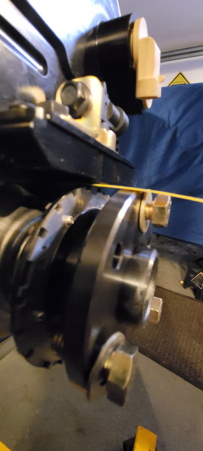

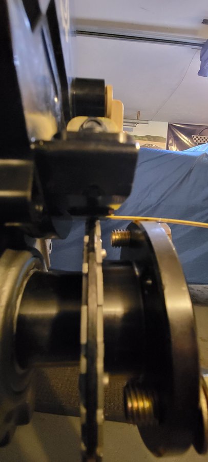

How tight does the crank sensor need to be to the wheel because the way I have it setup there is a little drag on the tape... I sent these pics to Paul and he said they looked good... so a bad crank sensor will cause no spark?

The clearance/ gap looks perfect.
Just enough contact to feel drag/ Resistance.
Re-read from TH my previous is backwards

End result. Your coils are connected, good fuse? proper crank sensor gap. NO spark.
Unknown reason points to the crank sensor.
What did Paul say. Besides the crank sensor gap looks good.

I showed him the picture when I was putting everything together because I thought the slight drag notation on the directions was a little vague. He just said it looked correct.
