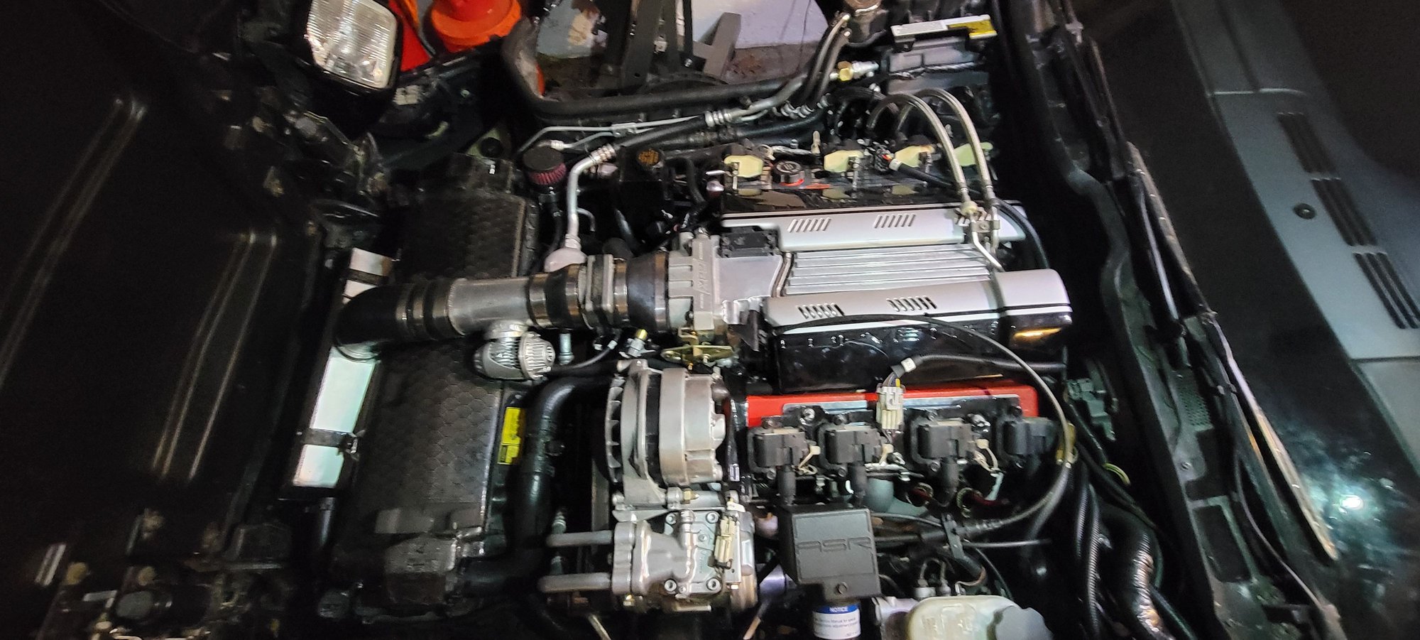

I am in the middle of a big build, I had a 383 LT1 built with all forged internals with 9.5:1 CR, custom ground turbo cam, and AFR 210 heads. I am using a TorqHead kit to be the standalone ECU but for some reason it is cranking but not fully firing up. I haven't had a chance to diagnose the no fire situation so I am asking what steps should I take to diagnose this.

Yes I installed the Optispark replacement assembly as per the instructions and I did use and follow the instructions using gap strips when setting the Crank position sensor.

what do you mean... the coils are hooked up correctly, i can smell gas after cranking it but nothing as far as fuel and spark tables have been altered as i have not had this engine fired up since its been in the car

I have not verified spark yet.... I just tried starting last night and this is my first build... so my diagnostic proceedures aren't quite up to snuff... do I just pull each wire and ground out the plugs on the block and look for spark? And say the crank position sensor is faulty would it not spark at all?

Do you have a timing light. Just place the PU. Coil on your wires. You should see spark from the flashing strobe light. Alot easier and safe.
This system should still fire without the crank sensor.
The cam sensor is critical.

I do have a timing light so all I need to do is clip around the plug wires? Pardon my ignorance as I have never used a timing light in my life... the only reason I have one is my dad gave it to me when he was cleaning out his garage. I should have the fuel pump power disconnected whilst doing this

Everything is connected correctly as per instructions, I am getting 43 lbs of fuel pressure at the fuel rail with the key on. I checked the 1,3,5,7 and 2,4,6,8 black and pink connectors and neither of them are getting power. What could be wrong if the coils aren't getting power?
