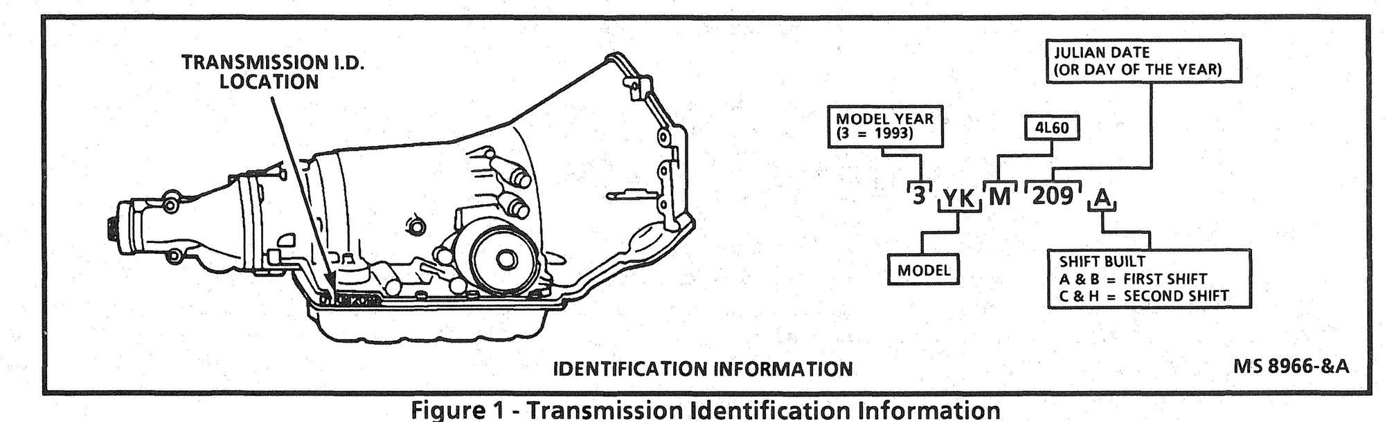

PS: While you are under there, write down the model number from the back right pan rail so I can look up the electrical schematic for your trans.

That is not the number needed. It should start with a number followed by a two or 3 letter string.

Whereabouts on the trans can I find it, not sure what you mean about pan rail?
Do you mean the flange on the pan?

A '90 I might expect you to find it's a 0 YDM

Hi guys, thanks for your input.
1) I will find the ident number as requested

checked for the transmission I’d number but could not find one on any part of the transmission casting that picks up the pan and I viewed this from the top with the tunnel removed.
