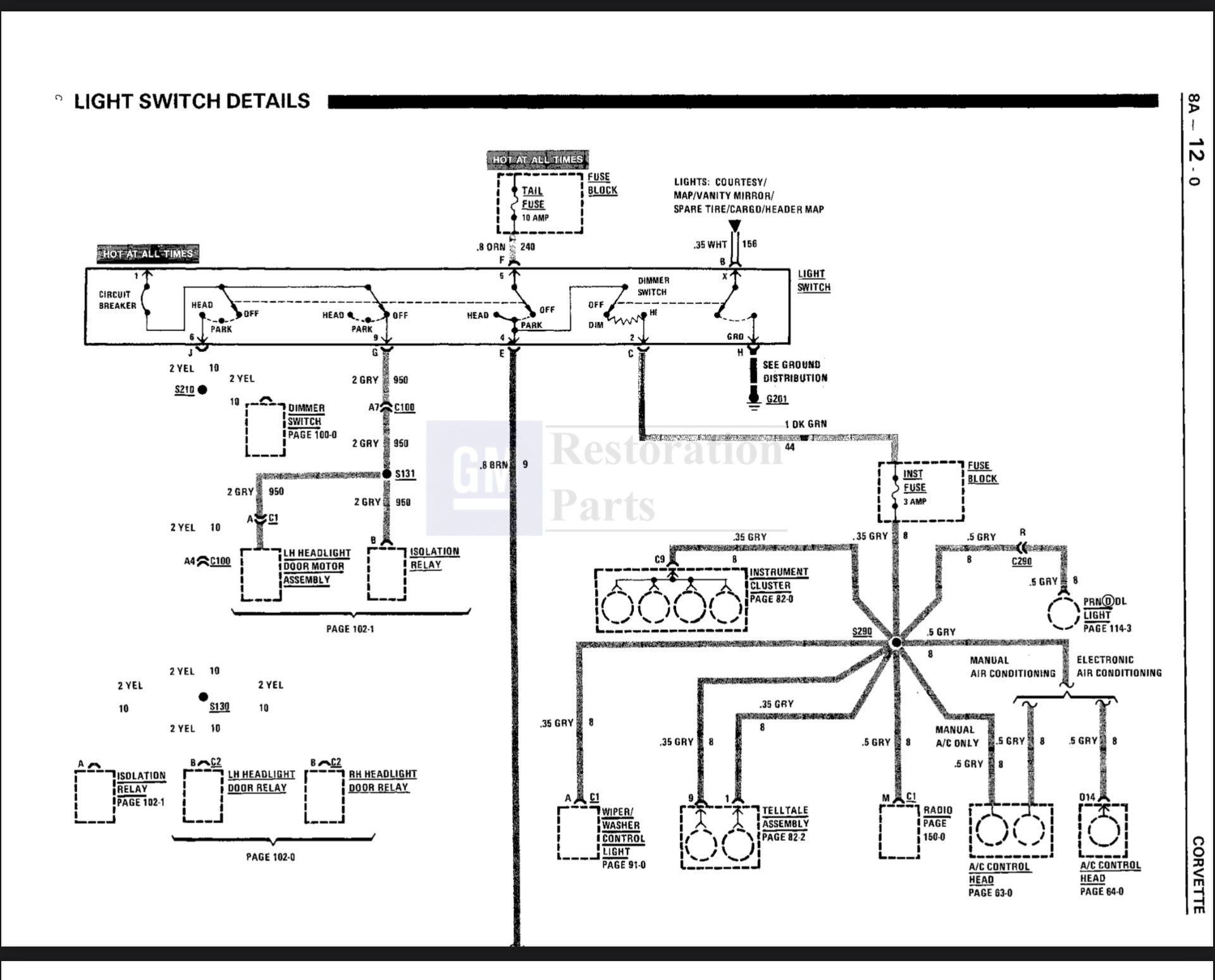

Old Jan 3, 2023 | 03:18 PM

You’d think the TAIL FUSE feeding everything after the Light Switch would be a clue:
Love this diagram. I have a Haynes manual. It's almost worthless. What manual did you pull this from? Thx
