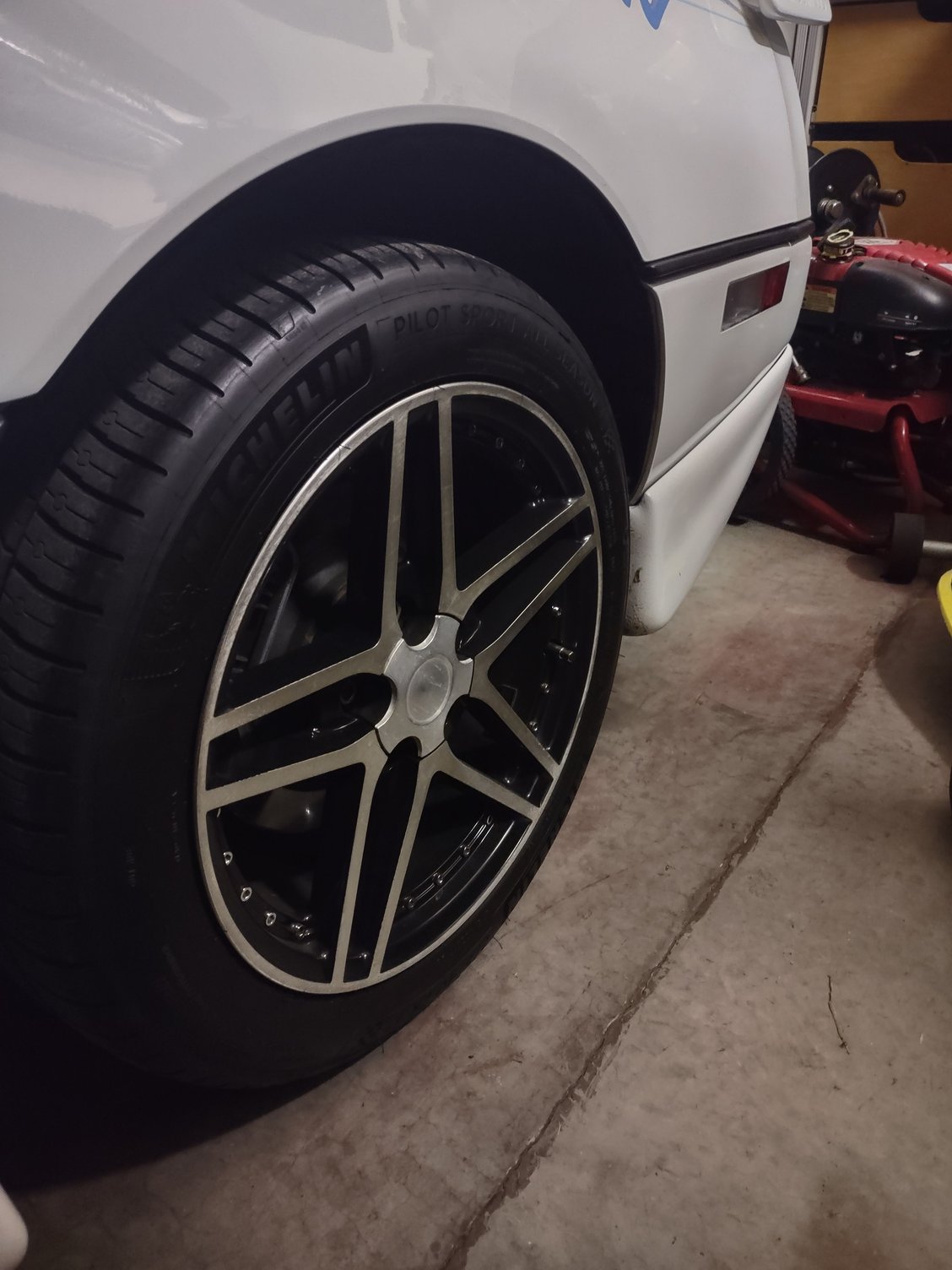

I ended up purchasing a tire rim package deal for $600. All new in May 2021, Michelin pilot sport all season tire.
I do prefer the Goodyear eagle GT for sure and will buy them when they become reasonable in price, and use the factory salad shooters. The Michelin tires are too responsive and grab like crazy, enough where the car shifts, jumps around going over bumps and ruts, where the Goodyear eagle GT were just a great performance tire, not a fan of the rim style either but the price was right and I wanted a tire I can trust on a long drive
