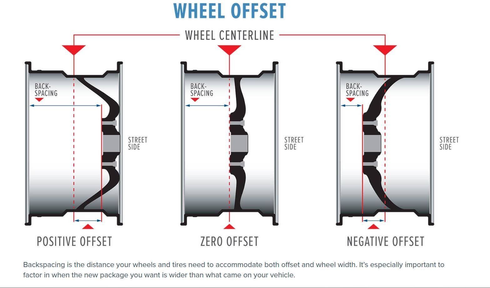

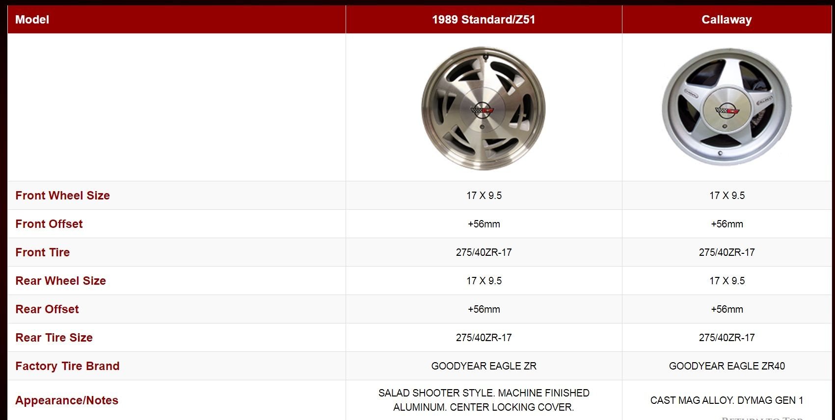

Here is what Mirrock corvette states about 1989 C4 wheel sizes. And below that is a Wheel offset explanation.

People! Let's stop guessing. The OP's car came from the factory with 17x9.5 "salad shooter" wheels like the ones for the base/Z51 89 in the picture Vets-Vet posted. If his wheels look like those, that's what he has. If not, then we need to know more info. The proper tire size is 275/40/17 like the OP has now, and there's no good reason to change that.

I appreciate all the comments, yes matthewmiller I have the OE salad shooters. I will drive the car up until the county puts down the salt brine, which hasn't happening yet. I'll look into the brand tires you mentioned. Thanks, Mike
