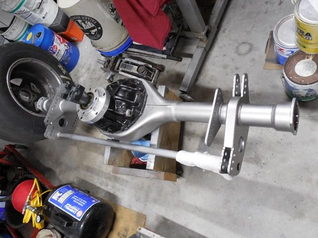

I did all the work/labor on my 9" conversion with a few minor exceptions ... Done in January and February of 2021 ... I spent close to 6K but I used quality stuff ... Moser housing and axles/brakes ... Afco double adjustable coil over shocks ... new P.S.T. driveshaft ... Ebay dragster chunk ... A.R.T. 4 link tubing and threaded ends , panhard bar kit , misc brackets , spherical rod ends ,etc .

Thanks for the pics. I’ll have to carve out some time on the weekend so I can look under my car and answer some basic questions that I have about how your axle attaches to a c4. That trailing arm mount can’t be the only attachment point.
Trailing arms , shocks , and panhard bar are the only pieces that keep the rear under the car ... the upper pics show the "set-up" trailing arms ... the pic with a brake rotor shows the final link bars ... they are chrome moly tubing 1 1/4" uppers and 1 3/8" lowers ... as I recall , the panhard is 1" ...
