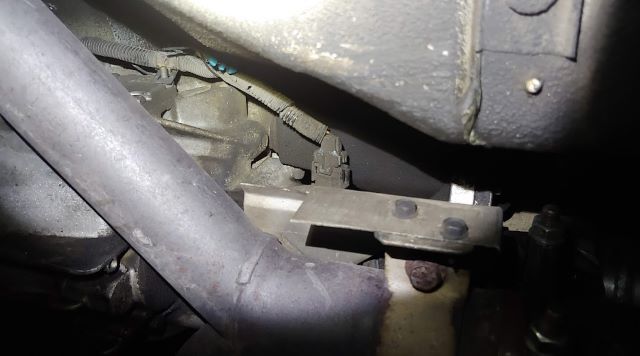

Just looking at it, I don't see how I'm going to get my hand up in there. The exhaust and the X-brace are right in the way. Do they need to come down?
Old Apr 17, 2023 | 03:48 PM
frosted's Avatar
frosted
Joined: Jan 2013
Posts: 128
Likes: 26
Very likely, at least the X-brace certainly.
Here's my 91, I'd probably get the sensor without dropping the exhaust. Only lots of rude words and blood.
