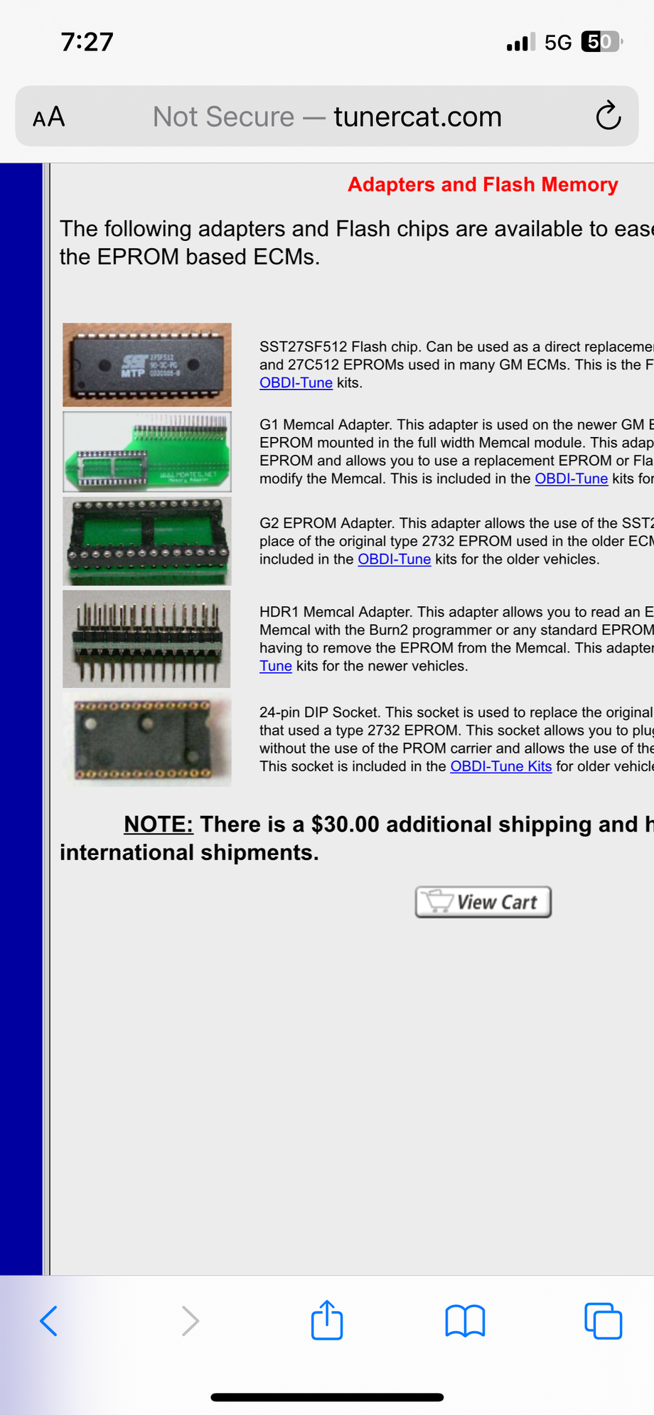

You need the adapter at the very bottom of the pic. Your memcal piggy backs onto the adapter and the ribbon cable from the ostrich plugs into the adapter in place of where the EEPROM would normally go (ZIF optional). The whole assy in turn plugs into the ECM. You also need some kinda cable/bluetooth adapter that plugs into the aldl port and interfaces with a laptop/android phone/tablet to see the real time data.

This is really great. Do you know what number/name of the adapter? I have Tuner Pro RT, I ordered the ostrich. I don't know what adapter it is. Thank you

I ordered the ostrich. But, I need the adapter. There are several adapters on the page. I'm not sure which one to use. I also have a chip burner

Welp Moates called it a G1 but of course you need to go to the other company that picked up when they closed their doors...
Red Devil River or BoostedNW...

I went to ebay and found this
https://www.ebay.com/itm/11419198720...Bk9SR-qv8K6JYg
Sorry for the long URL. Is this what I need?

I found the adapter on ebay. The seller called me and assured me it was the correct one. Thank you all again

Yar that looks right. Just plug the ostrich in instead of the chip. Hope the tuning goes well for you.

In the picture post #5, pay attention to that red strip on the ribbon cable. It designates pin 1 on the EPROM and you need to attach ribbon cable in that manner. The notch on the EPROM also tells you which side pin 1 is as well.

BoostedNW has the version of the adapter its called a GM1 adapter for the wide memcals, for the older GM ECM's that have the 24 pin, they have an adapter thats called the GM2 (its a solder in adapter to adapt 24 pin chip to 28 pin FLASH capability)

tunercat has a good quality adapter. But since this is a old post probably got it going by now.
why mention a 24 tbi 85 tpi adapter? Doesn’t seem to apply to anything here ?
