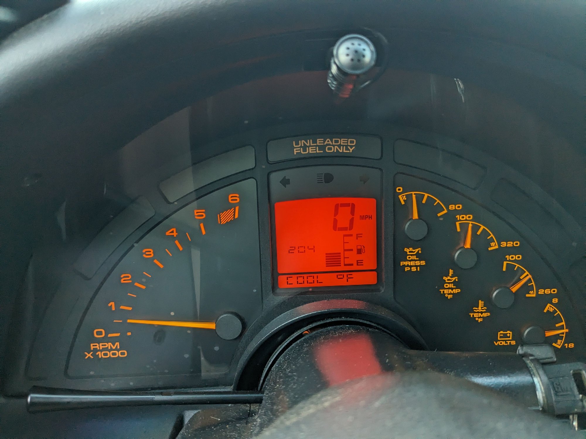

Thanks for the advice guys. I did like you said. The wife and I went for about a 45 minute drive and it purred like a kitten through the Pennsylvania hill country. Smoke was minimal while driving and it doesn't seem to be smoking now back at home. BUT about half way through the drive oil pressure gauge started varying heavily (heavily = one whole quarter of the gauge) dependant on throttle position. By the time I got home it was holding below the first (20psi?) mark on the gauge. It also seems to be idling at a lower rpm than normal but maybe I don't remember. Picture is at idle in my driveway after the drive. You can see both the pressure gauge and tach.
After shutting her down I checked the oil level on the dipstick and it's right where I left it.

What you are describing is perfect oil pressure!!! You are good!
around 20 psi at idle is completely normal when hot. oil pressure varies with RPM, the higher the RPM the higher the pressure. Someone will chime in and tell you exactly what PSI to expect per additional 1k rpm.
Also when nice and hot the idle will settle lower.

My analog gauge sits right where your picture shows at idle after warmup. You have no worries.

I'd suggest another oil and filter change soon(ish), doesn't cost much and makes sure there aren't any contaminants left in the oil. The lower idle is probably because the ECM is now able to better control the amount of fuel. Picture shows perfect gauges, you're good!

Everybody - God is good - y'all seem to be right. Put about 150 miles on it in the last 2 days and it is a happy corvette!
