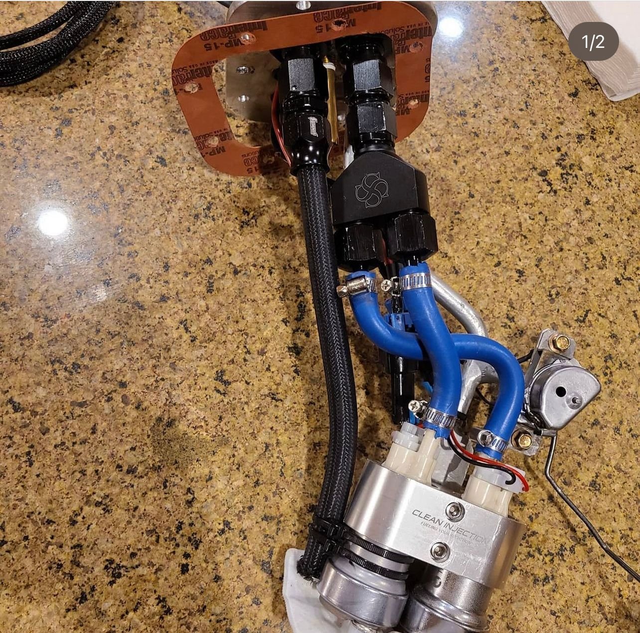

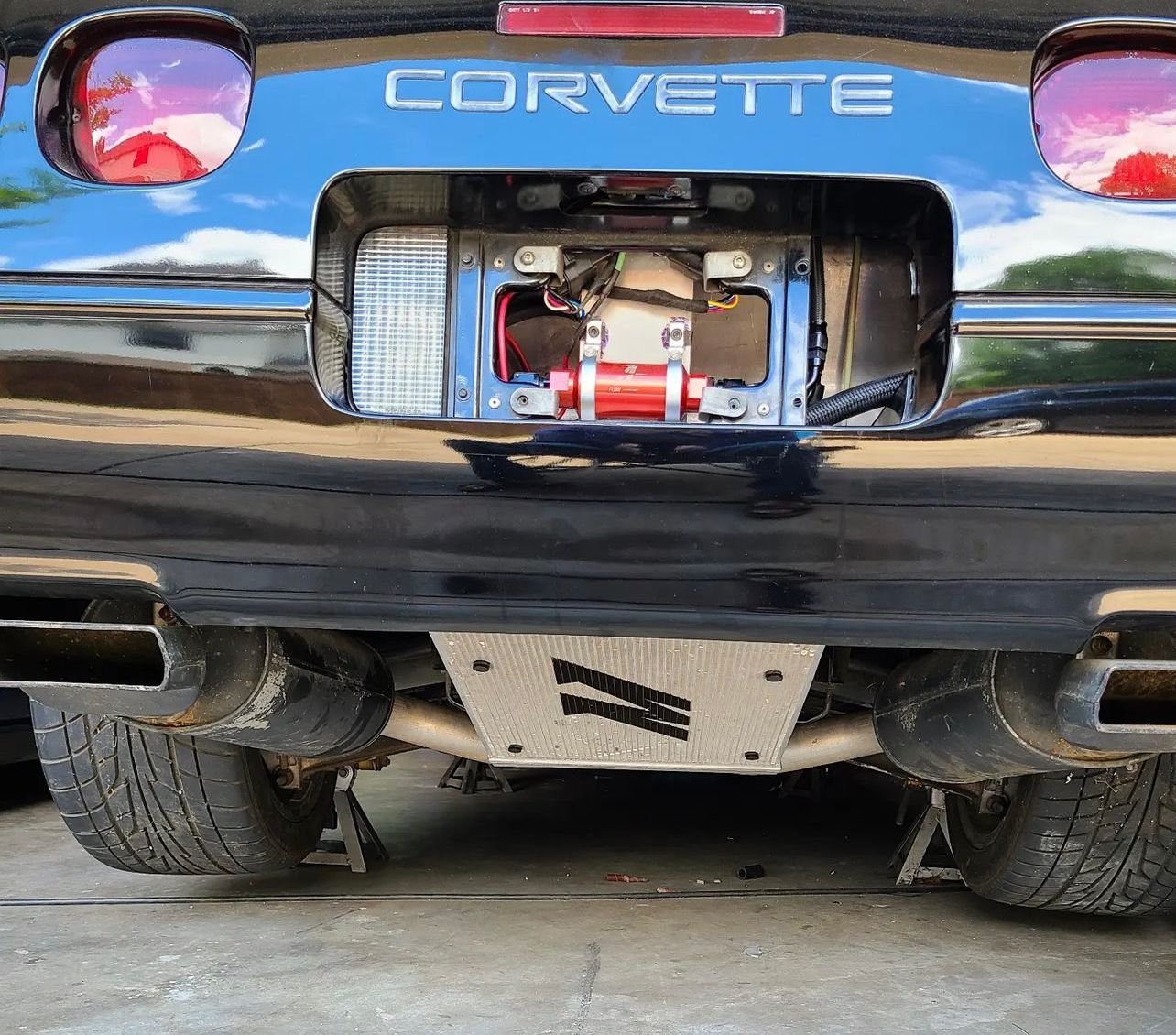

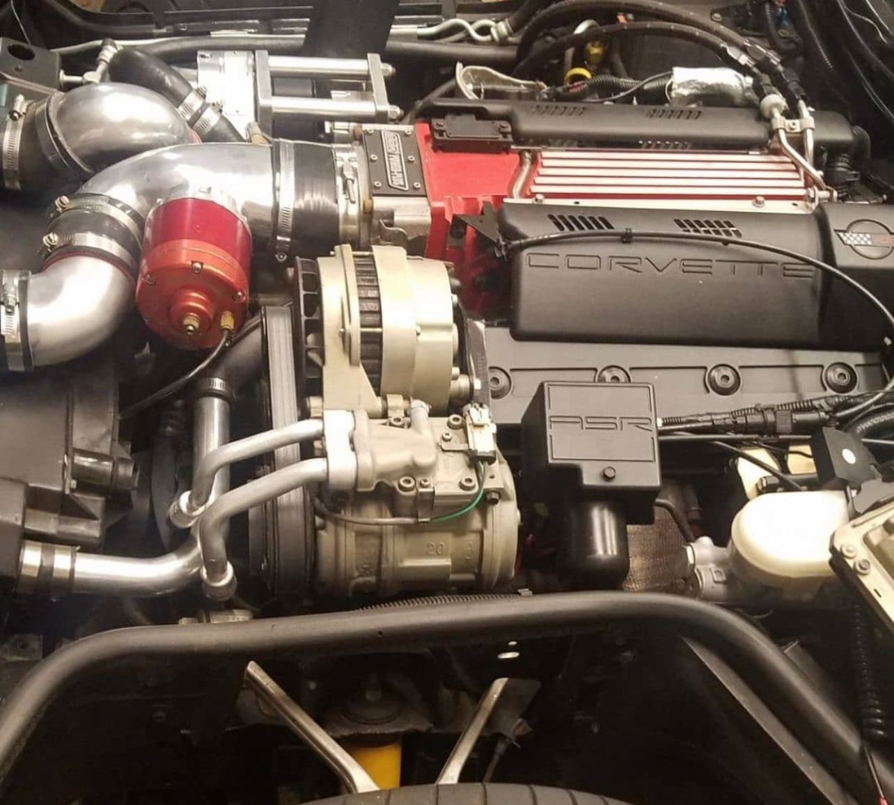

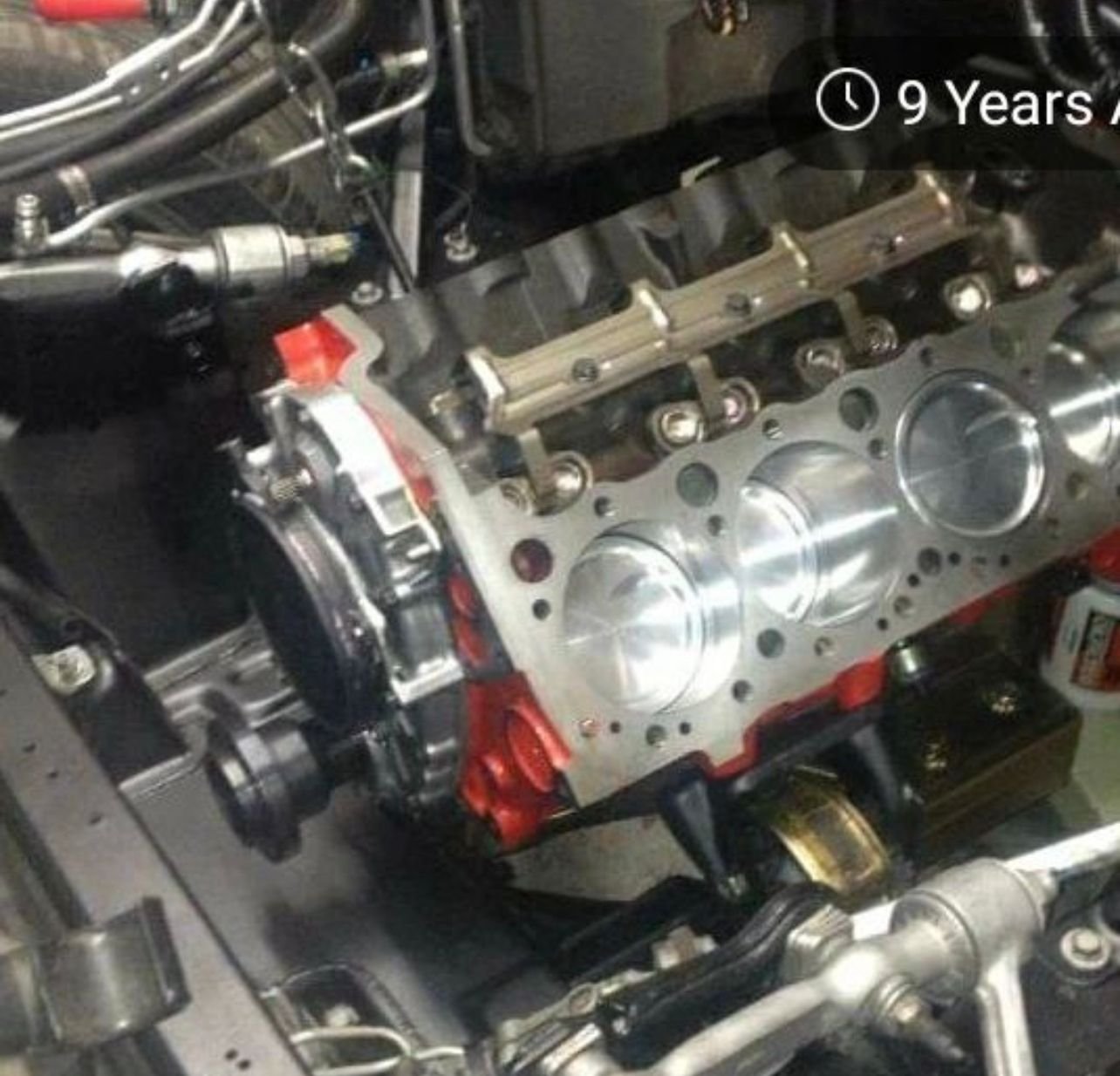

Build:
4340 forged crank
h beam rods
diamond Pistons
comp cams
ported heads
1.6 roller rockers
ltcc ignition
6+12 crank pulley
F1r procharger w/dedicated 12 rib drive
mccloud twin disc clutch
133 lb high z injectors FIC
electric water pump
air to water intercooler
bbk twin 58 throttle body
1.75” long tube headers
twin in tank 525 lph fuel pumps w/Hobbs switch
electric brake booster vacuum pump
aeromotive fuel pressure regulator
remote mount heat exchanger
