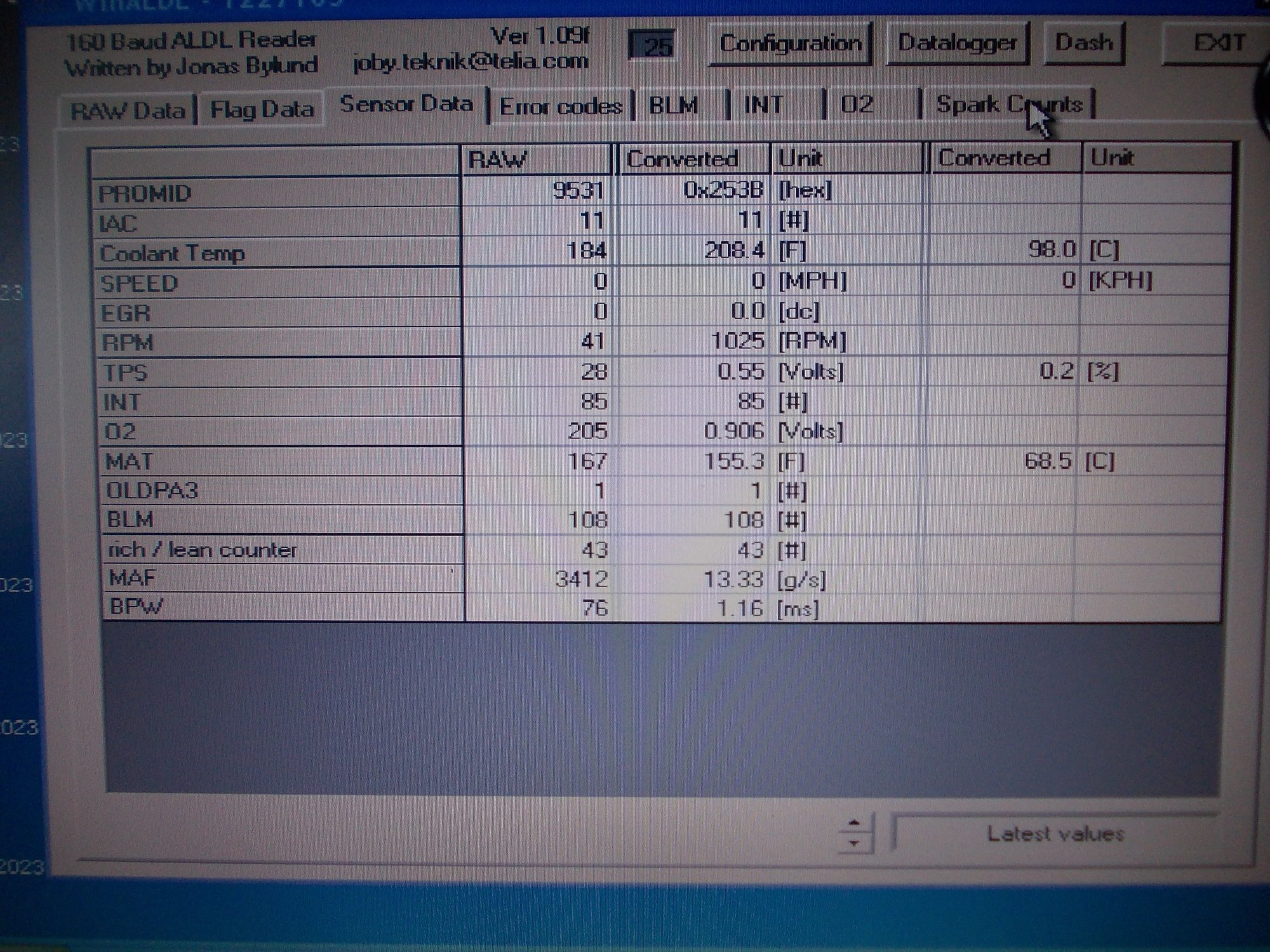

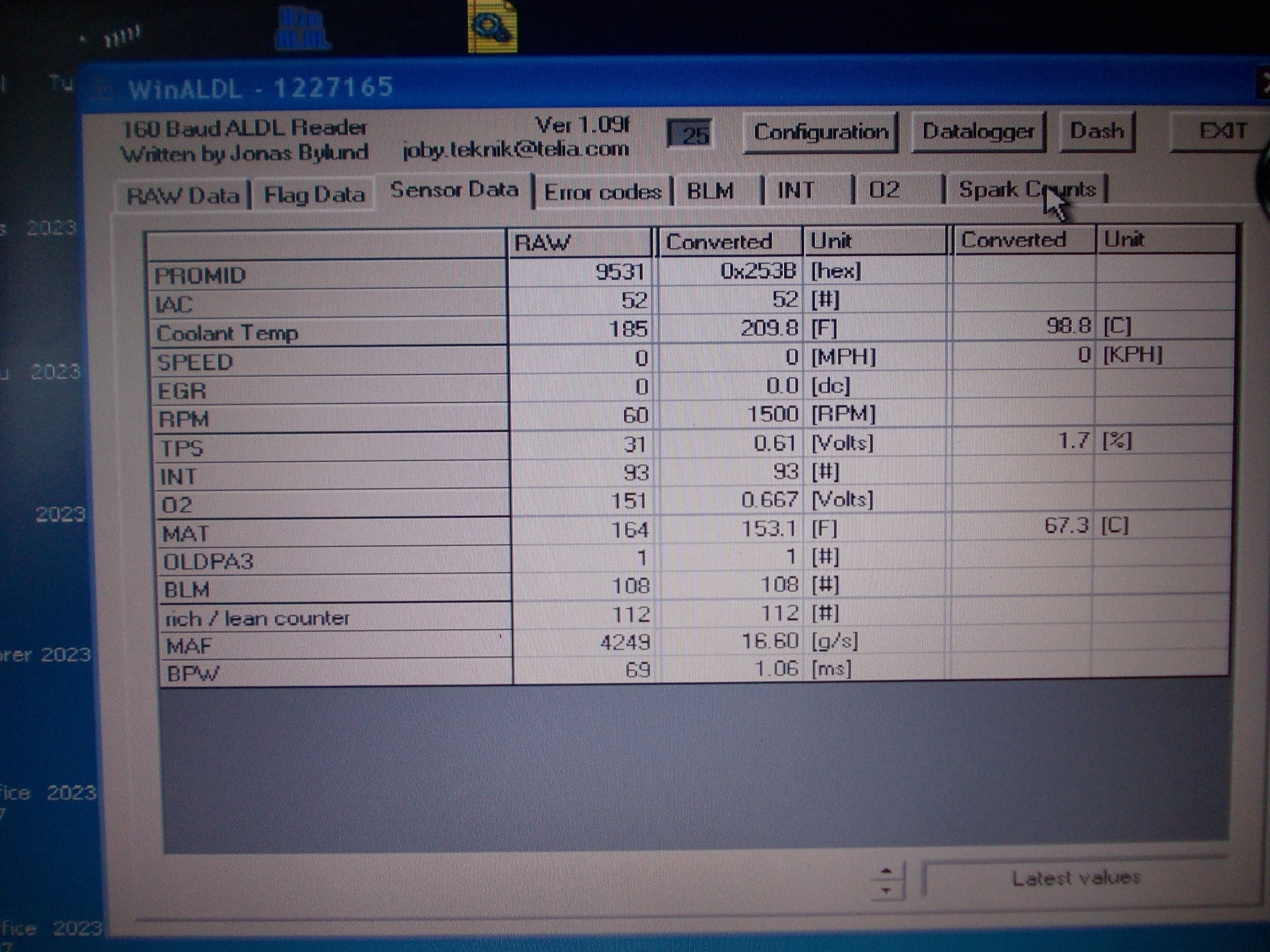

I made some measurements: I disconnected the synchronization wire and put the timing light on 6°, I reconnected it and the advance oscillates between +/- 6° and +/- 12° as my idle varies... putting a good blow of gas it gives +/- 32°, no more. These are measurements evaluated with a meter with the engine off and my memory of the position of the mark on the pulley.
I also took readings with Winaldl if it can help things move forward, the first at idle which was at 1000 rpm, the second at 1500 rpm and the third at 2025 rpm stabilized. We can see that something is wrong I couldn't do it while driving because I was alone and it's raining like hell in Belgium.
Oops I made a small mistake the first 2 photos are reversed

Always start with the code set from the front of the engine going backwards, so the MAF code first. There is a code 33 test procedure. If it sees the MAF off, it would definitely cause some running issues. Your IAC counts look fine, so the IAC should not be the problem.
Then clear the codes and see what comes back.
