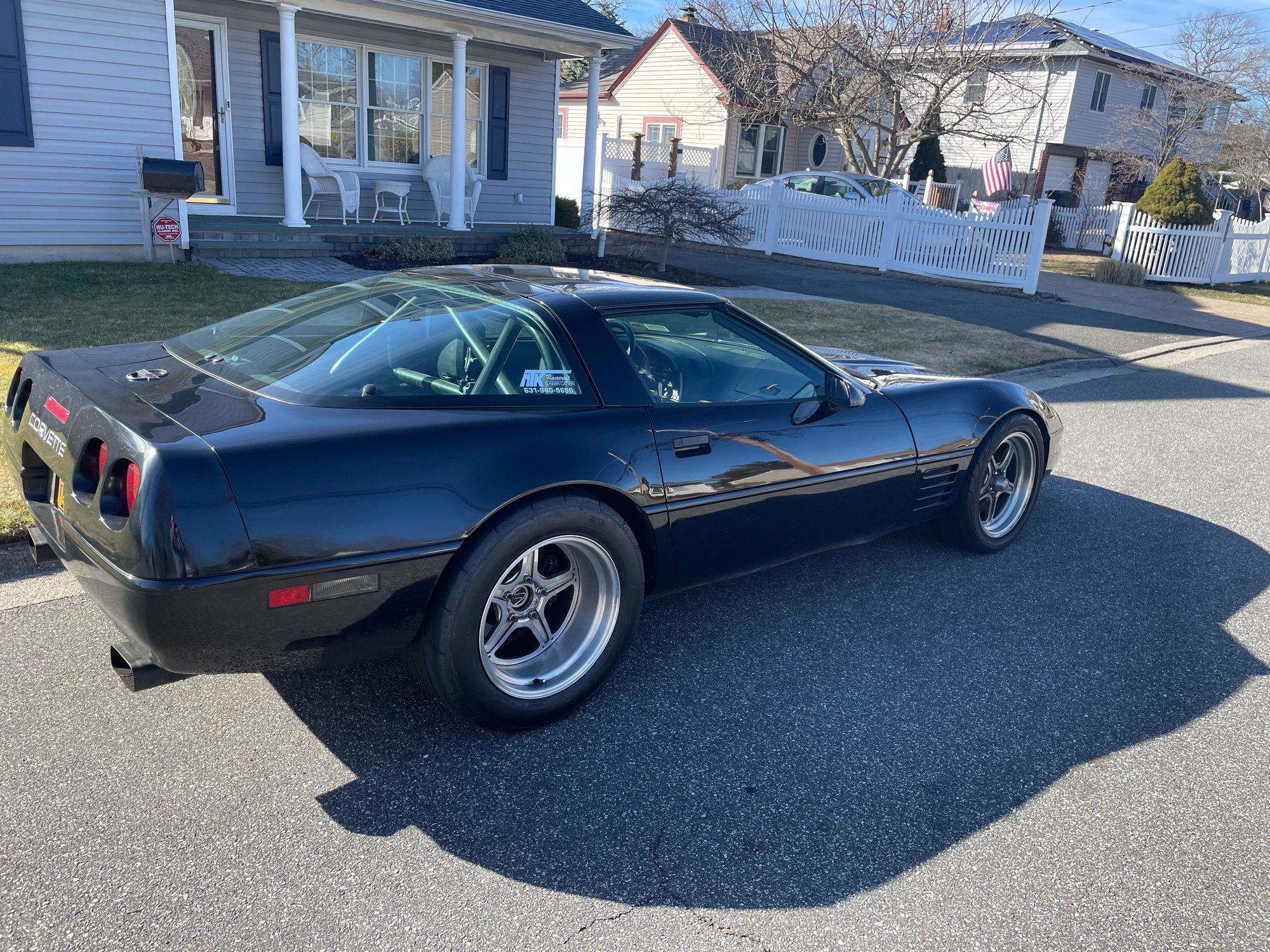

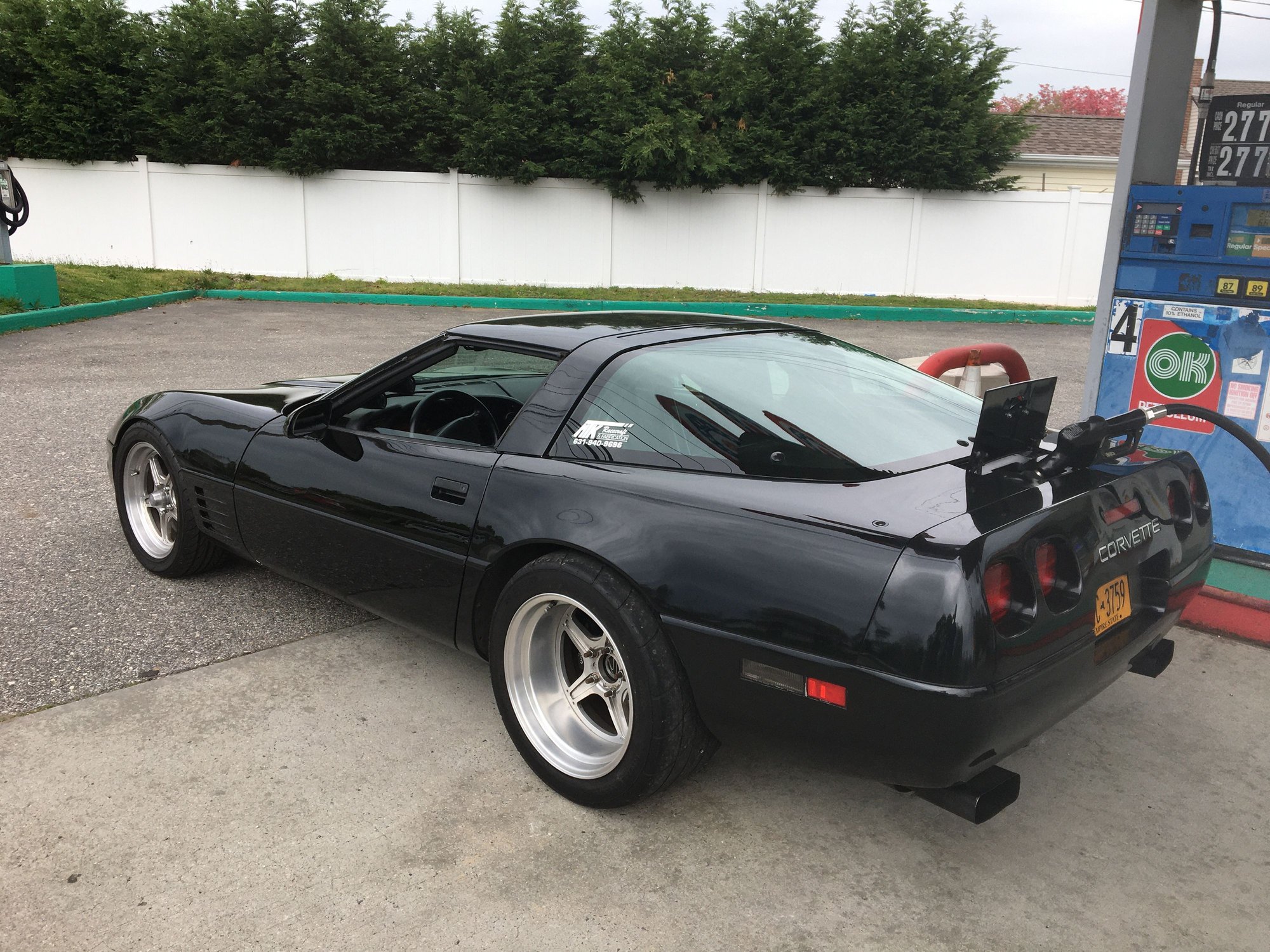

Any competent chassis shop can fab up a solid axle. A forum member used to make a bolt-in kit also.
I have a 9" 4-link wishbone in my 92. If I was to do it over I would go 3-link similar to an older Shelby Mustang. Will (with white Corvette) also runs a 3-link. The 3 link can be set up to handle good and still be great at the drag strip.
Attached are photos of my 1992 with 26" and 28" tires
