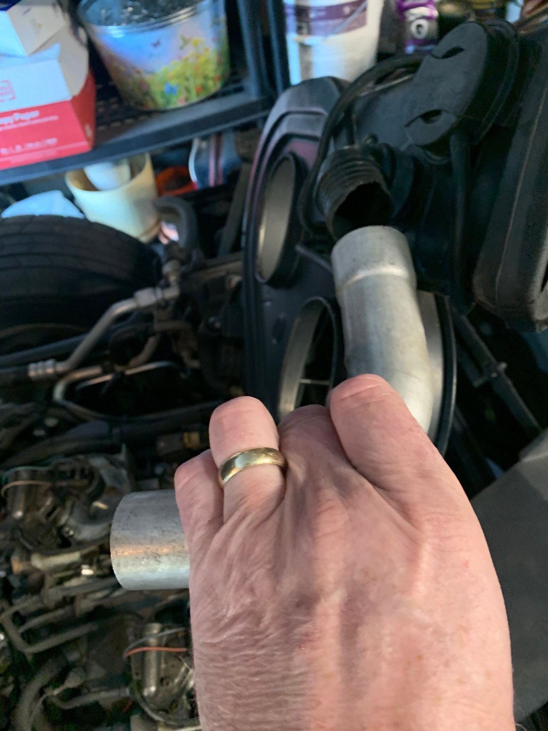

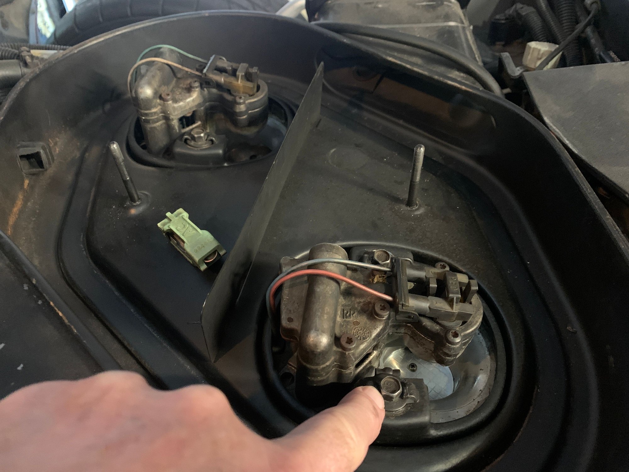

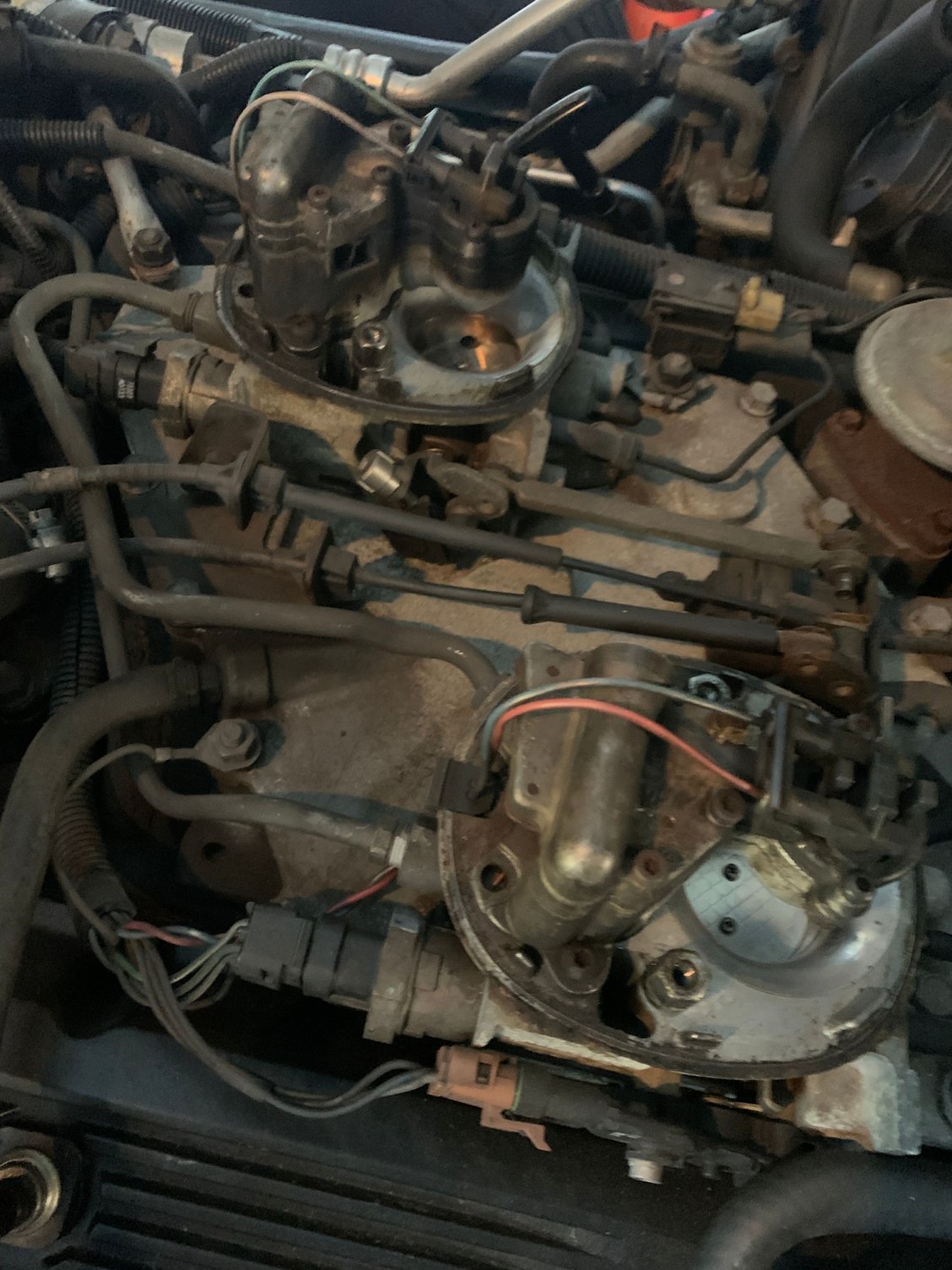

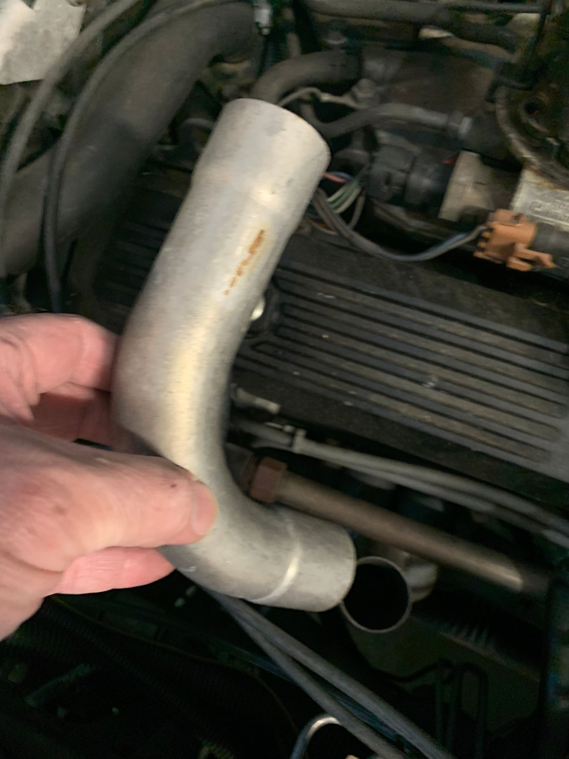

Here are some images that show some of what S Carter is referring to.
Loosen these four bolts and remove the two rings surrounding the throttle bodies.
Two rings removed. It is not nessesary to completely remove the four bolts.
Here is the PCV valve.
Here are the throttle bodies to spray the carb cleaner around.
Pipe coming from the exhaust manifold that the other end of the stove pipe goes to.
Make sure when you replace the air cleaner base that this "stove pipe" is back in place on the base and the exhaust manifold. In the photo I just tipped the air cleaner base up against the windshield so not to disconnect any hoses. The big vacuum hose is hidden by my hand.
Make sure you put this breather hose back before you put the air cleaner top back on.
I really appreciate this!
im going to try to do this, thanks for the visual representation. Half of me is terrified to crack down on my car and half of me is excited about it haha. Like I don’t want to break anything and have to actually get it looked at.. but at the same time I want to learn how to fix my car by myself.
