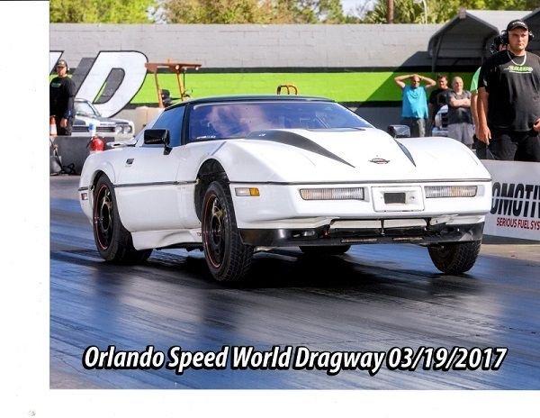

Ok, good runs. In my 1990 (with a 4l8OE trans) I have run the best of 11.54@120.xx with an average 60ft time of 1.68. my best 60ft was 1.60 on a cold day (Jan/Feb) at Orlando Speed World. After spending 6 months plus i went from 1.90 to a low of 1.60 tunning QA1 shocks ( the original factroy shocks were not helping). I'am only making 525hp @ crank and 418hp to the rear with the 4l8OE trans. Foot braking @ 2500 rpm and trans in 3rd gear shifts automatically at 6800 rpm. Front tires hooziers 275/17 LT are set @40lbs and M/T 315's are set at @ 17lbs .I know that I'am losing at lot of power thru the 4l8OE transmission. Most of my runs on average are 11.74 to 11.77 @ 118.xx.
I just replaced my old transmission controller (compushift 1) wth a new compushift sport controller. There is a lot to learn with this new controller
