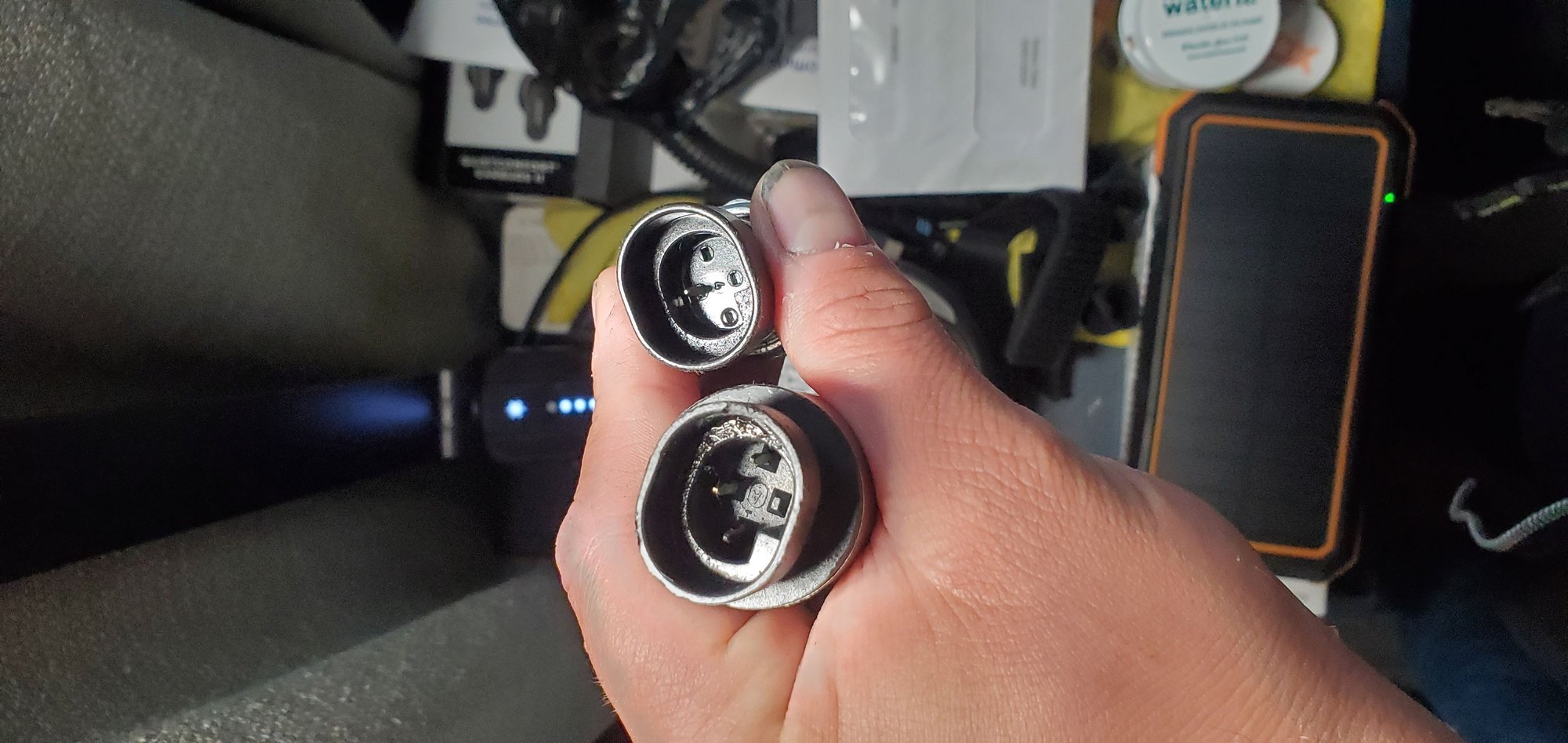

these are my switches

Put a fuel pressure gauge on it, start it up, let it idle until it starts to die, and see what the pressure gauge does.
