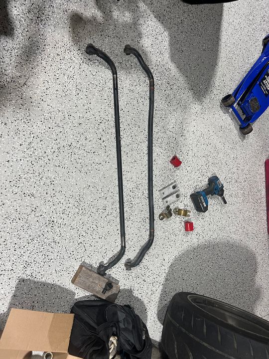

Default Hollow Sway Bars or Solid?
Hello Topspeed1:
Since lighter rotors may not be an option based on your lack of response to my previous post, I thought I would offer another suggestion that is more budget friendly since you are already at this stage in your build.
Obviously you have a VERY lightweight car so you likely don't need massive diameter solid sway bars which can be very heavy. I would like to propose running hollow sway bars in case this opportunity has been accidentally overlooked. Your bars do not appear to be very large however a photo without measurements does not always tell the whole story. My apologies if you have provided the measurements in a previous post that I missed, but I thought I would throw this out there just in case it was an overlooked opportunity to save some additional weight while offering a possible performance upgrade by switching from a small diameter solid set of bars to a larger set of hollow bars.

I agree with this. The hollow bar I have is a 26mm but I am looking into other options. The car isn’t going to need a huge sway bar. I already need to lower the spring rates on my coil overs. They were set up for a way heavier car. In regards to the carbon brakes cost is my issue at this point. I thought about the stock zr1 brakes. It appears the rotors weigh 13.5 lbs. which would be a savings over what I have

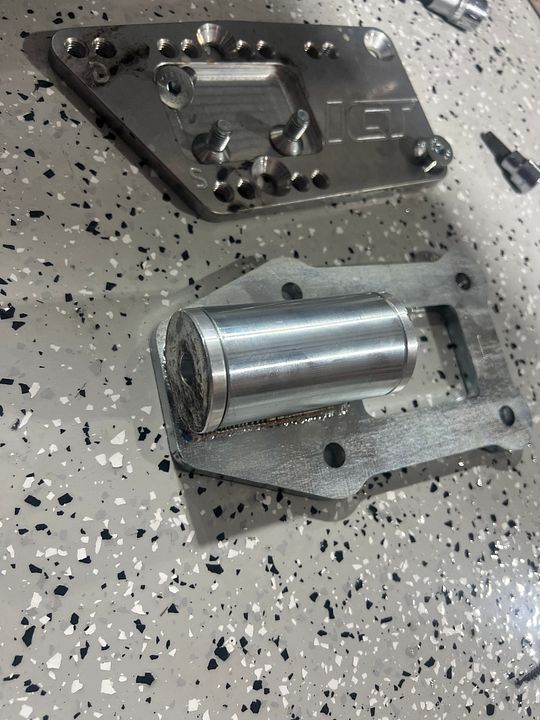

Another upgrade i did this week which unfortunately gained 1.5lbs was changing to solid motor mounts. in the process i moved the motor about 3/4in further rear .
