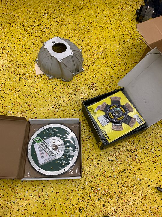

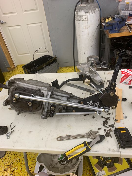

To save weight I went with a basic super t10, aluminum flywheel and Aluminum cbeam adapter.

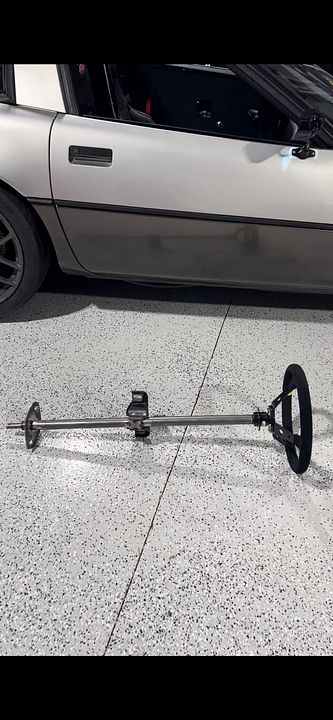

Motion steering Column

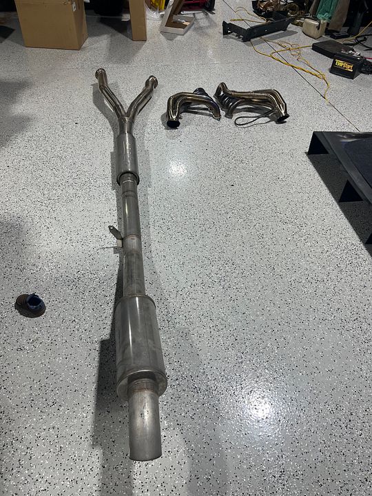

2 inch headers into dual 3 inch center exhaust. I am trying to figure that out so that I dont add weight over my current exhaust.

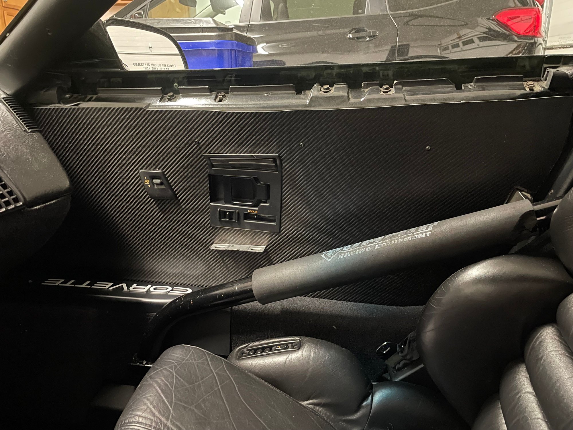

Nice! ... how did you do the fuel cell? Where did you get those door panels? I'm trying to do something light weight also with manual brakes, but not anywhere near 2500.

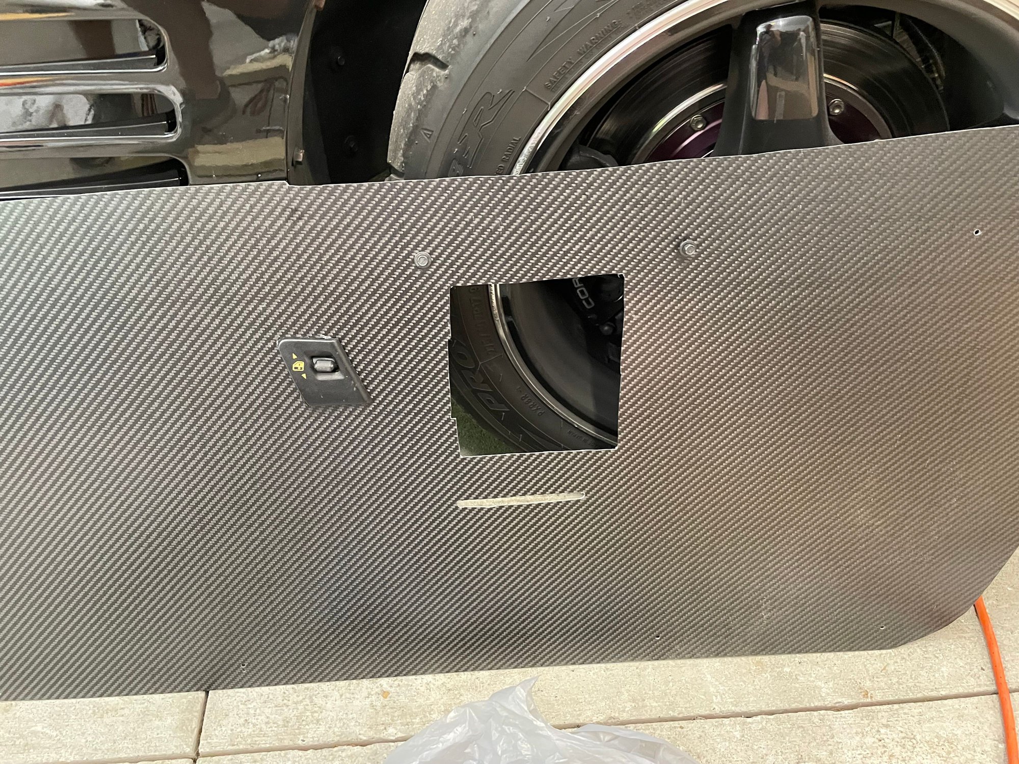

I built the fuel cell to fit in the stock location. It is similar in size to stock tank. I also built the door panels out of abs plastic I bought off eBay. I plan to replace them in the near future with carbon fiber. More for looks than weight. The abs is very light as is. The manual brakes are awesome. They feel better than the boosted ones did. I assume my large cam didn’t help the power brakes

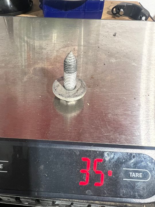

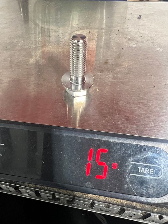

In case anyone wanted to know what titanium bolts weigh. this is a comparison of the m10 bolts that hold the steering column.
Its not much but when you multiply it by hundreds of bolts it adds up.

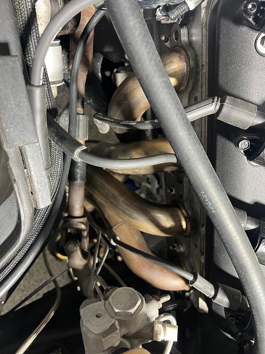

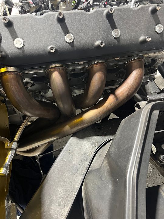

C6 2 inch headers fit on drivers side but the outer tube has to be rerouted on the passenger side

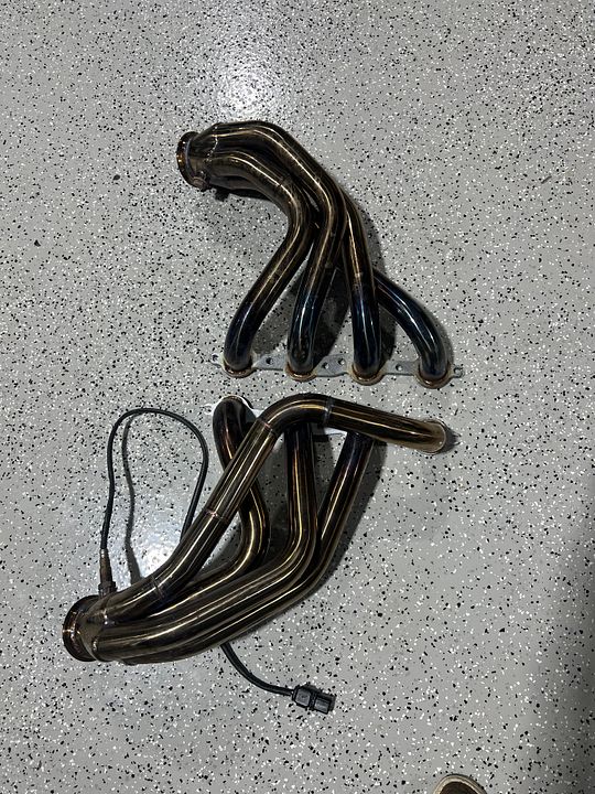

Here is a picture of my modified 1 3/4 ebay headers I modified to fit also my single 3.5 inch exhaust. Im going to sell the entire set if anyone is interested.

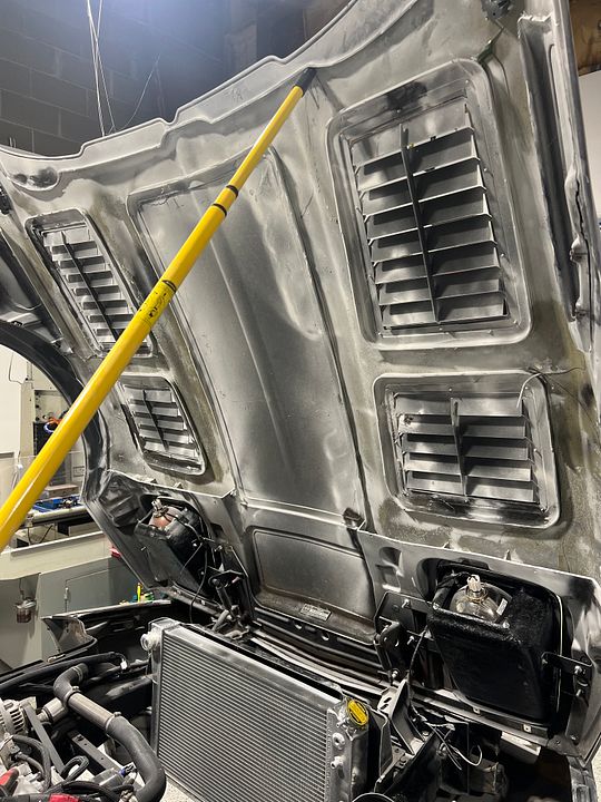

I started gutting the hood today. So far I have removed 20lbs. I am going to cut more out and clean it up soon.

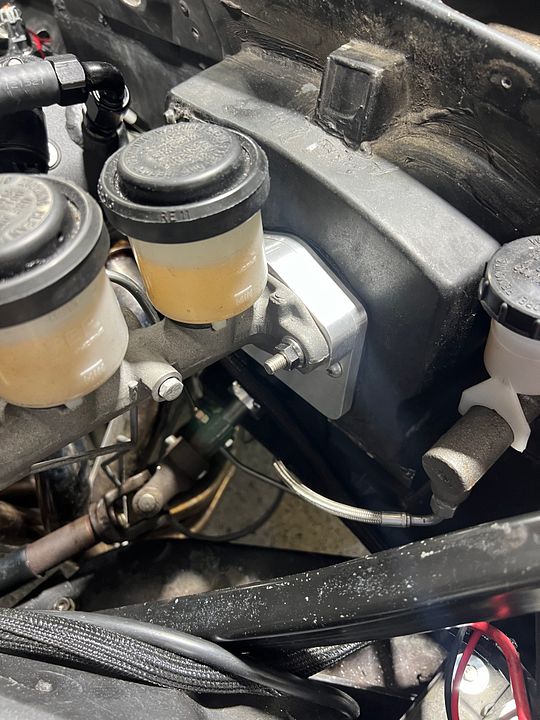

Whose manual brake kit did you use ?
https://www.manualbrakes.com/
he sells them for aftermarket master cylinder but I modified it to work with stock master

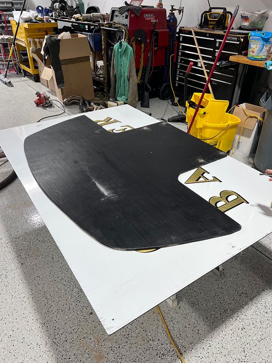

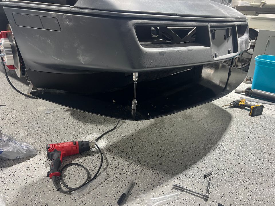

I started working on my frame mounted front splitter. I first built it out of 1/2 plywood and it weighed 20lbs. I then cut a new one out of alumilite sign material and it weighs about 10lbs.
Im gonna clean up the edges a little and paint it flat black
excellent build.
he prob made the door panels like I did.
saves 9 lbs per door
Would love to see closer how he trimmed the top edges - i havent done that with mine yet
Old Apr 23, 2024 | 07:36 PM
topspeed1's Avatar
topspeed1
Joined: Dec 2020
Posts: 111
Likes: 39

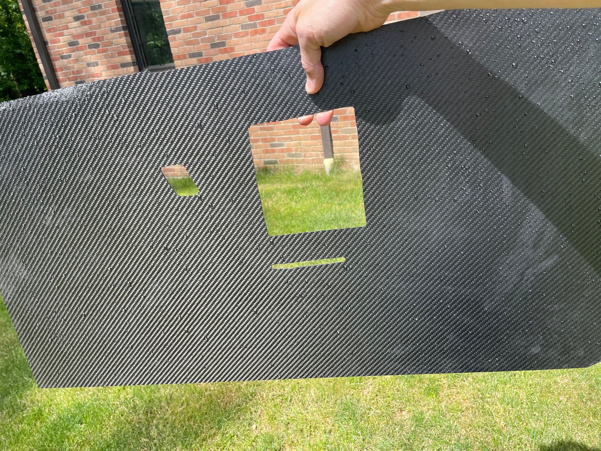

Originally Posted by dizwiz24
excellent build.
I’ll take some better pictures of the door panels tomorrow. I’m about to re make them better. Where did you get the carbon?

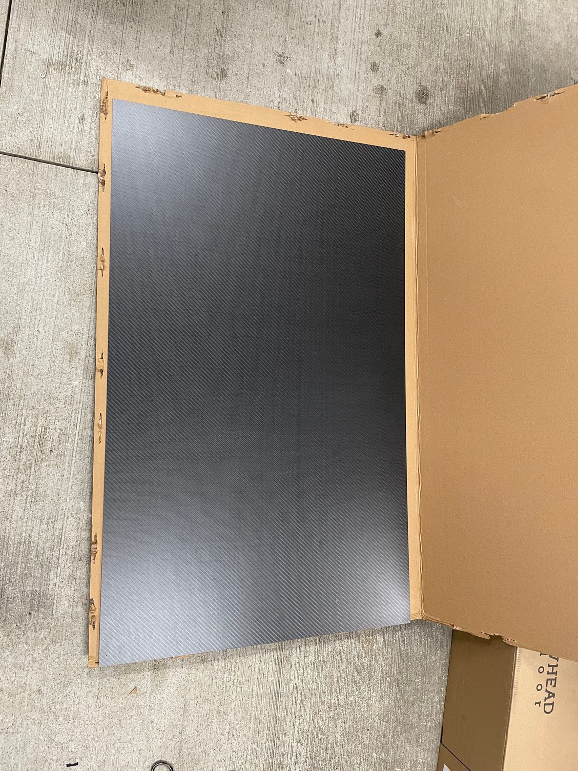

summit racing equipment last spring
ill see if i can dig up receipts showing the size and pn
SUM-590403
2 sheets needed at $171.99 a sheet
Note that one sheet wont be long enough to cover the entire door from fore to aft.
its missing a few inches at the front - since this area is covered when the door is closed; i didnt worry about it
good luck
let me know ideas on how to put a trim piece on top if you have any

Great job on shedding weight on that thing! Just one question about the brake master... wouldn't the newer 86-87 single reservoir master cylinder be slightly lighter?
