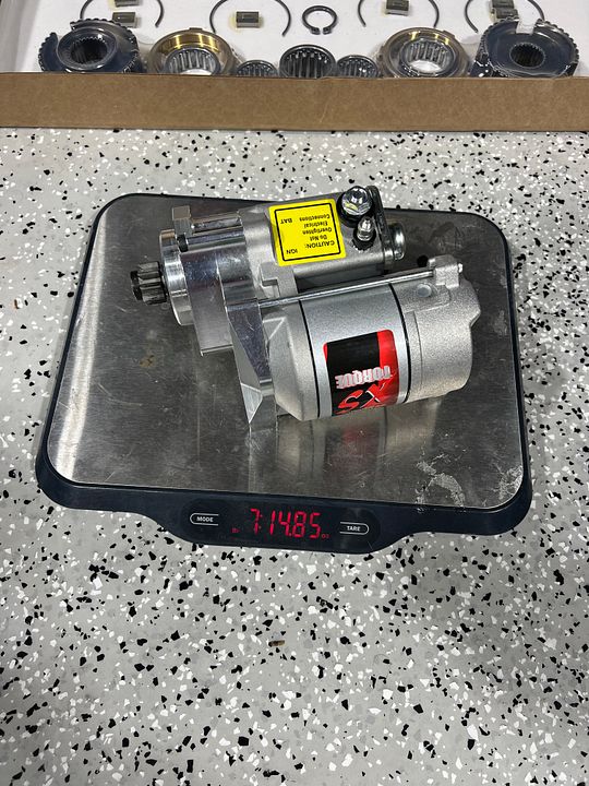

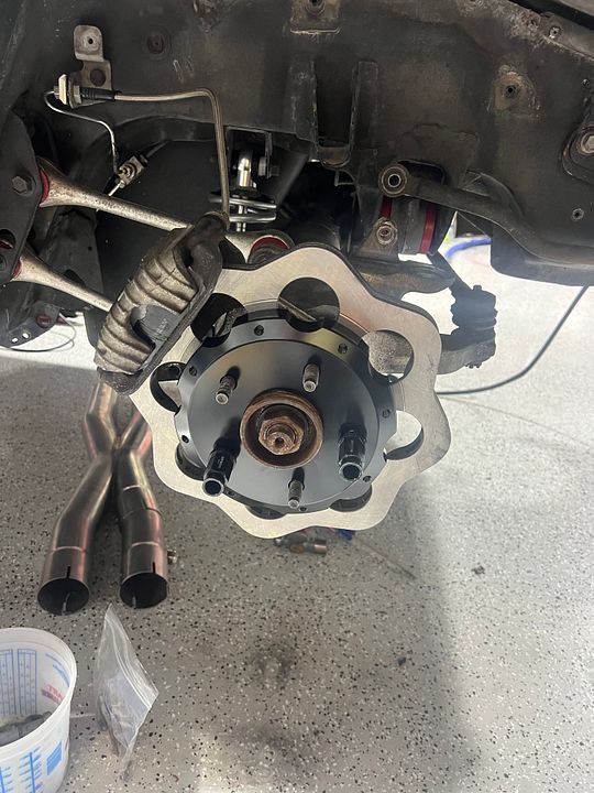

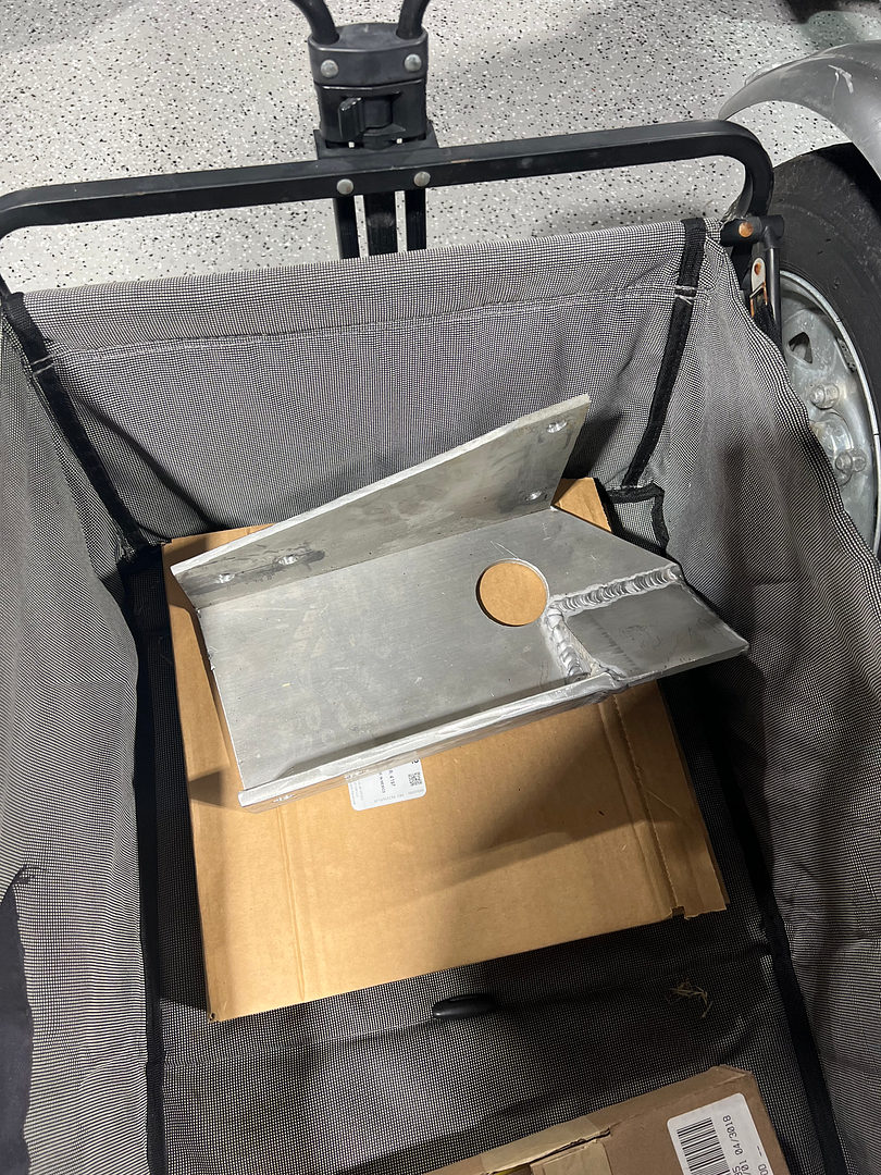

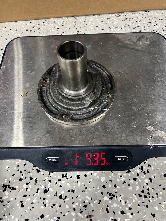

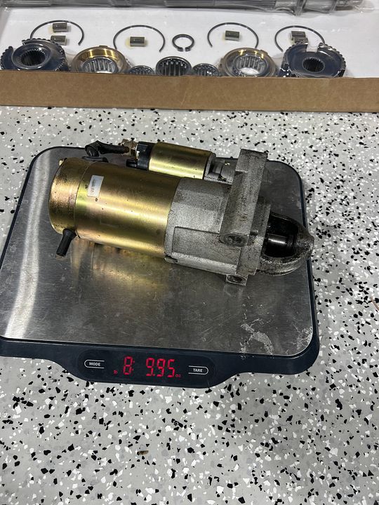

So i went a little crazy on weight loss this week. But lbs add up . ounces add up and grams add up.
Ive got some more stuff coming in later this week.

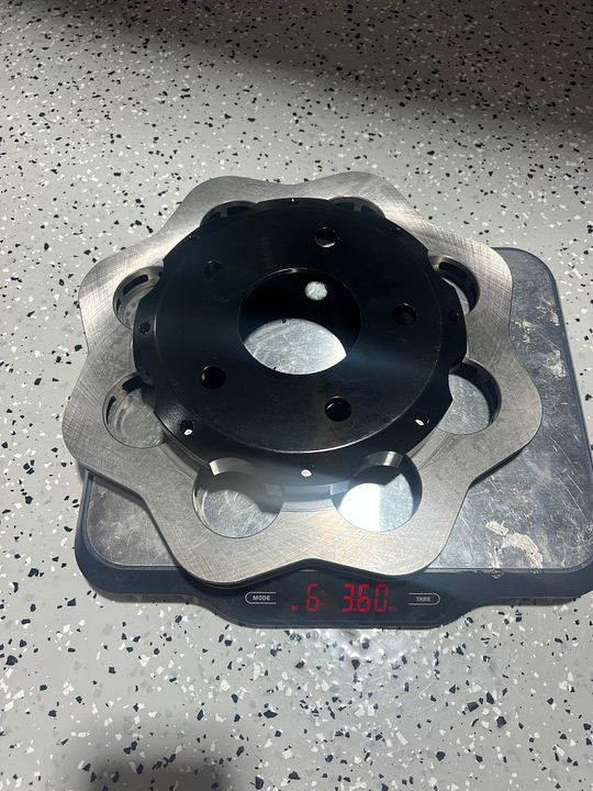

My new rear rotors. Probably not gonna run these at the track. but man they are light

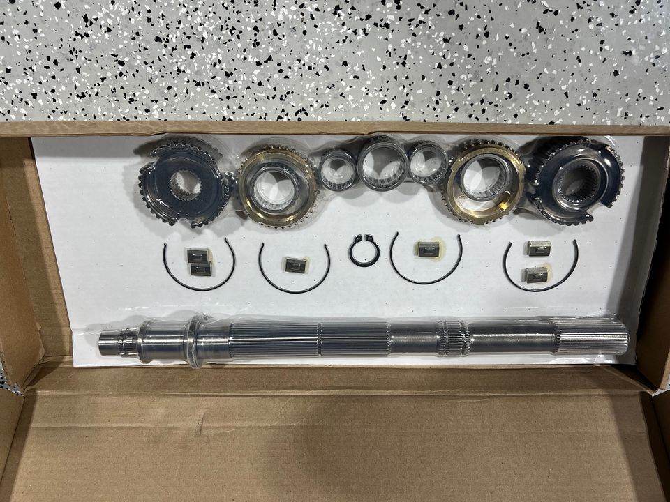

Gun Drilled Roller Bearing Main shaft for my transmission. 3lbs lighter plus the benefit of roller bearing over bushings.

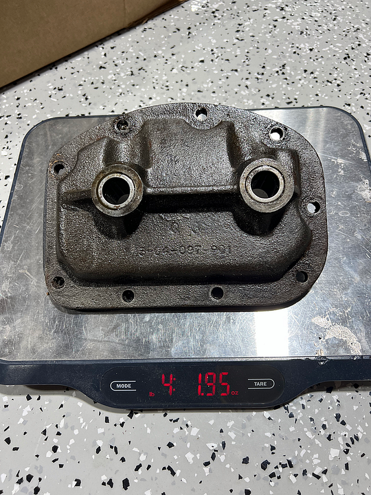

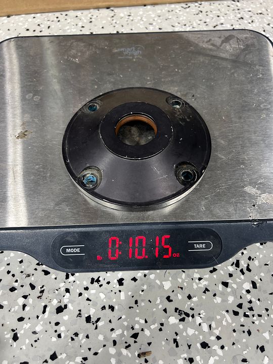

Aluminum front seal retainer for my trans from a nascar a little weight savings over the cast iron one.
My new Starter for the inew clutch and bellhousing set up . I was happy to see it was lighter too.

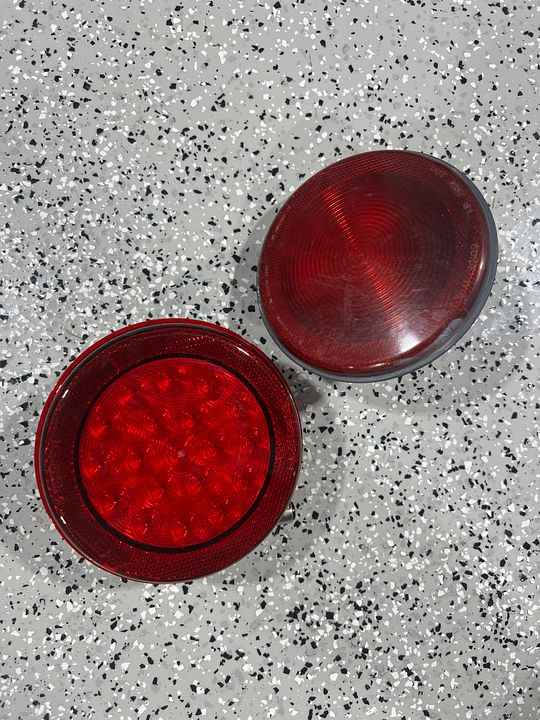

and finally LED tailights. Not really much weight savings but.

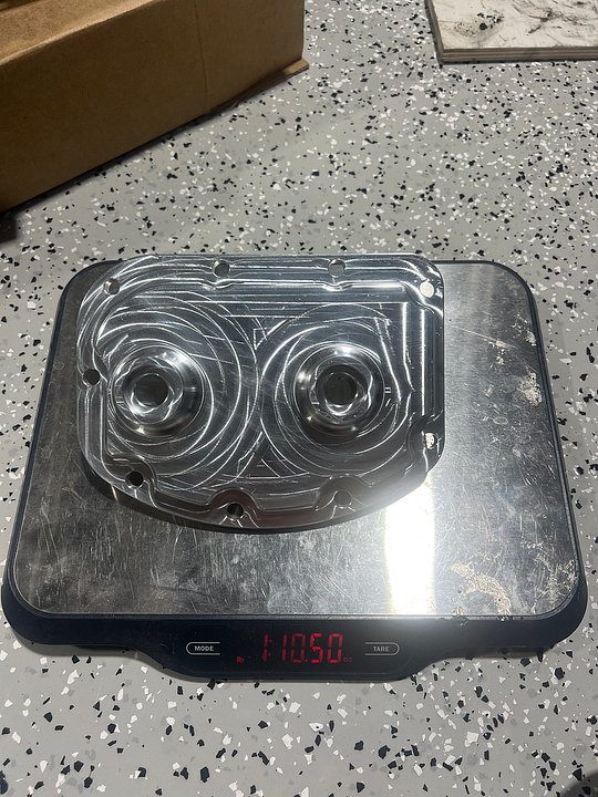

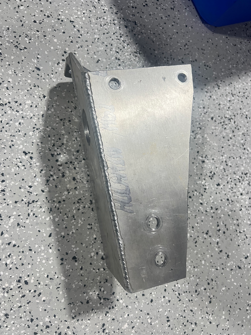

More billet goodness came in . No more cast iron side plate on transmission

Some Minor updates. I started rebuilding the transmission but I ran into a few hiccups with the new internals and had to order different parts than i originally had. I almost got it back together tonight. I also relocated the drain plug for more clearance and got a lightened and rem treated reverse gear.
the gundrilled mainshaft ended up being alot lighter than i thought. Plus the roller bearings should be alot better than the bushings.

Got the transmission rebuild finished. and it came in lighter than I expected. Almost 10lbs lost and alot of it rotational weight.

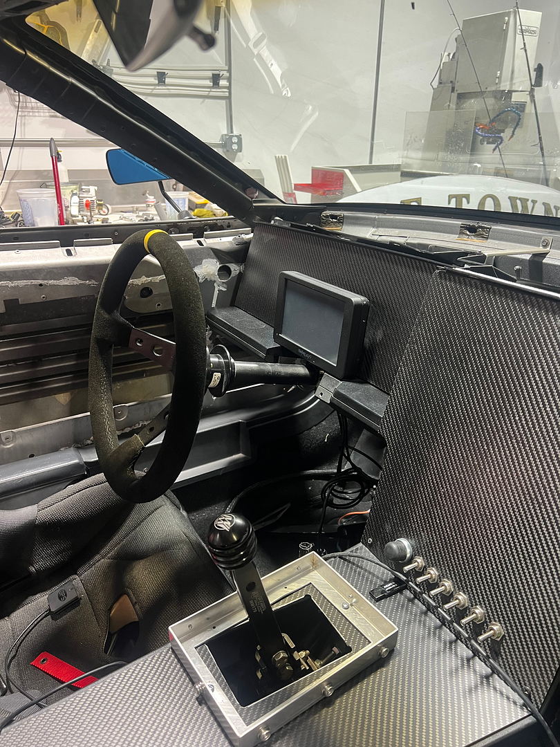

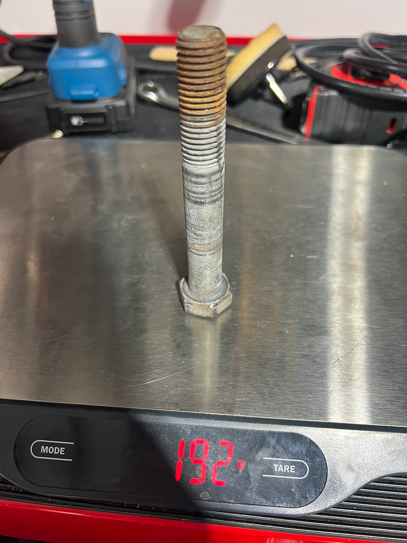

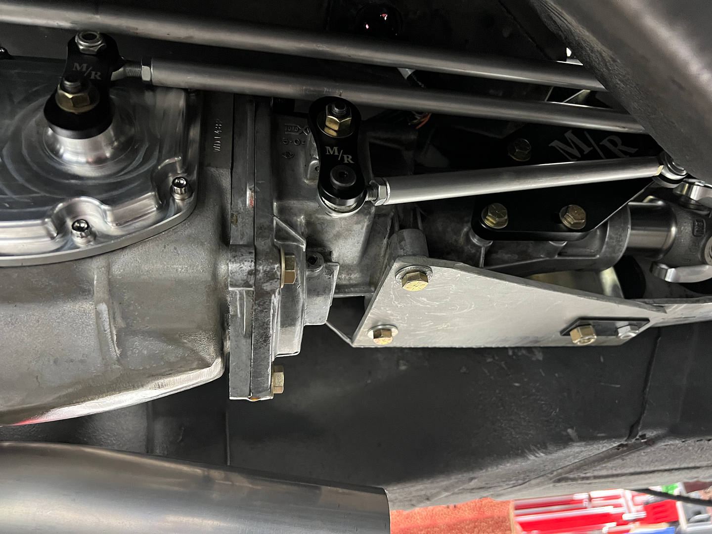

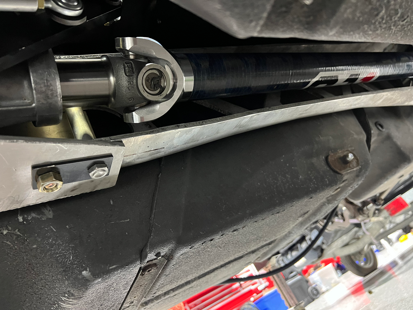

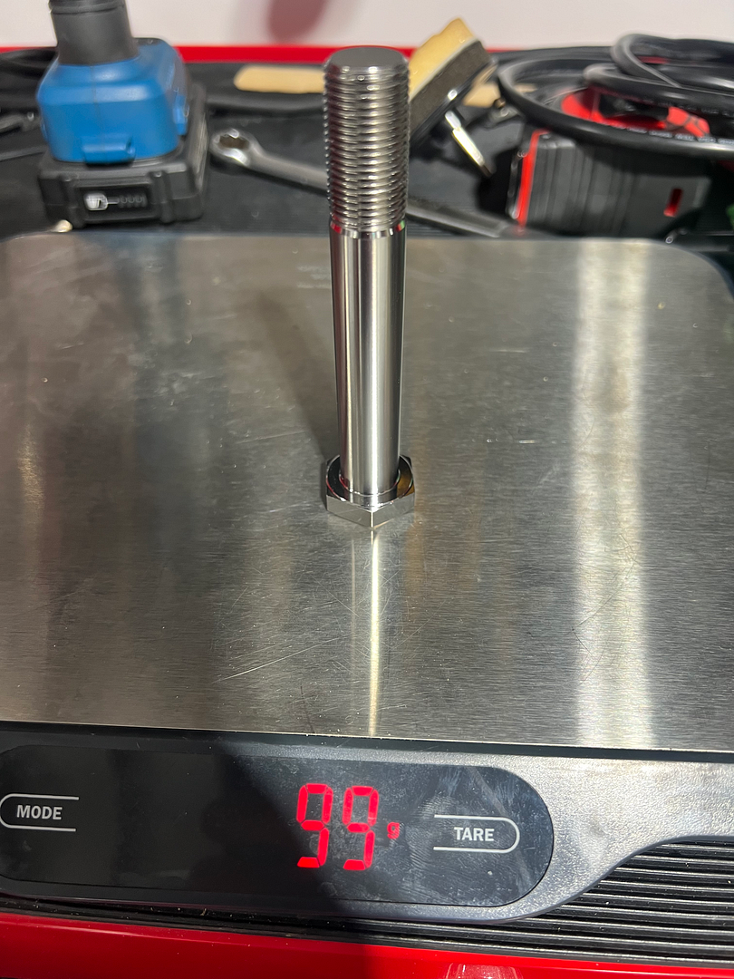

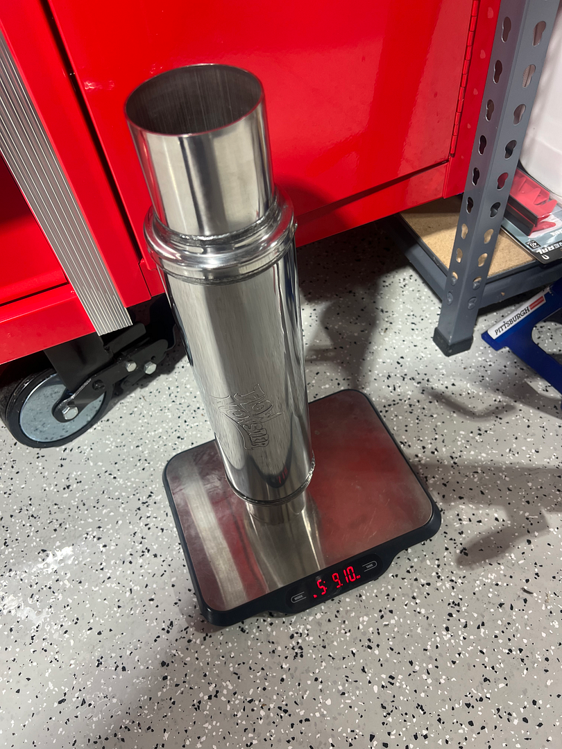

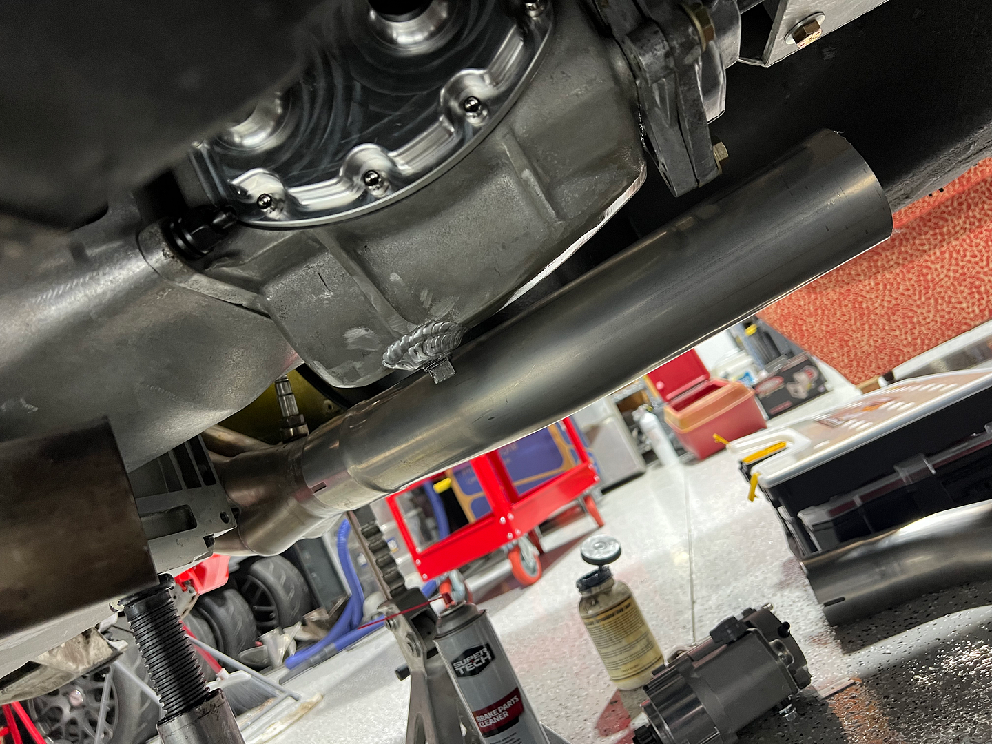

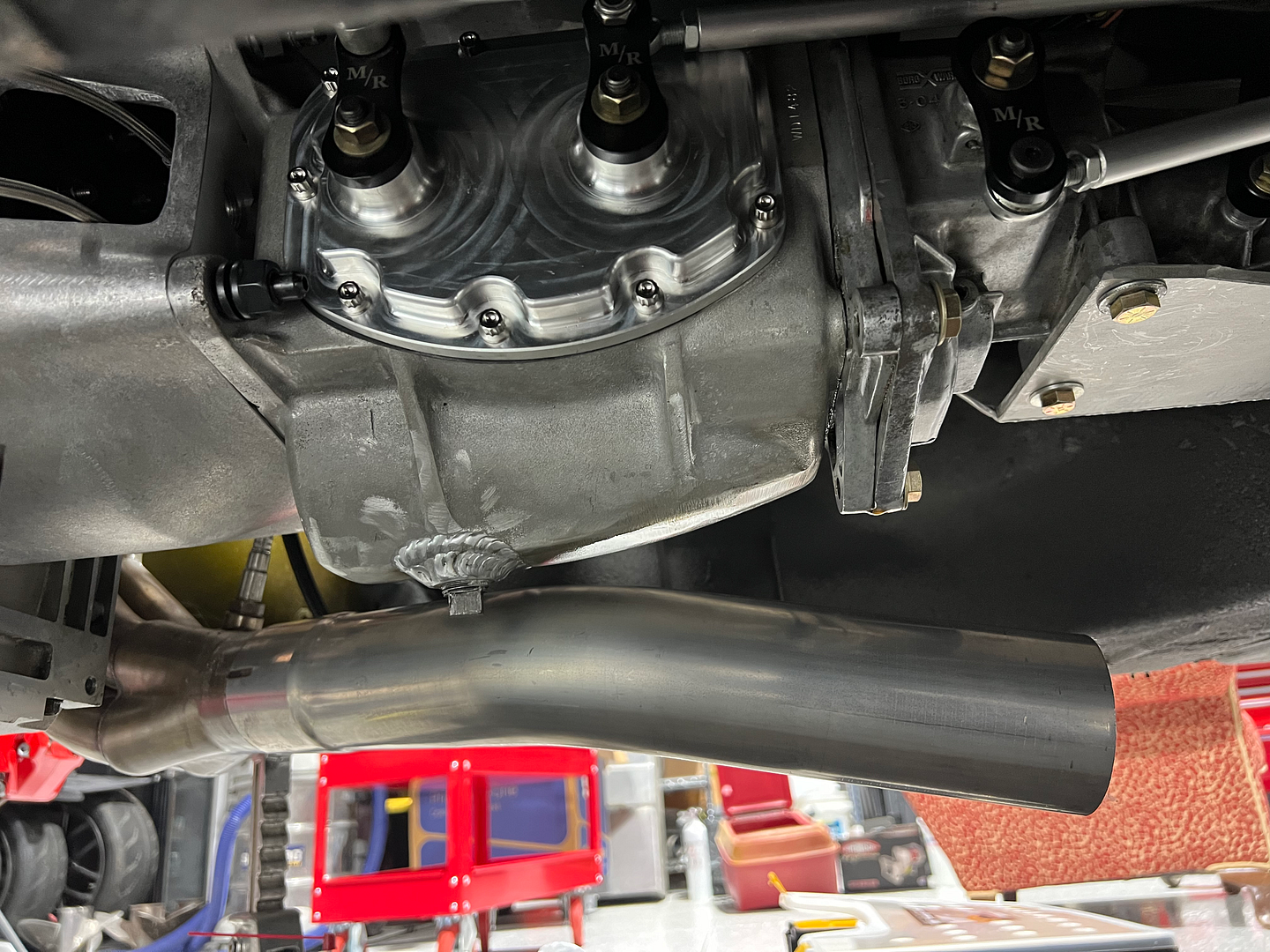

Havent had much time to work on the car lately but I do have the transmission in. Also got more titanium hardware for the suspension. Every gram counts. Also I think i have the exhaust figured out. Going dual 3 directly down the center with a single dual in dual out muffler at the rear center.

Been Working on a bunch of time consuming stuff, wiring, plumbing etc. Motor is running now. Had to change up the tune with everything i changed. Hopefully going to get it on the dyno really soon.

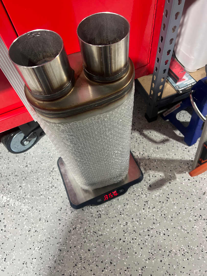

Also Trying to figure out the exhaust. I bought 3 mufflers. I currently have 2 bullet 3 inch mufflers mounted in the center before the diff. Sounds awesome but very loud. I have a dual in dual out muffler I planned on mounting behind the rear axle but I cant decide.

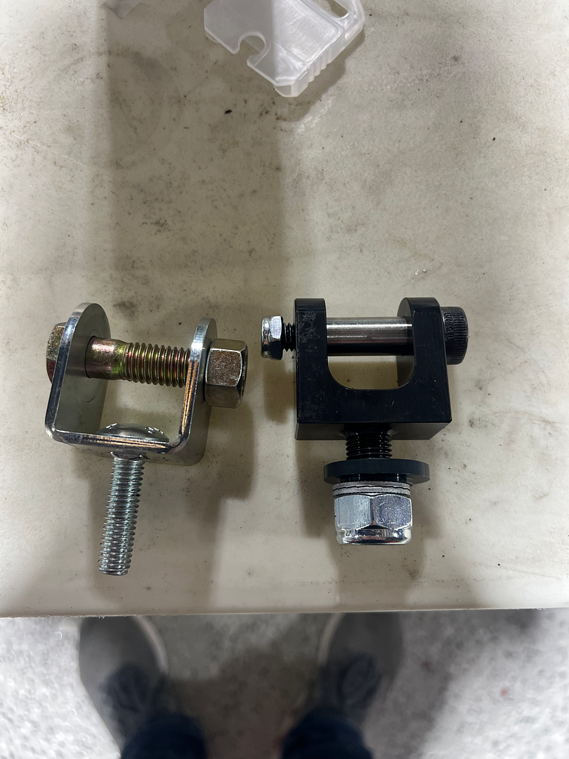

After hours of fighting with the upper control arm prothane bushings I ordered a set of Del-a-lum bushings today.

Got the bushings and they came in wrong. All 4 are the same size. Contacted them and the correct ones are on back order. So back to the drawing board.

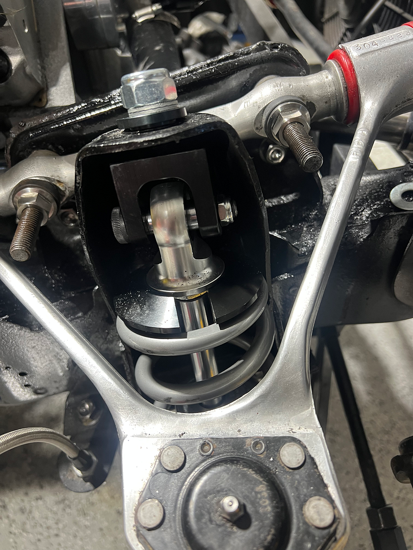

Also replaced my upper coilover mounts with billet ones from VannSteel
