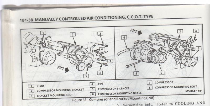

Make sure you're not missing any additional braces too. These can go from the component to the intake or exhaust manifold. #6 in the picture below.
