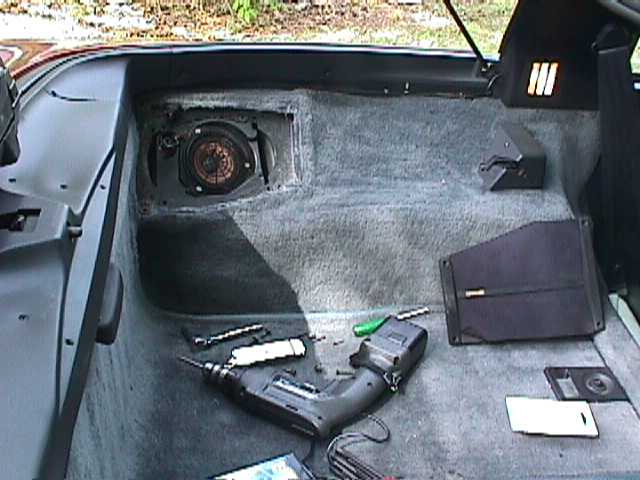

Has the shop replaced the original Bose with a "normal" stereo before? As I understand, all the speaker wires need replaced. You might also ask them to be careful with all the 30+ year old brittle plastic in a C4.

If you have the big stereo option with BOSE active speakers you have to run new speaker wires from the head unit.

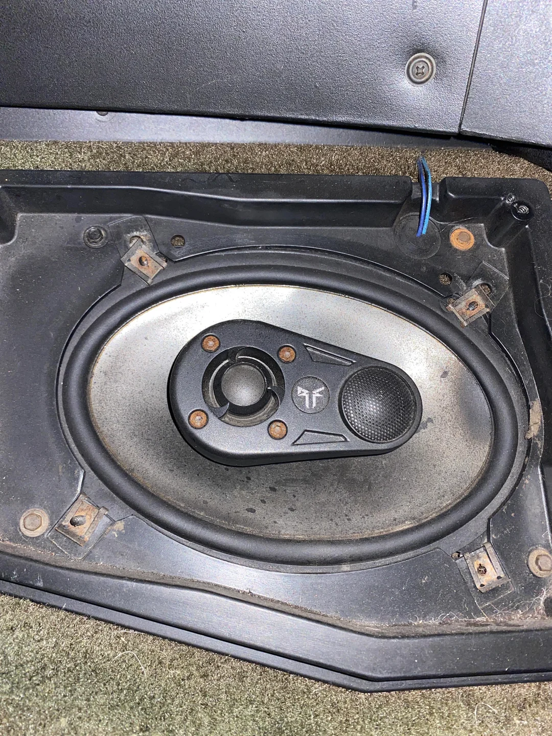

Does anyone know the size for the rear speakers? I thought i read somewhere that it was 6x9.

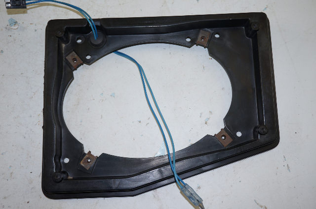

Rear passive speakers are 6x9, active speakers are smaller.
