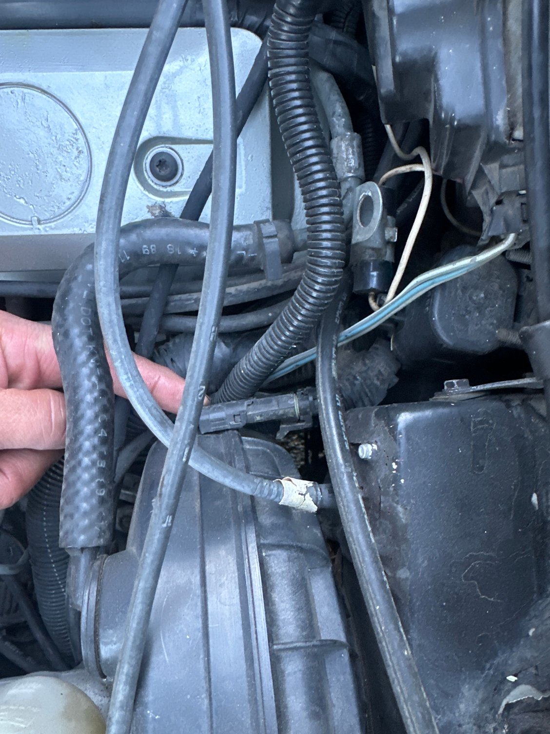

Originally Posted by VikingTrad3r
good idea on unplugging tps. u r correct. wot on crank is flood clear mode. worth a shot.
try disconnecting the esc electronic spark control single plug connector by the brake master.
here is a pic of it.
disconnect this. then start try to start it. it should throw a code. also if you shor a+b on the aldl, that triggers the ecm to turn on the fan. So if that doesn’t happen, something is up
Did u disconnect this and try to start it to see if it throws the code?
