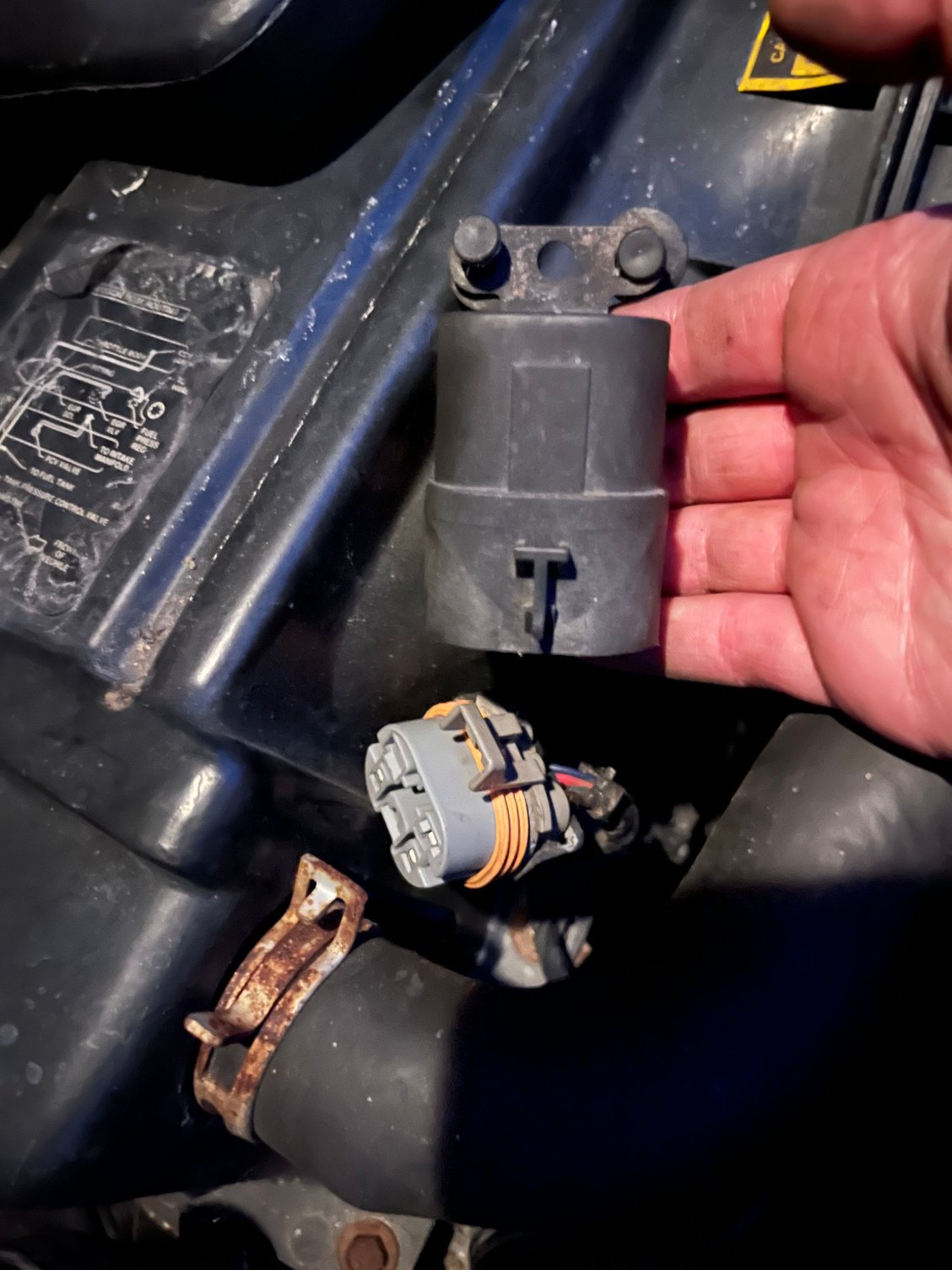

Also this relay on the fan shroud gets HOT and visibly dims all the lights when plugged in. Is this the cooling fan relay? Fan doesn't come on.

Im out autocrossing my 89 6spd today. Will look to see that relay in a few minutes. Main Fan comes on around 228F/108C
