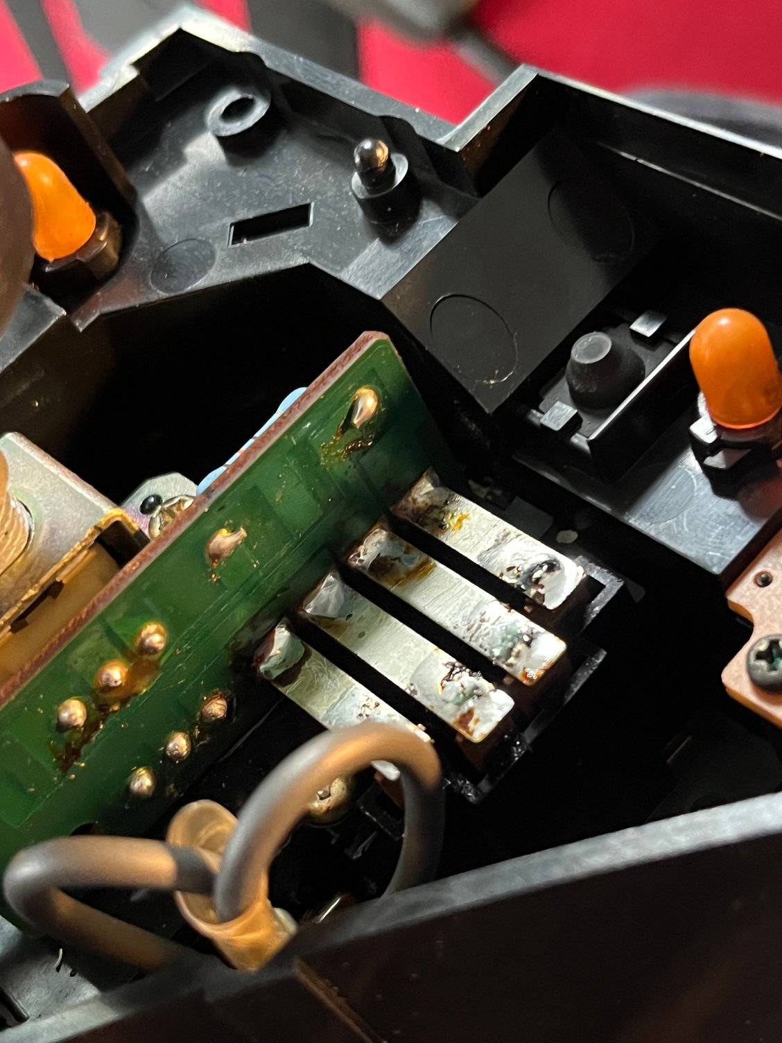

I figured it out. I took apart the switch and found that the potentiometer was working just fine, but I could never get a reading on the pins for the connector. I reflowed all the solder joints on the board and it works perfectly now!
The problematic solder joints are the ones between the shiny metal tabs and the circuit board.

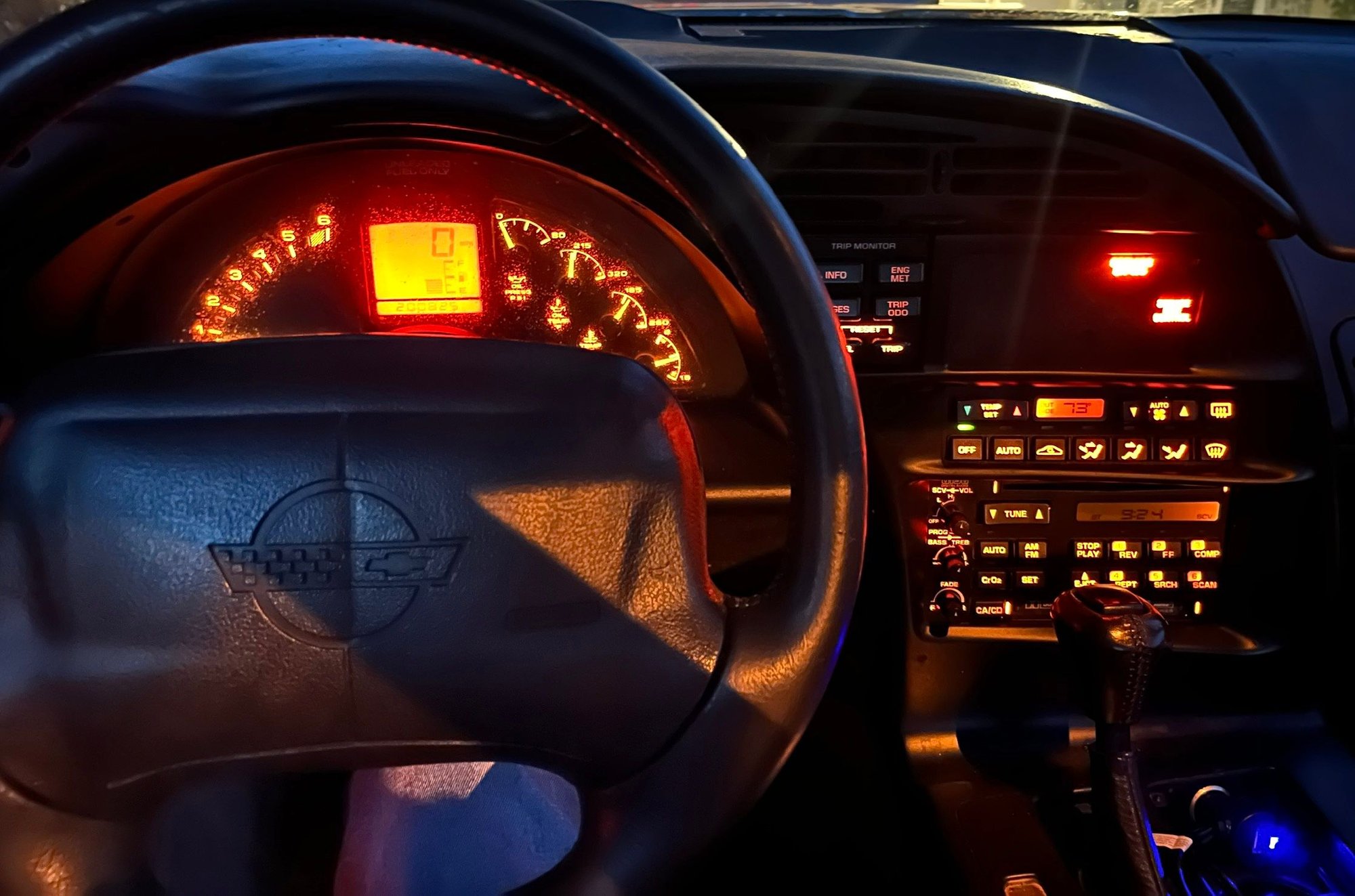

That's more like it

That is very fine work. Dan
