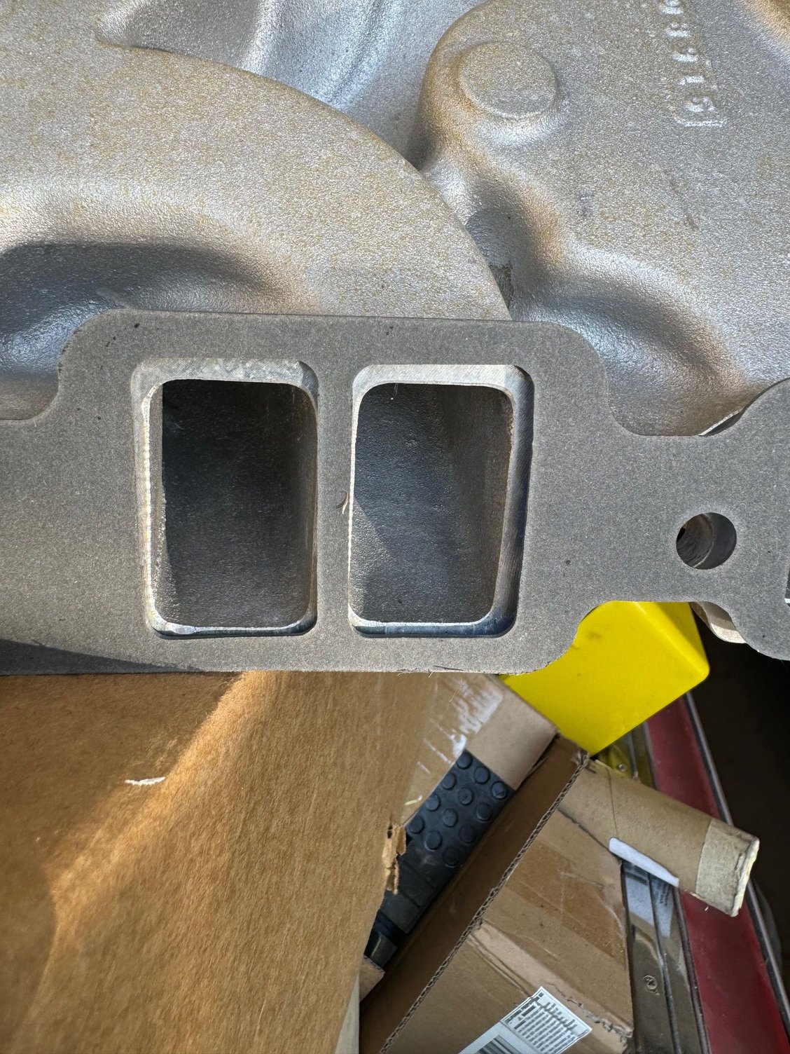

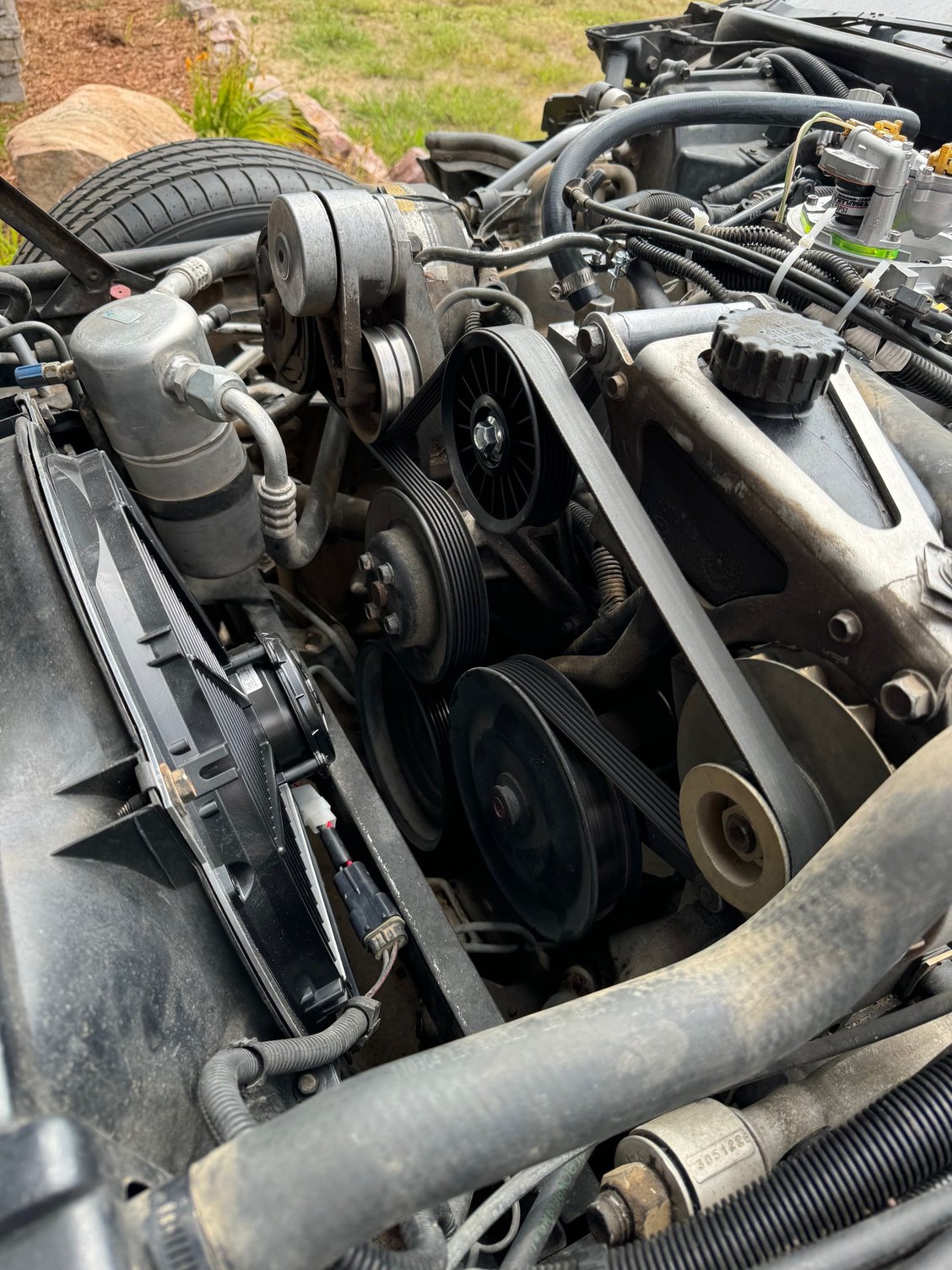

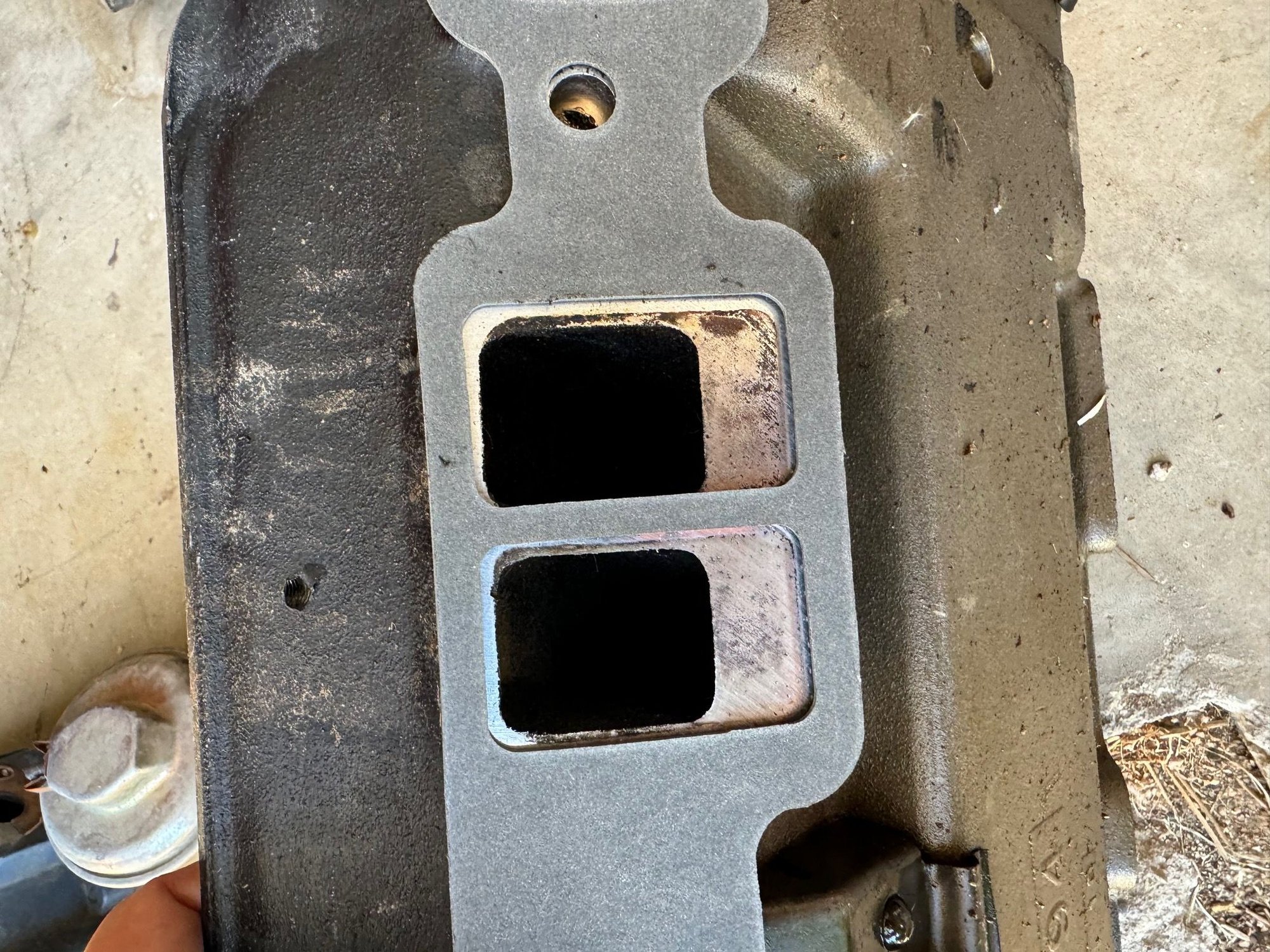

Just did the Cross Fire conversion to TBI. Used a unit from SPR Performance. The car is insane fast compared to what it was. The TBI was a little pricey, it came in at $650ish. I went this option because it is plug and play. If you are looking to do an aggressive camshaft later than you will have to go with a standalone EFI system like sniper. If you go with a cam like a Edelbrock performer plus you should not have any problems. I also did the smog delete specifically for the 84, it comes with a nice pulley.
As for changing cams, heads and doing a bunch of other stuff to the engine it really is not worth it. Once you start adding up the cost of everything it is cheaper to buy the entry level 350 from Blueprint. I know because I just bought summit heads, rocker arms, and cam for my 84. Not to mention a new TKX from silver sport. Long story short by the time you spend 2k on your top end (hydraulic flat tappet cam) and a bunch of bolt-on goodies you are halfway to the cost of a new 350 crate engine. Less than that if you sell your old engine on CL for $500. The benefit with a Blueprint engine is that comes with a roller cam and one-piece rear main seal.
As for the CF engine it is a fine platform to build off of. The induction system is very restrictive, I have provided pics. Don't bother with porting either it's a waste of time unless you are bored and just want to find something to do. Several good videos on CF porting on YouTube with the end result being everyone ditching the intake later anyway. I put the Weiand X-Celerator intake on for hood clearance. It is the worst intake you can put on a small block, and I still had more power "everywhere" in the power band. I thought I was going to lose power down low, not at all. I picked the open plenum design for better fuel atomization, and I think the spacer/adapter plate provided by SPR and the injector spacer plate helped with increasing the plenum volume.
The best bang for the buck is to change the intake and put in 1.6 roller rockers. You will pick up 50hp and some torque (this is not normal; the CF intake is really that bad). All this can be done for 600-800 dollars depending on the cost of your TBI. I just bought headers had them coated and bought true duals with Corsa cat back. The exhaust with jet hot coated headers came in at $2200. Considering I will get 30hp if I am lucky the bang for buck is not there. Summit cylinder heads is another great bang for the buck addition great Motor Trend article on them. 50hp for about $1200 bucks.
No tuning required with TBI upgrade, and it will run better than the CF setup. This is most likely the reason GM ditched even the TPI setup and went with TBI units later. I had a 92 Camaro 305 H.O with the TBI and it laid rubber everywhere. I will say this the long runners on the TPI do produce a ton of torque down low, it just runs out of air at about 4500rpm.
OLD Cross-Fire Intake ports
New Intake ports X-Cellarator Intake 30% increase in area
New bored TBI 675cfm
Smog delete pulley direct bolt in

stock crossfire intake flows about 150cfm, a maxed out ported stock crossfire intake flows about 230cfm (without getting into water jacket), X-Cellarator Intake manifold flows 250cfm and a renegade should flow at least 260 cfm. renegade isn't available at this time. X-Cellarator flows 100cfm more that stock crossfire. X-Cellarator would be good with some high flowing 195cc heads. stock crossfire intake is very restrictive. the stock exhaust manifold is also restrictive.
