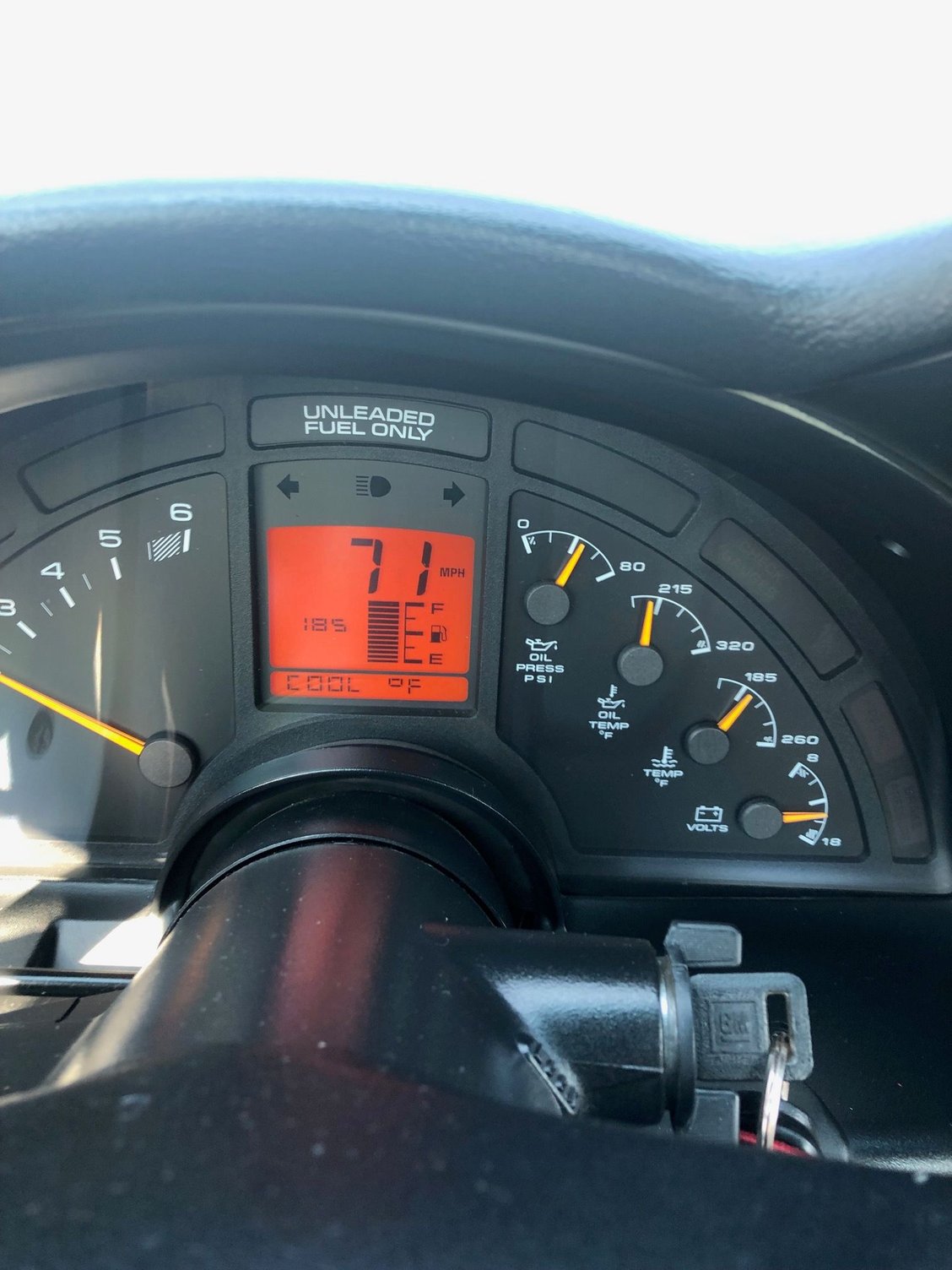

First you have to flush out the block with this system. Clean the AC condenser as noted. I blew high pressure air from the backside (radiator removed) and found a half cup of small rocks caught in the fins. This condenser has to be very clean. I then bought a Dewitts single row radiator. I use a 180 degree "fail safe thermostat". I use Prestone green with a bottle of "water wetter". I seldom get over 200 even in stop and go traffic. I run the interstate at 188. I did get up to 192 running at 70 MPH when it was 95 degrees out. Here in a normal running temp picture. Dan
