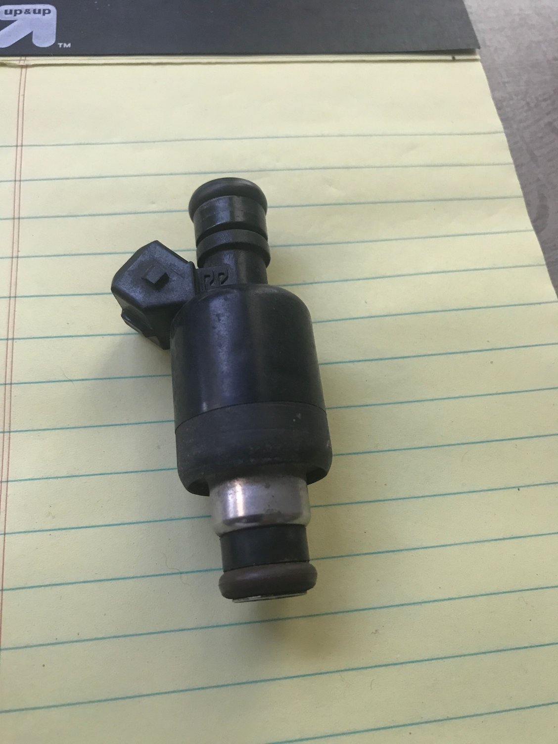

Was cleaning out my garage and ran across these, they are C-4 Lt-1, are they all the same. I was thinking about having mine off my 93 LT-1 cleaned if these would work send these off have cleaned less down time for my 93??? Thanks Anybody know a good Injector cleaning service?? If these will work on my 93 Lt-1 ..Thanks

Look down from the top for the part number, 17087325 is the 1992 and 1993. All others are different.

Thanks, I guess I needed to clean the dust off before looking for the part number, fount it, not 92 or 93 .7095004

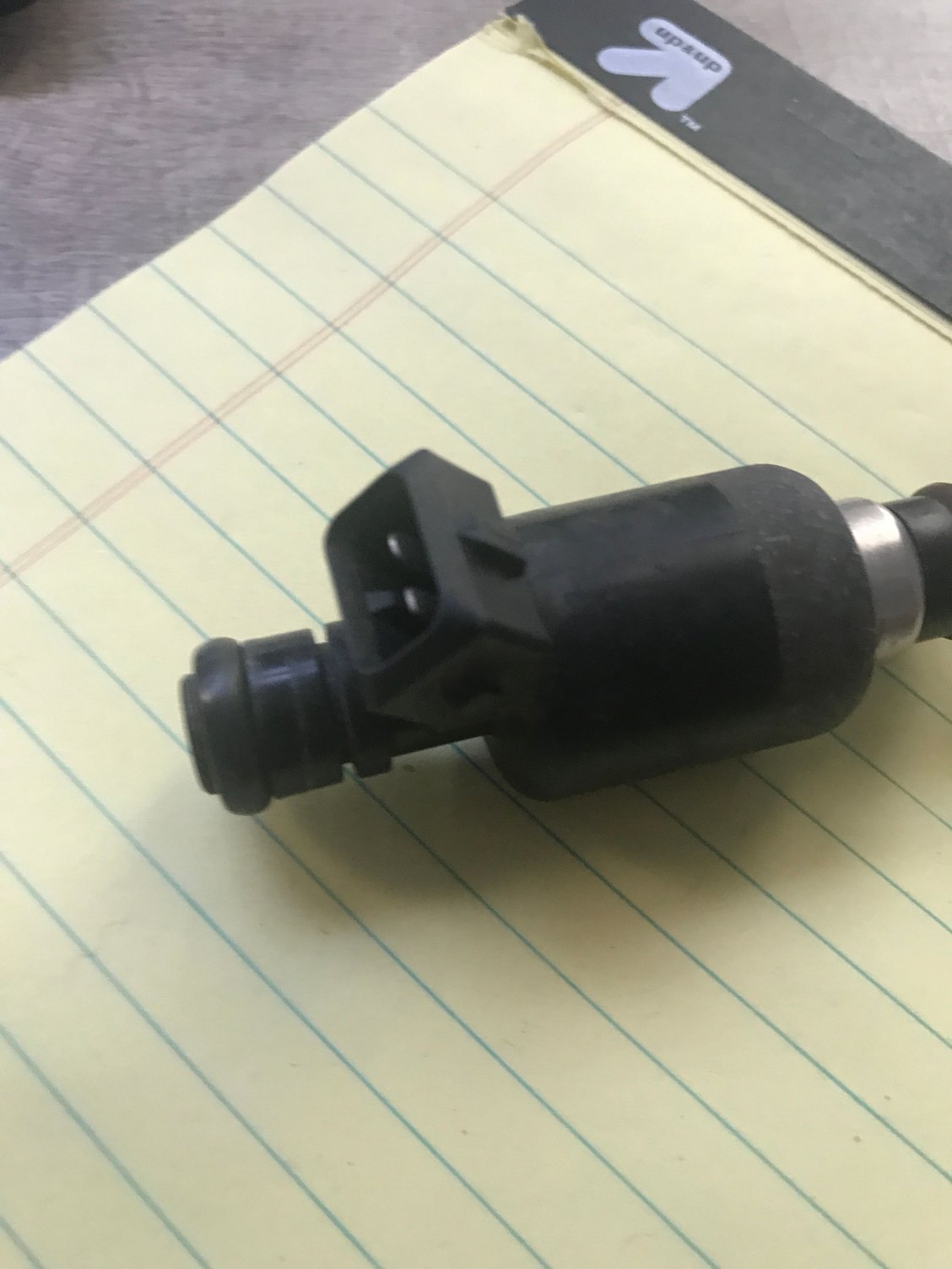

Those 17095004 are from a 1995 and are 24 lb. They will work but require a tune
