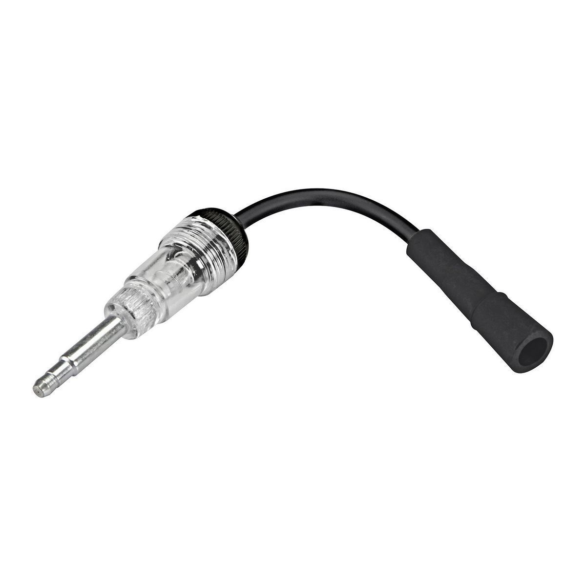

The first thing you need to do is verify you have spark to all cylinders and verify that all 8 injectors are spraying. I think the easiest way to do that is to spend $5 on this at Harbor Freight
Just pull the fuel pump relay or pull the fuel pump fuse. Then try each cylinder and make sure you have good spark on all 8. Assuming you have good spark then pull the fuel rail off. Leave all 8 injectors on the rail with the fuel line and harness hooked up. Hold the rail up and away from the engine the best you can and crank the engine (after you put the fuel pump relay or fuse back in). Verify all 8 injectors are spraying.
