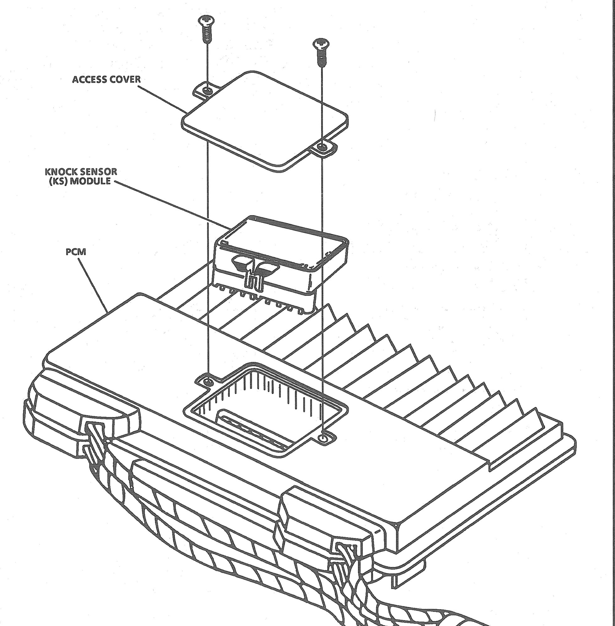

Check your PCM and see if the Knock Module is actually there. I would think if missing it would be a 'C' for current but maybe not. I've no LT1 experience.
Do you have the FSM(Factory/Field Service Manual)?

I'd see if there's a label on the PCM, make note of that number. Remove the cover, look for the Knock Module actually being there and get the number off of it if you can. I believe it should be visible. Your friend that works at the dealer has availability of their scanners? If he does and dependent upon what their using he should be able to scan and verify things. A '95 requires various adapters/connections to use most dealer scanners these days. What brand did he use that gave you the coolant sensor codes?

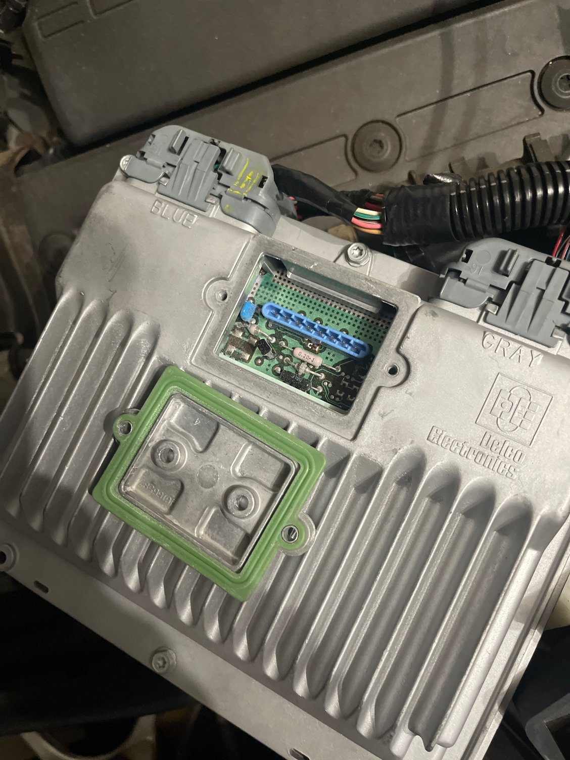

Update: Checked the ECM that is on the car. Flipped it over and removed metal plate to discover that the knock sensor module is missing. I am not sure if prior owner replaced the ECM and wasn’t aware that you have to have a knock sensor module or what. Any ideas on how to match a knock sensor module to the ECM on this car? I am assuming it goes by one of the characters in the VIN or something?

They're available but are ridiculously priced. I would post a WTB here on the forum and assume someone will give you a reasonable buy on one.
Maybe shop 'local' JY for maybe one.
*** You bought from a dealer? Did they do the PCM and not know any better? Check with them, maybe the core is still around?
*** GM SPO Part numbering hints it needs to be '94 or '95 and 'Vette only. I don't know that to be a fact. Maybe someone does. GM# when discontinued was 16177690. It might actually have that part number on it.
