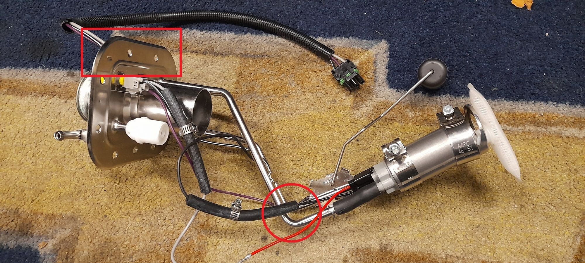

I admit I spaced out and broke my main rule of checking things before installing them. This was a particular stupid one as the sending unit test is a stupid simple 2 second test of the purple wire to the sender frame that was sitting on the bench right in front of me. I had appx 1/5th tank and after install my gauge cluster shows reserve on no bars. My old rusty OEM sender was accurate and ohms out between 7.6 3.0 to 104 ohms and the new LILAND GLOBAL SUCO10 is currently sitting at 4.1 ohms. I am assuming it isn't malfunctioning, I think I have seen others with accuracy problems after installing this new sender. Does anyone have experience with this sender and fuel level accuracy.

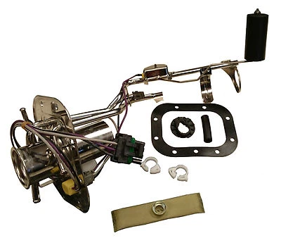

As we talked about on PM this is the one I bought. It sure looks a lot like your brand and model. Dan

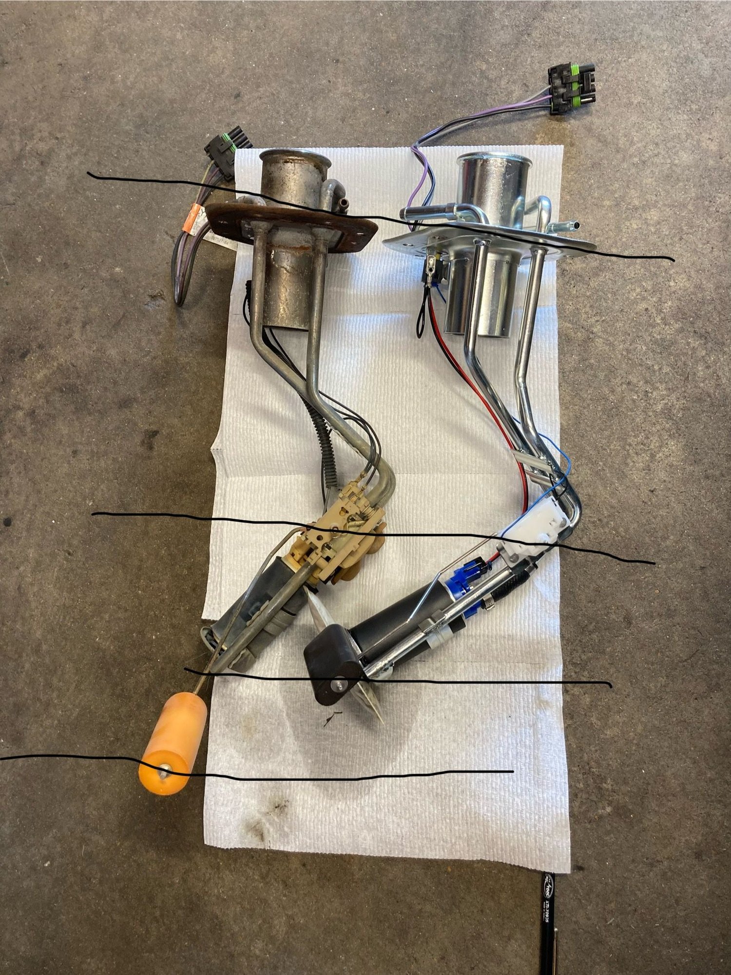

This is the problem I had with the assembly I got from RockAuto. As you can see the reach of the float arm wasn’t equal to the original. After pulling it and bending it a few times I was able to get it close.
I don't know this for fact but I have always thought that the units sold for C4 use are really designed for another car but are sold because they "kinda" work. Why would someone build a sender for C4's and screw up the float and arm so bad. Dan

When I pull mine I will photograph it again. This was just a random shot for installation purposes. The length of the new float arm may be skewed by the angle. I tried installing a pulsator back on it but the fuel pump was loosy goosy and the distance the pulsator had to span made it feel loose as well. Also note this Liland global does not have a support bracket that hugs the fuel pump.

Oh dear. Additional resistors nor a signal modifier are going to fix that.
Along with straightening those minor bends in the rod, to gain some extra length(depth), you could also take that last 90-degree bend at the float itself away. Either way, it's a guessing game to get it close(r) to right.

One thing to note here, If you look at my original sender and you look at gtFOOTw's original sender you can see that his original float arm has been manipulated. It has been straightened out. It is probably longer than it should be. Also, I believe, these need to go down more than they need to get longer as that part of the sending unit is at an angle inside the tank. The arm is pointing as much forward as down. And to add to that, when mounted on my 87, it is tilted upward an additional appx 20° angle.

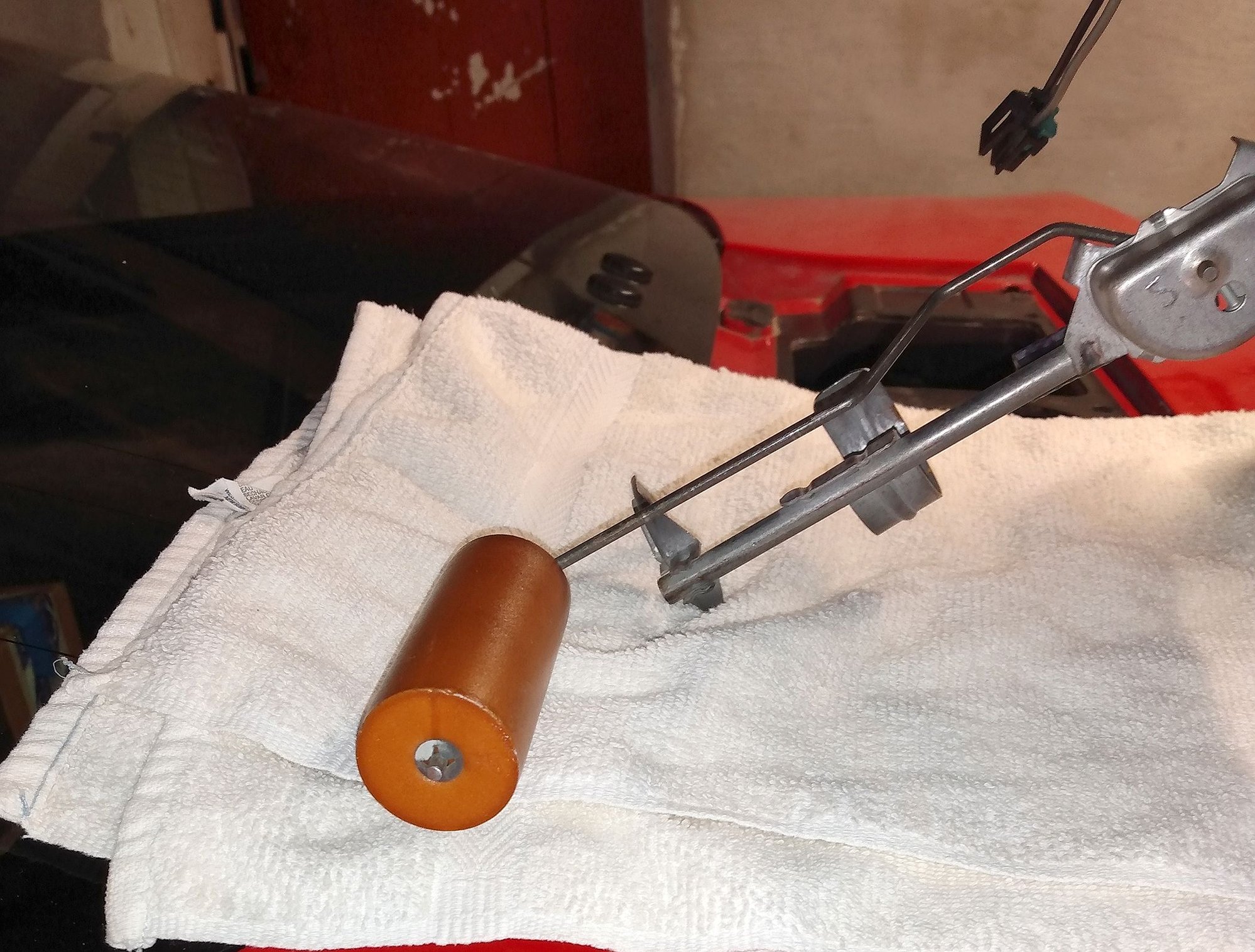

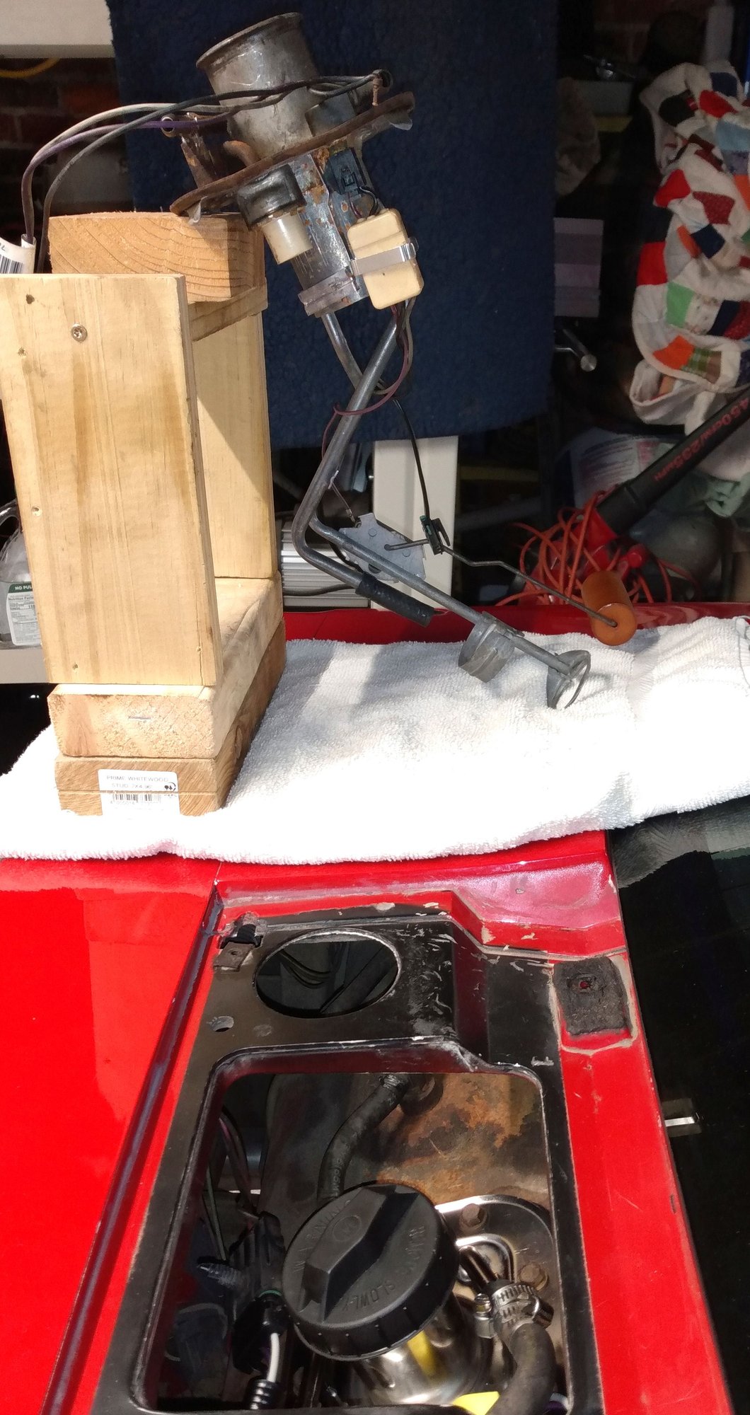

This may be a questionable comparison but by eyeball and measurement the original propped up on the spoiler (?) looks to be at the same angle as the sender in the tank. The float (first & second pic) are not touching the cloth and are resting on the stop.
