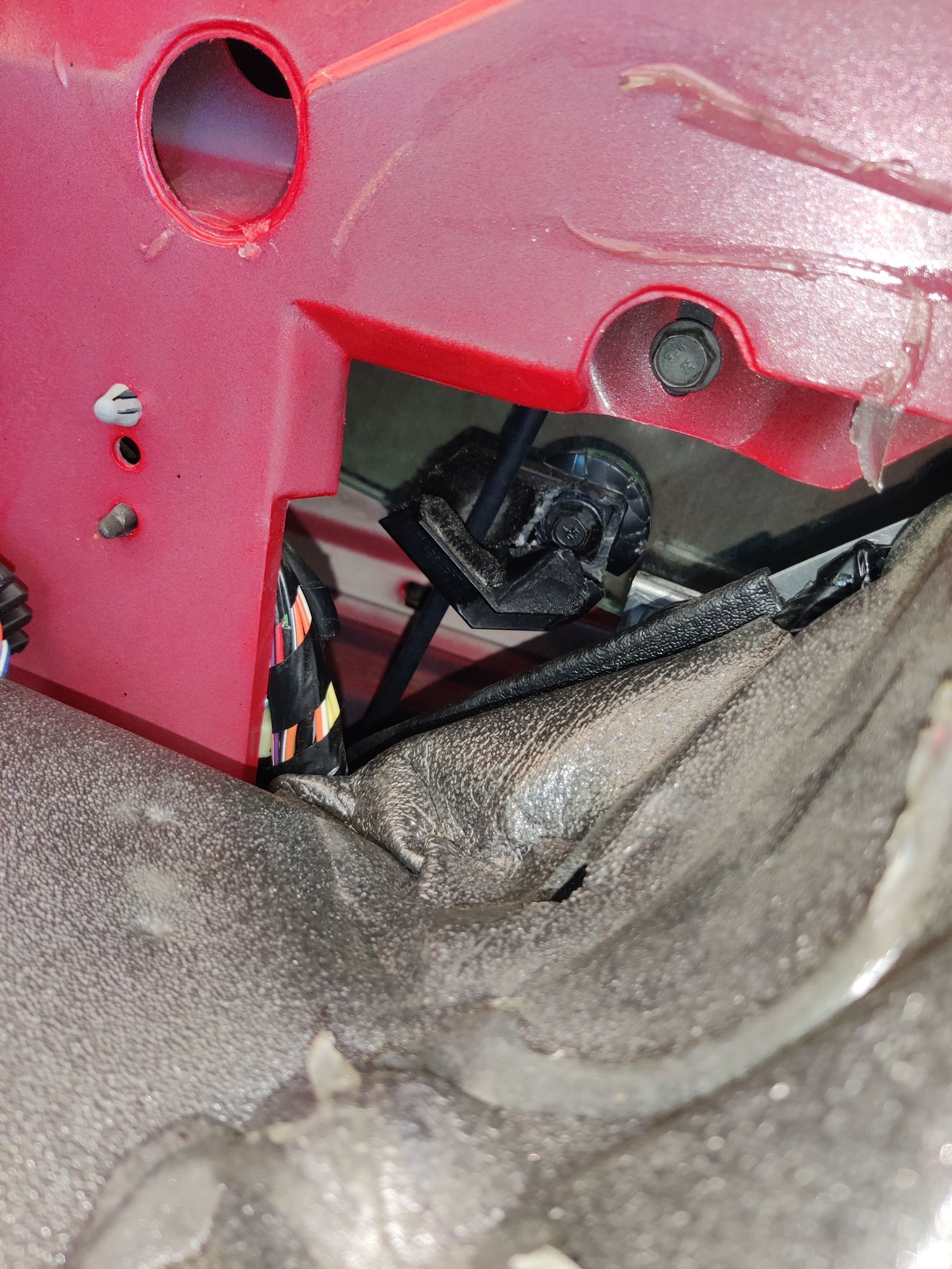

What is this part called?
Can it be changed from the front with only the front panel off?
Does this part come in contact with the window stop? I'm assuming it finally gave way to coming in contact with the window stop, but I can't tell clearly if the two meet when the window is closed.

I believe that is the window Channel guide for alignment .
What year ??
https://www.zip-corvette.com/93-96-d...cVyydY#258=966
jump to 4:57 in the video

Yes window alignment deal and you need one for sure. It will make a world of difference when you do. $24.99
1993-1996 Corvette Door Window Guide

Originally Posted by vets-vet
i believe that is the window channel guide for alignment .
What year ??
https://www.zip-corvette.com/93-96-d...cvyydy#258=966
https://www.youtube.com/watch?v=eq7bude-olk
1995

I just ordered the front right.
Do either of you know if this also makes contact with the window stop? What exactly does the window stop touch to make the window stop?
