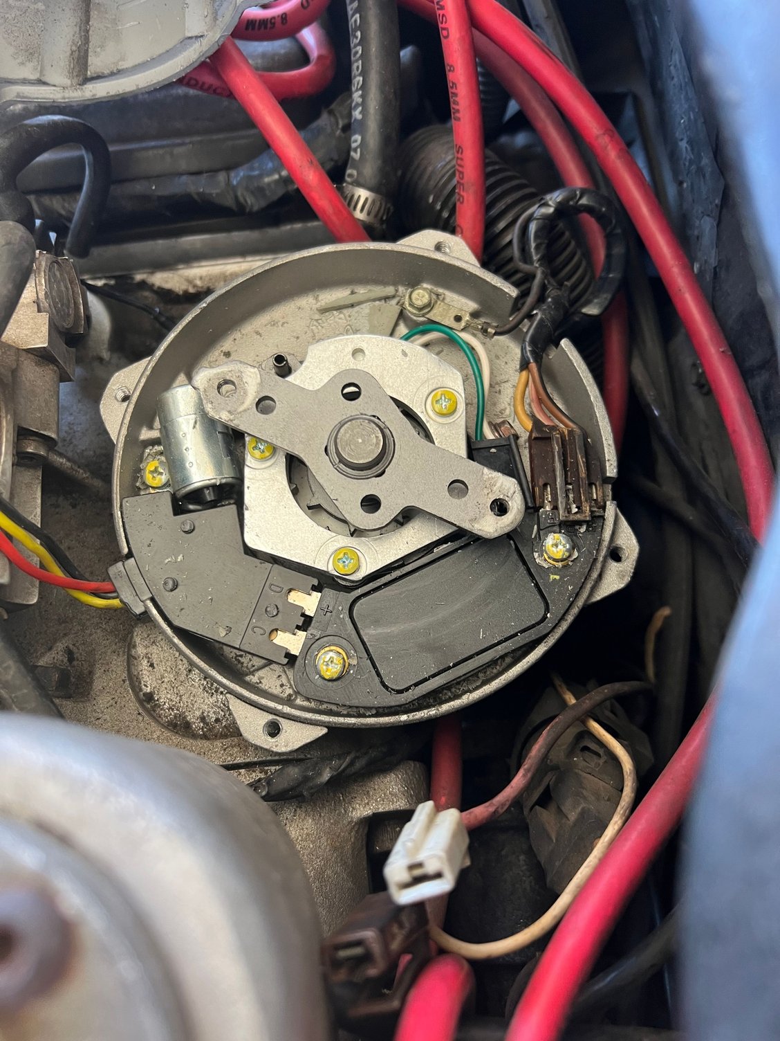

Shop replaced my distributor (2,000 mi away). Apparently they didn’t tighten the rotor properly, car died. I replaced the coil pack, rotor and cap. Still no spark.
I’m having difficulty finding sufficient troubleshooting info. Should I replace the electronics module, ? could have been damaged. Feel a little silly but never dealt with anything like this.

So it was the electronics module..just seems odd to me that this component is not mentioned anywhere I found trying to track the issue down. At any rate she fired right up but all kinds of ugly problems under load, probably still unkn electrical issues from mice chewing wiring under dash.
