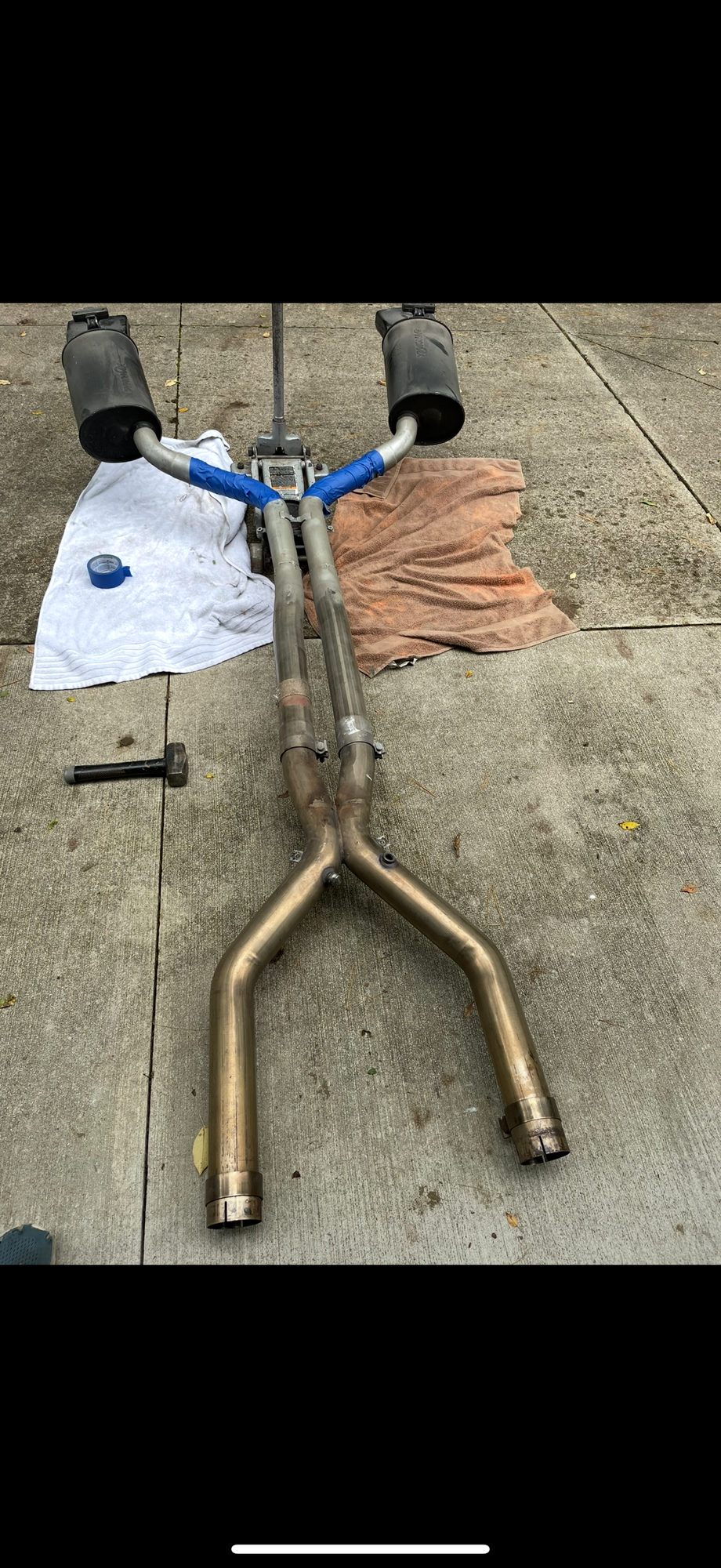

On the Corsa. I actually own a set for my Z and need to install. i have always wondered why there wasnt a cheap chinesium knock off (its simply a heimholtz yeah?) like there is in every other product.
@ Dizwiz whatever u end up doing for exhaust im interested in hearing about it

OBX is the Chinese knock off. Looks same, but not same.
