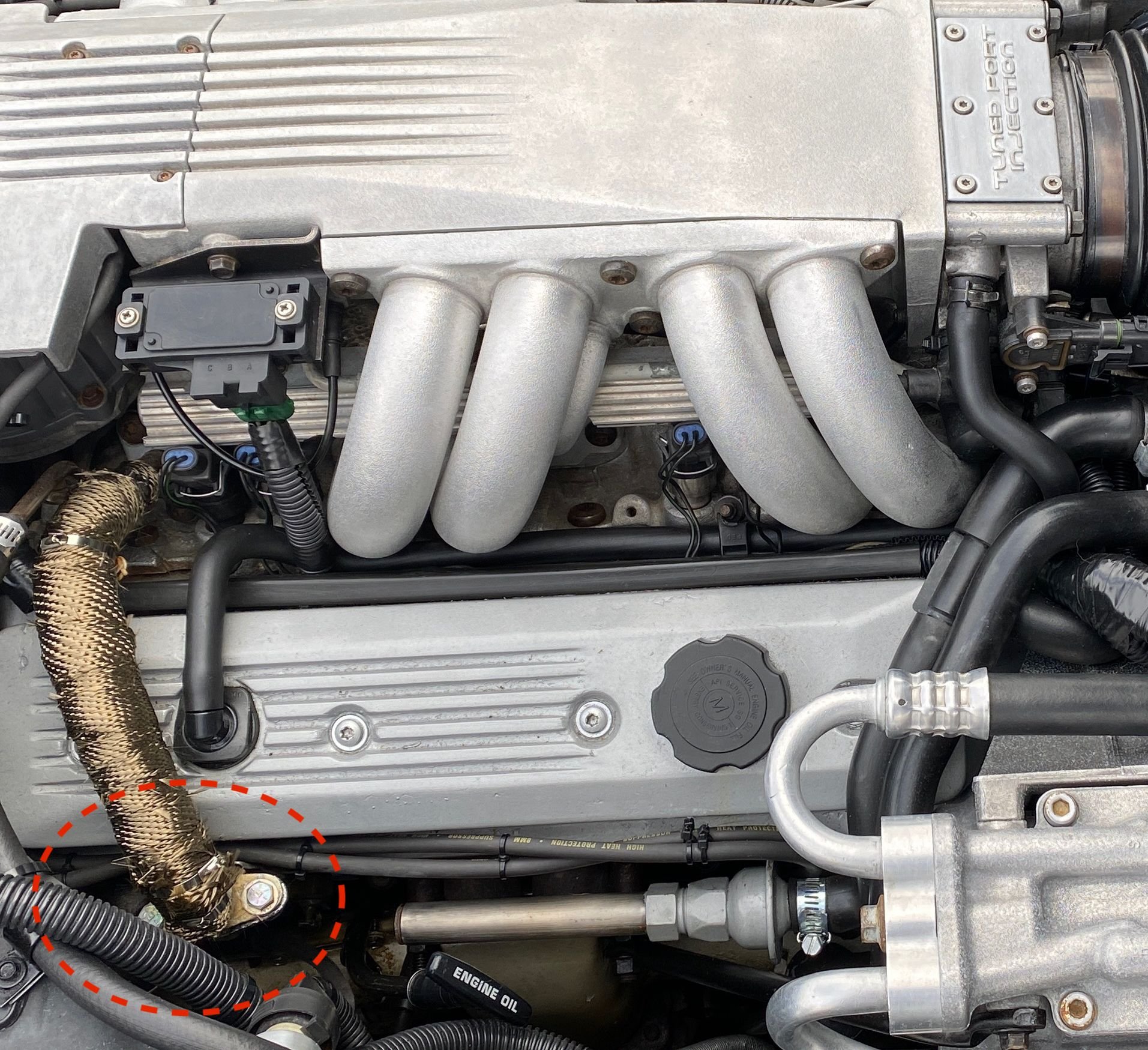

The only pain in the rear end part of the job is gettting the EGR crossover pipe off if those two torx bolts connecting it to the exhaust manifold (which never should have been installed there in the first place) are shot...which they probably are.

See if you can loosen those two torx bolts connecting the EGR crossover pipe to the exhaust manifold and get back to us.
If you can loosen those, it's smooth sailing after that...
Not the two torx bolts connecting the crossover pipe to the intake manifold. I'm not talking about those. Those are easy and don't tend to get rotted out, as they aren't exposed ot such harsh heat conditions
I'm talking abut the two torx bolts connecting the crossover pipe to the exhaust manifold.
I've already replaced those torx bolts with something I can actually turn in the future without em rounding out like the rotted OEM torx bolts did, as you can see there.

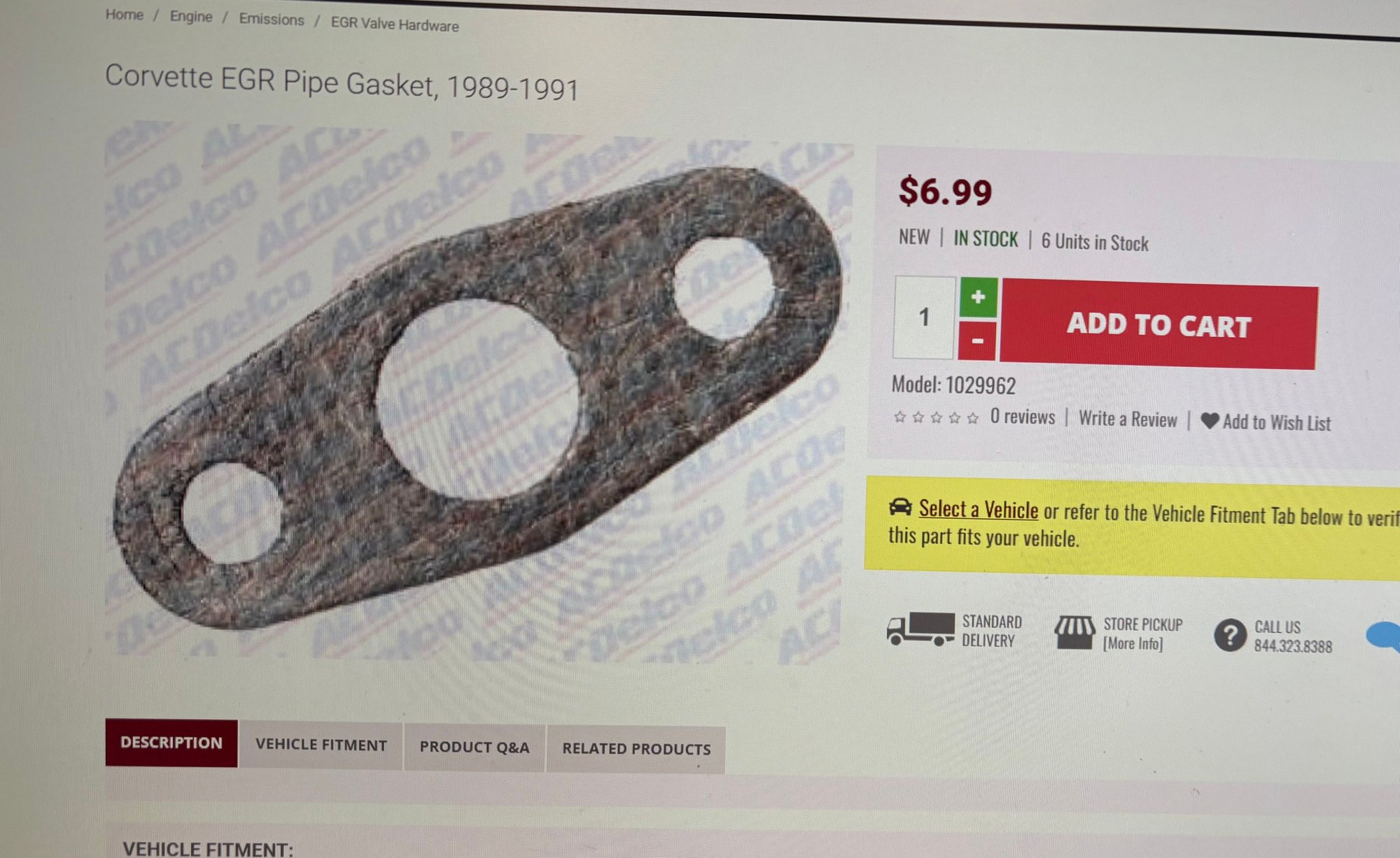

valve covers are in good shape. I'll take some pictures when I get home. But this is the gasket that I need, correct?
Old Mar 24, 2025 | 04:12 PM
Natty C's Avatar
Natty C
Joined: May 2019
Posts: 3,238
Likes: 1,403
From: Mid-Atlantic
2022 C4 of the Year Finalist - Unmodified
2021 C4 of the Year - Unmodified Finalist
Yep, that's the one. You need one on each end of the EGR crossover pipe. So two gaskets in total.

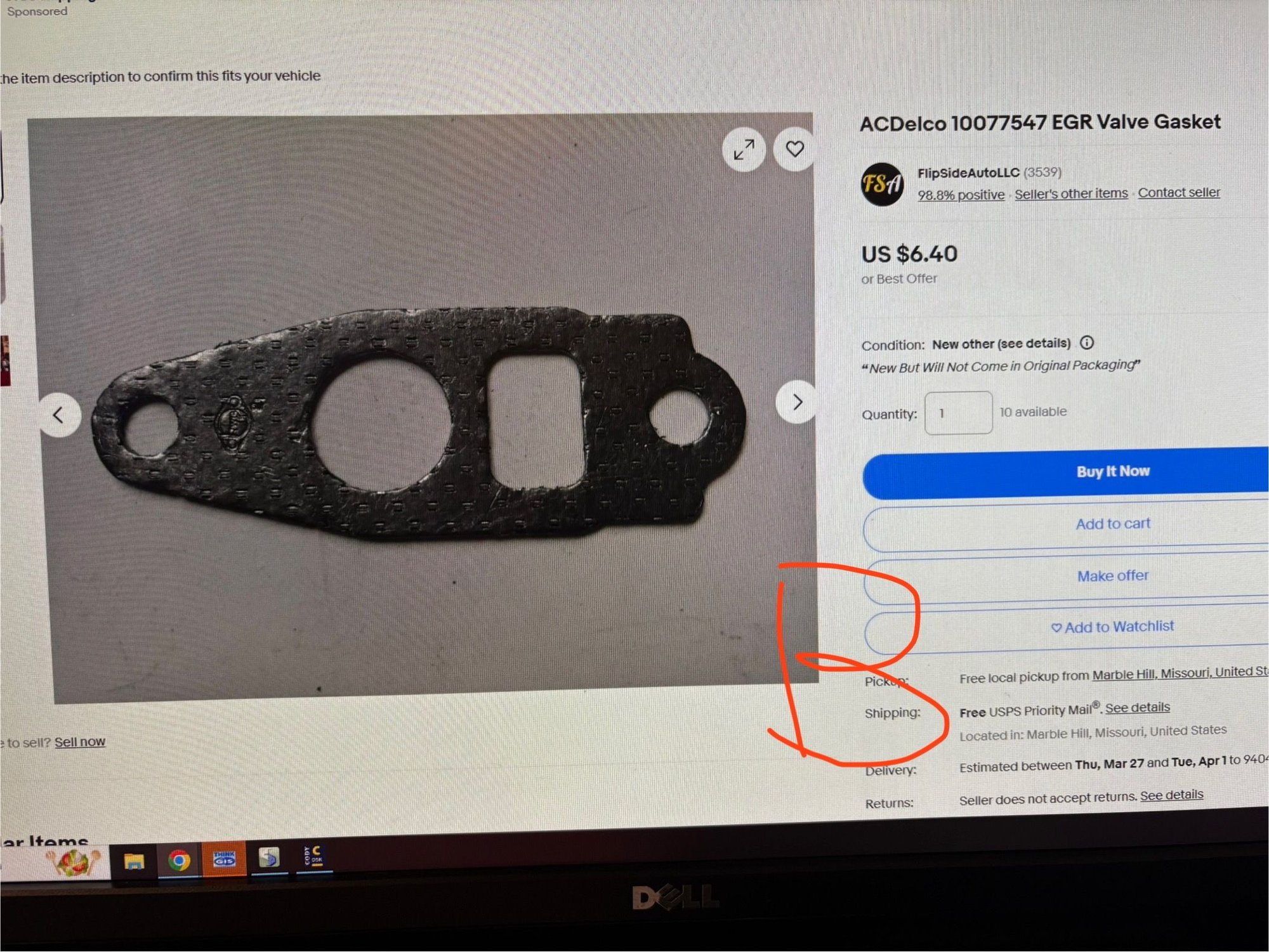

So the Chevy dealership gave me two different part numbers. He isn't sure which one i need. Any idea - A or B??
Old Mar 24, 2025 | 08:04 PM
Natty C's Avatar
Natty C
Joined: May 2019
Posts: 3,238
Likes: 1,403
From: Mid-Atlantic
A is the one you want. Again, one on each end of the EGR crossover pipe, for a total of 2.
Although A here is described as the A.I.R. check valve pipe gaskets I'd mentioned earlier, it's the same gasket which is used for the EGR crossover pipe.
You can get em on eBay for pretty cheap.
Just type in ''Standard Ignition Egr Valve Gasket - VG85''
B is the EGR valve gasket. That's not the one you need.
