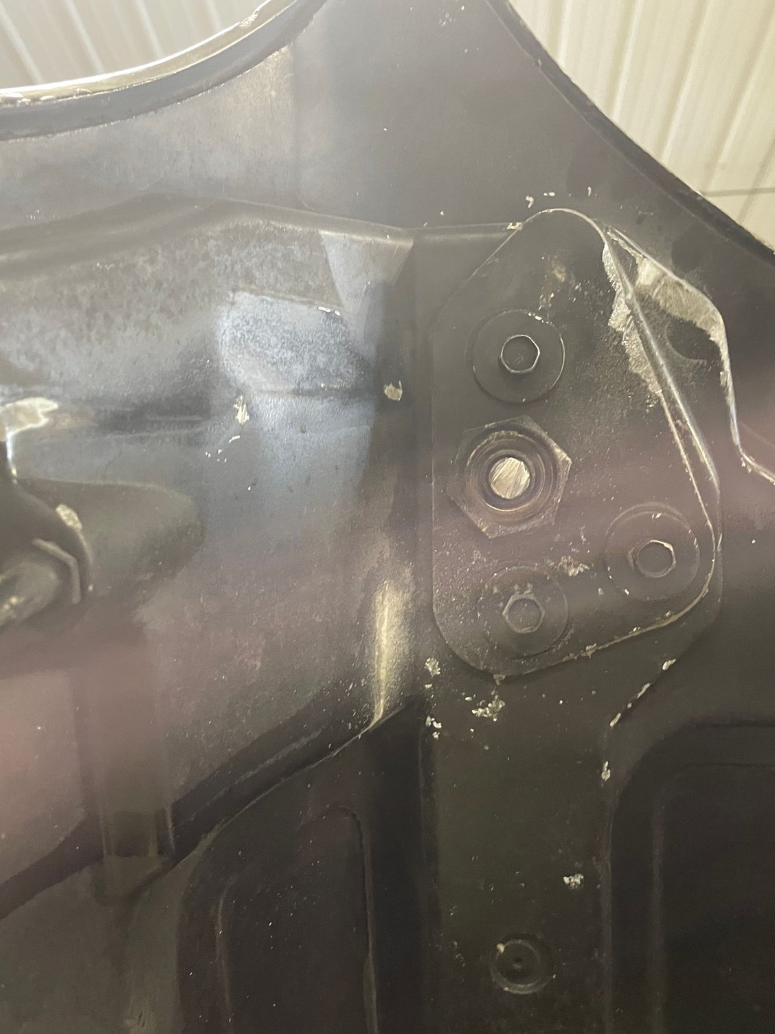

Here's one way:

Originally Posted by IHBD
Here's one way:
your option won
cutting bolt

Originally Posted by Dachurchill2
your option won
cutting bolt
mI or damage but fck that bolt
I meant it as a joke. The pic I used is from another peep that couldn't get the hood open, but he wasn't trying to save the hood because of collision damage and he has a replacement.
A few years back I passed a pretty beat C4 on the freeway and laughed for over a minute when I saw a 3"X5" cut out in the side of the hood above the battery. I surmised he couldn't get his hood open either, and didn't give enough ***** to even glue the piece back in the hole.
I k ow you did we all laughed at it but unforchently since nothing was aligned correctly we had to cut the pin no real damage other then minor
