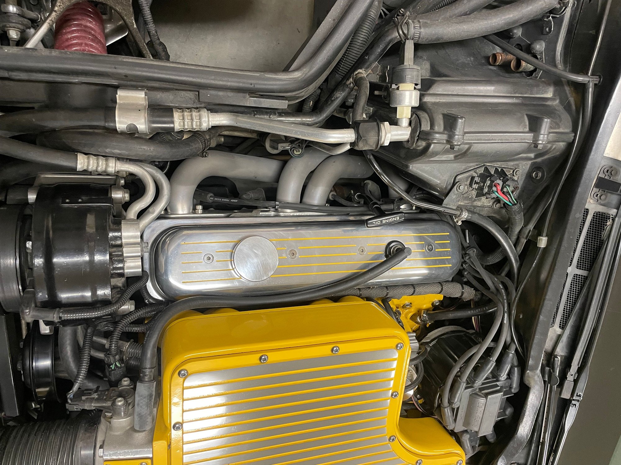

Originally Posted by Hit Man X
@AGENT 86
any pics you can post? I am lazy and want to toss on Hooker shorties from an LT1, but cannot find them anywhere for reasonable. If I need full length, oh well.
These are 19 years old now, would look better if I had not faded the ceramic coating during cam break in. 🤬
Old Jun 3, 2025 | 10:20 AM
Hit Man X's Avatar
Hit Man X
Joined: Apr 2023
Posts: 274
Likes: 60
From: Texas
Any idea how far back the collector sits on these? I am leaning towards these now
