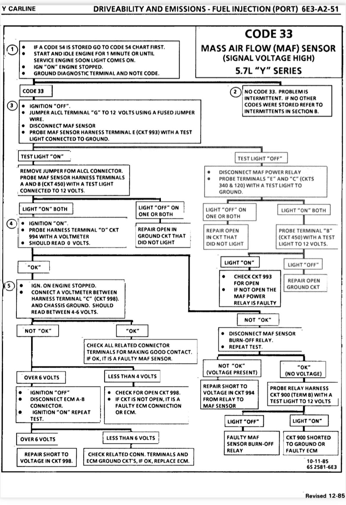

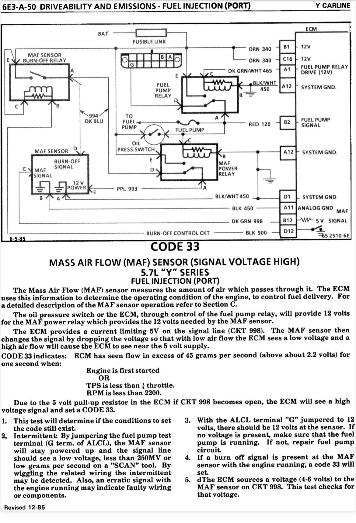

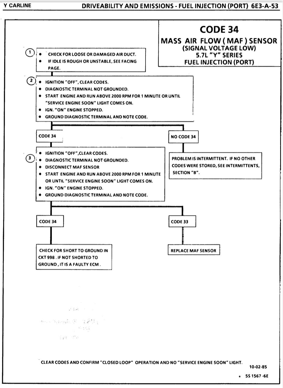

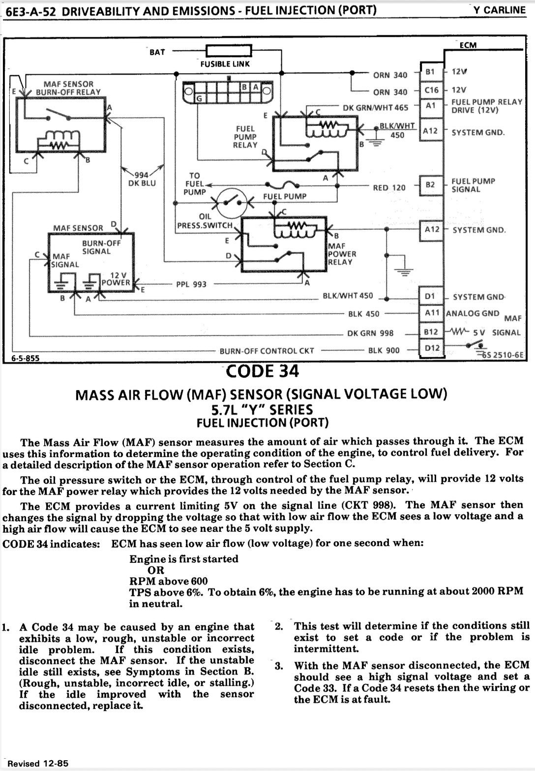

Is there a simple way to determine whether the issue is with the relays or the MAF?

Never had to deal with either of those codes, so all I can add is some info from my manual.

If you follow the procedure above and find it is the MAF, its good practice to replace both relays along with it.
