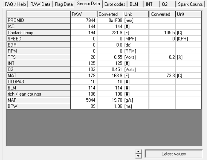

I've been chasing an issue for a while now that I can't seem to figure out. I recently installed a 52mm throttle body onto my 86 since many said it would run fine stock. I reset the IAC and the TPS but noticed that once the car is warmed up it surges at idle but at only about 3 out of 5 stoplights I stopped at on my test drive. The car triggered a code 44 (lean exhaust) however the car seems to smell very rich. I used WinALDLl for the first time to figure out the issue and am having trouble understanding the info.

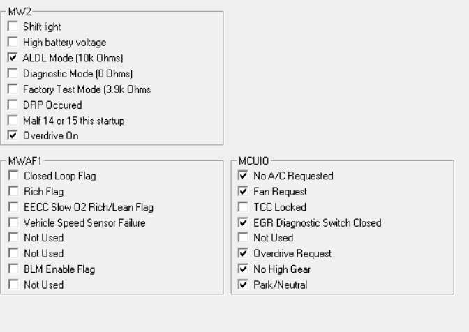

In the flag tab I noticed that while idling, the
In the flag tab I noticed that while idling, the "Rich Flag" and "EECC Slow O2 Rich/Lean Flag" would pop up every couple of seconds and then go away, rinse and repeat.
the O2 voltage seemed to be moving back and forth as it should. Other than that I don't really understand the other counts.
I would really appreciate any info that would point me in the right direction of solving this problem!

In ALDL Mode (w-10 k resistor and while scanning with Win ALDL at 160 baud) it should idle at 1,000 rpm. The number of IAC counts and MAF (gm/sec) in a stable warm 1,000 rpm idle will provide a clue as to where you are with respect to the min airflow adjustment. You should see around 80 IAC counts at 1,000 rpm (a bit more than the middle of the range), assuming about 0 at 500 rpm, ~70 at 900 rpm and ~140 at 1300 rpm.
Normal (warm/hot) idle for an auto trans car (in gear) should be 550 rpm. Add 50 rpm for park/neutral.
