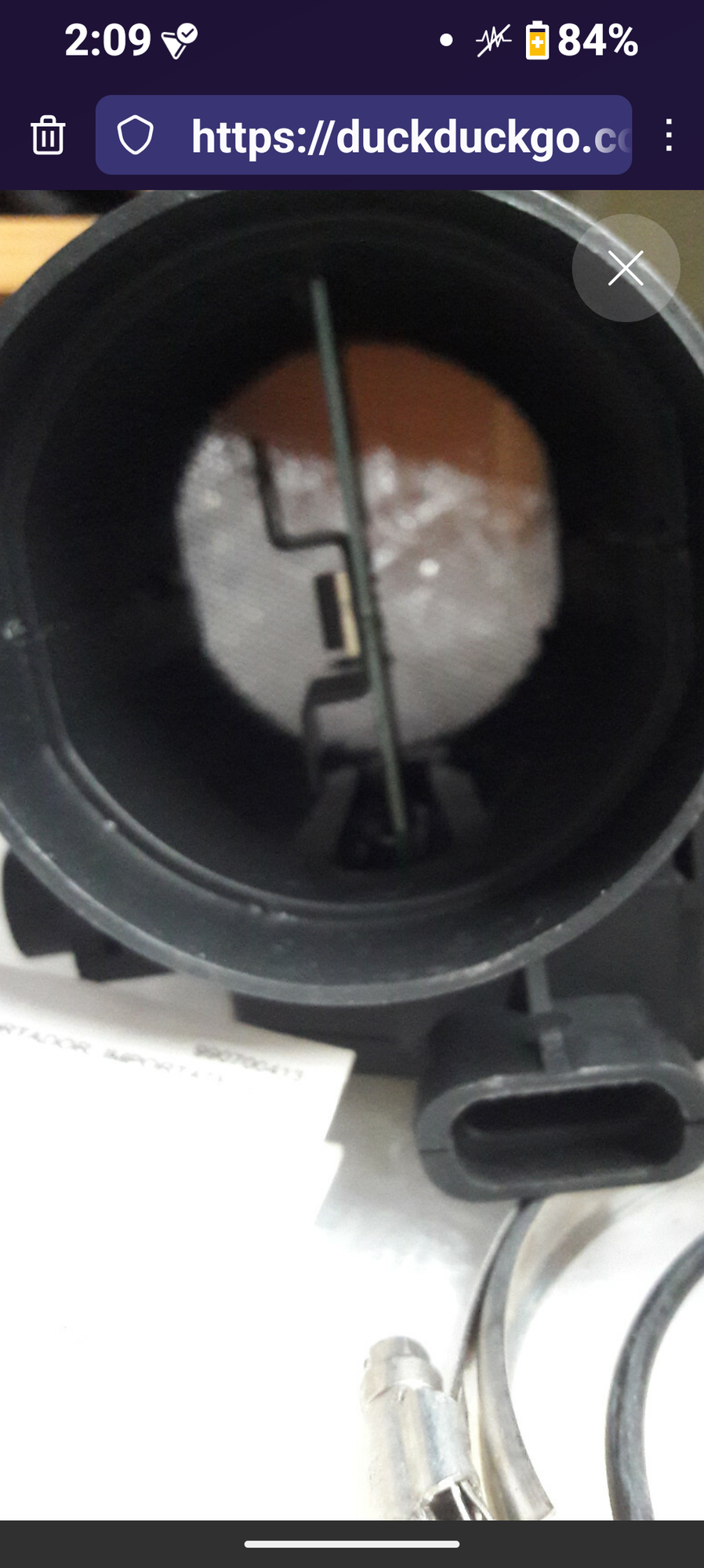

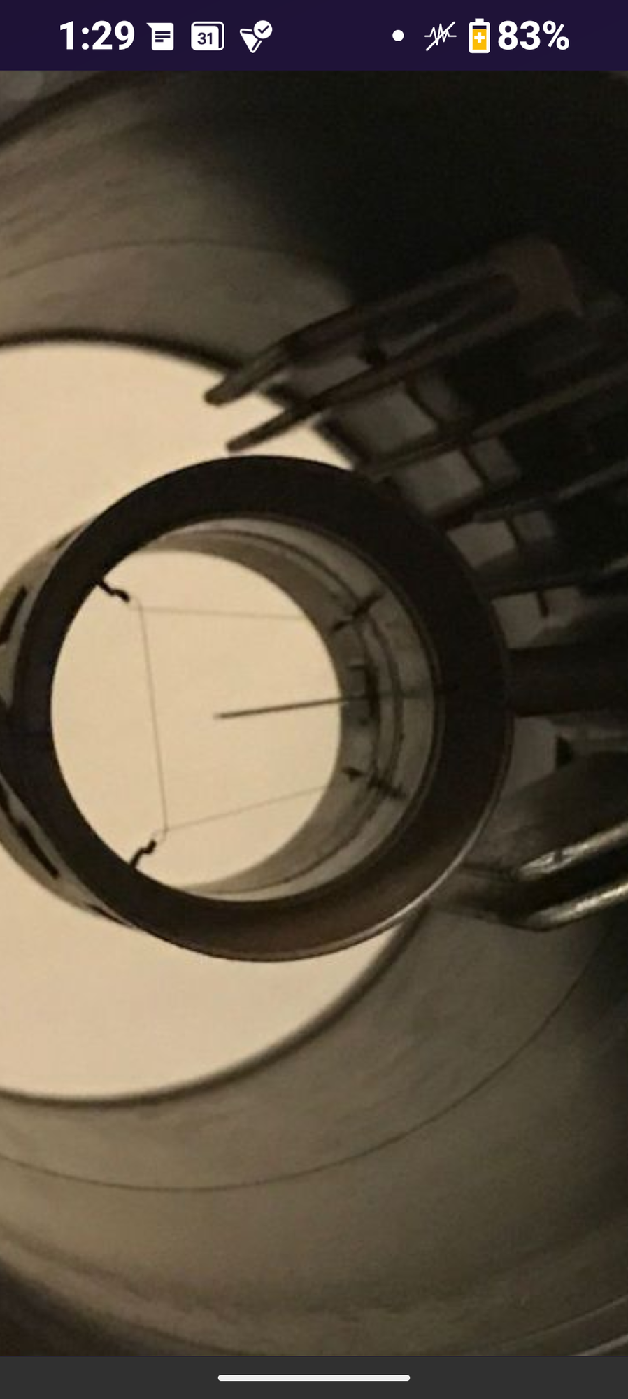

Try and get a good used one, do not trust a maf that is not a correct Bosch maf sensor. The ecm uses the wire to measure airflow, how can one without this wire work?
I had this happen years ago was totally different inside did not work, had to find a correct Bosch sensor it worked perfectly.
Should look like this inside, if you cannot see the wire avoid it. I would look for a good used original 👍
Not like the crap below ..... That is what the so called new one was like, didn't work and the seller will say no warranty as is electrical part. They throw you under the bus with that nonsense, even tbough their part was clearly not a genuine bosch maf. A copy that looked the same outside, only later found out I needed a modified ecm to run those type of mafs...... Be very careful look at your maf part number on bottom panel get an exact replacement, there are different part numbers for the 85 to 89 mafs.
