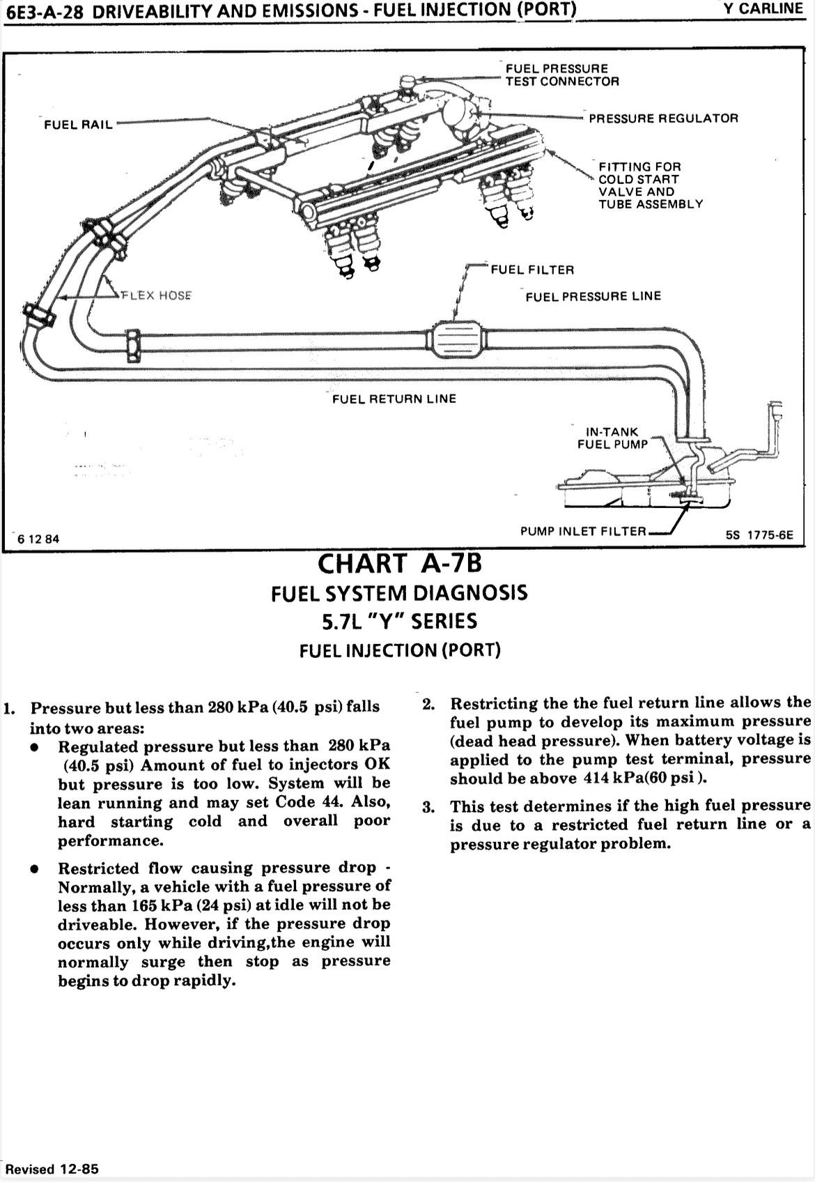

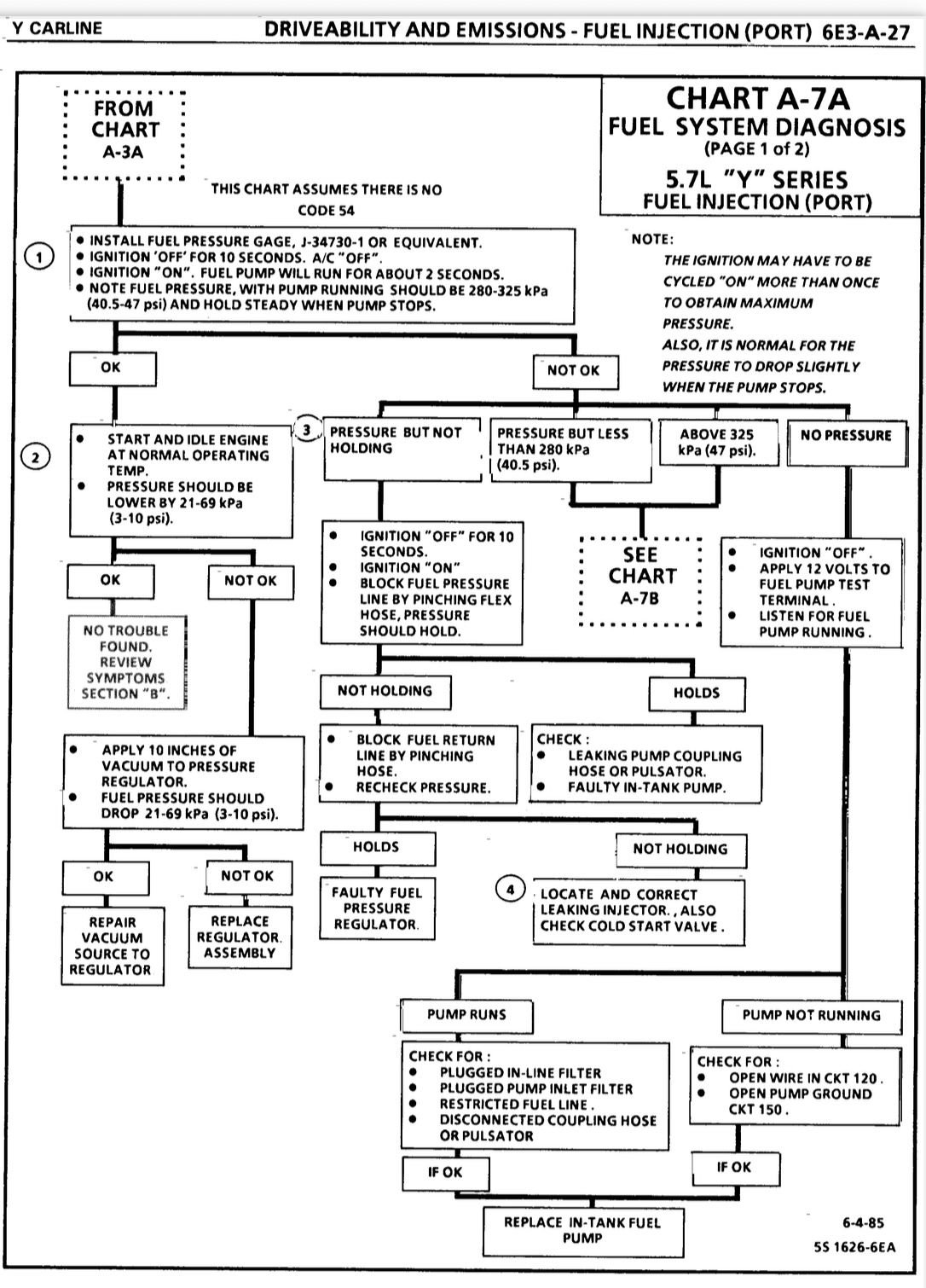

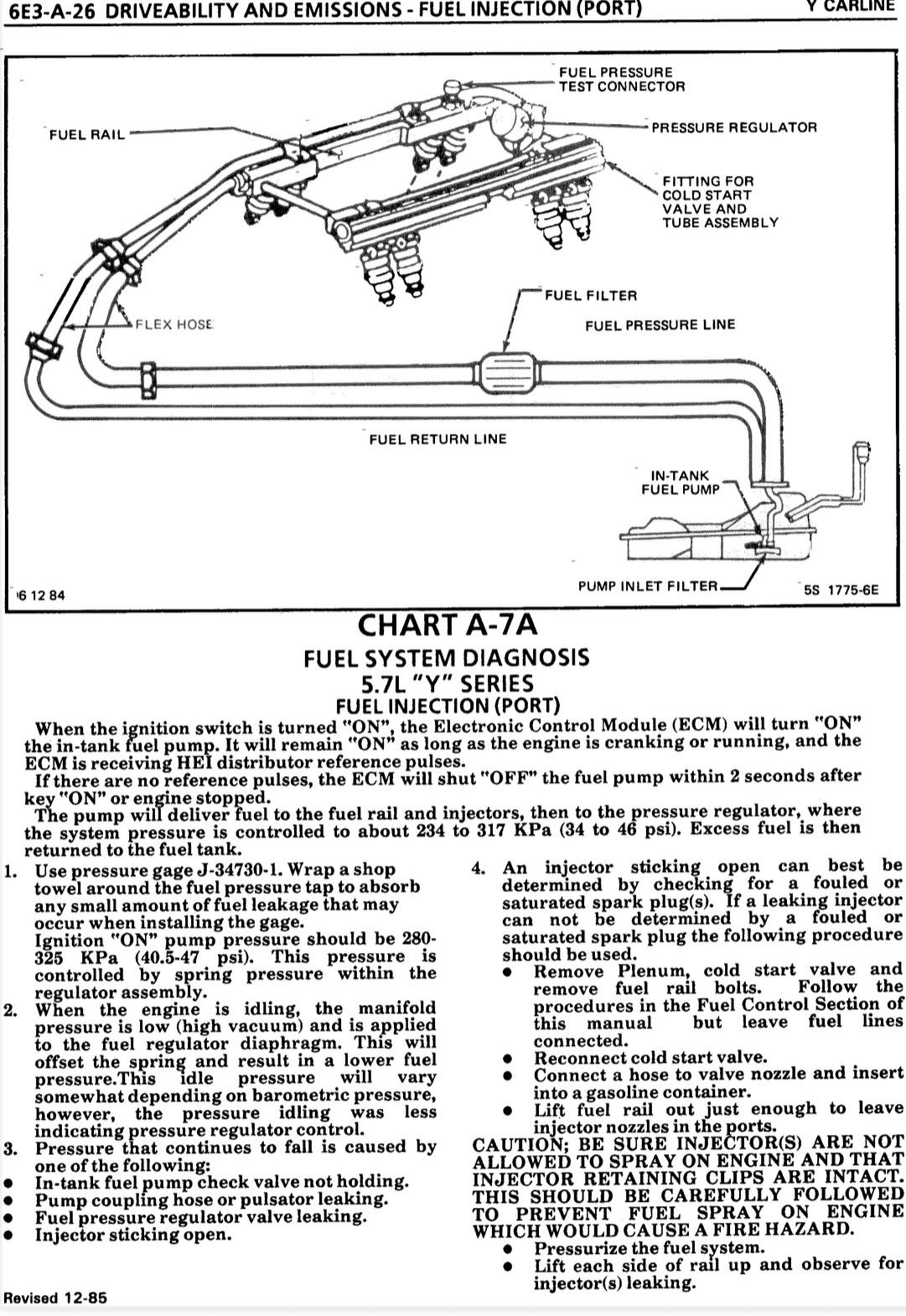

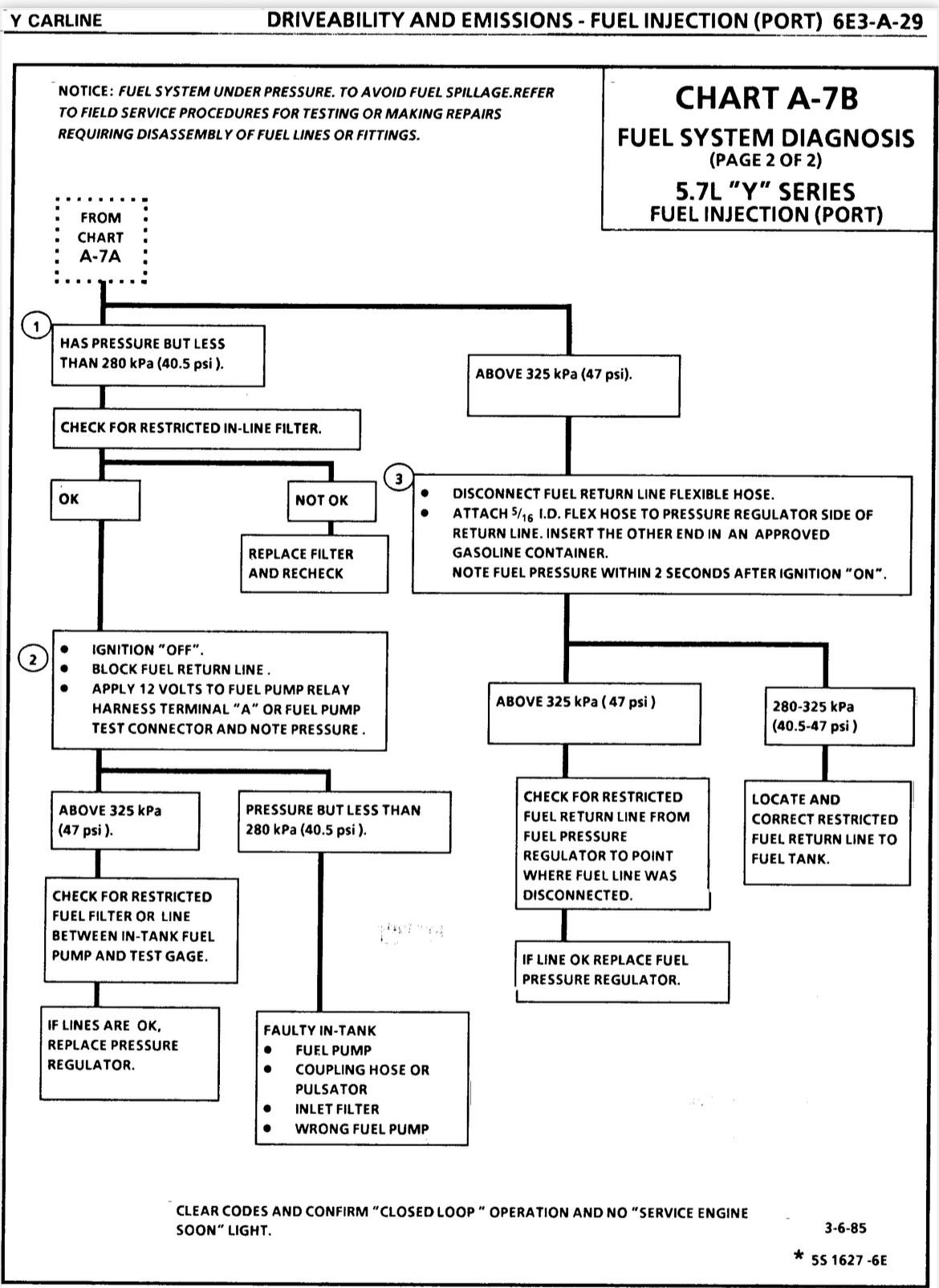

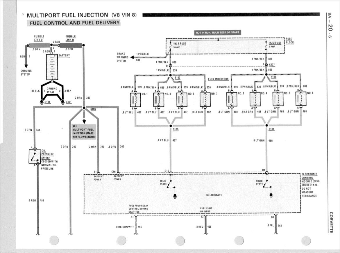

Old Jul 3, 2025 | 03:12 PM
AGENT 86's Avatar
AGENT 86
Active Streak: 90 Days
Joined: Jan 2003
Posts: 20,322
Likes: 248
From: Summerland B.C. Canada
Old Jul 3, 2025 | 07:25 PM
AGENT 86's Avatar
AGENT 86
Joined: Jan 2003
Posts: 20,322
Likes: 248
Oops, forgot these 2 🧐
