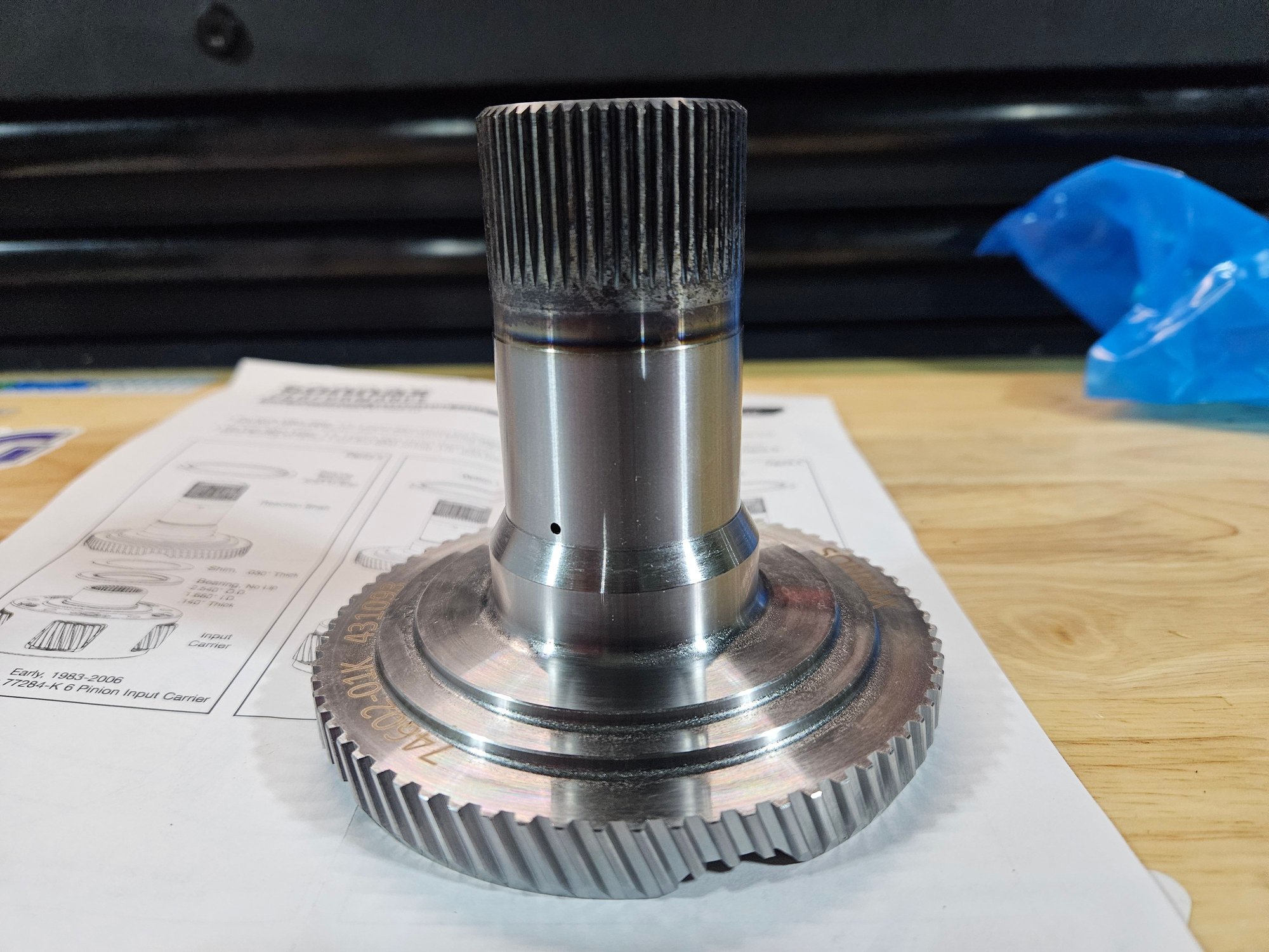

Will be going with the Sonnax 5 gear set which will change the ratios as well. Did the math, think ill be happier with the gear ratio spread. Also the Sonnax input housing kit and the reaction shaft kit. Id rather do this now and have a piece of mind. Just need to sell some more blood lol...
A 5 gear planet will not change the ratio. 4l65 and 4l70 had this planet carrier for increased strength. It will retro into the 4l60 but no ratio change. If you want the ratio change, it is the Sonnax unit with 6 planets and 38 tooth sun gear.

Well I desperately need Sonnax part # 77733-10kb, and of course NO ONE has it...If anyone has a lead on one, please PM me.
And the gear change wont happen as I found out they are more for turbo LS motors to keep them in the powerband according to the builder.
Uh, just my luck

Emailed Sonnax and they actually got back to me. He said GM had a "part disruption", and that they only just received the drums at the beginning of the year, then they go through multiple process before shipping. So the ship date of end of February should be correct. At least some light at the end of the tunnel!

After having the Sonnax input housing on order (and paid for) since Jan 2026 I cancelled the order. Once a month id email them and ask for an ETA and it was always "next month". Enough.
So I ended up talking the the guys at 4l79.com and went with their 4l78 setup. This is not the strongest one they offer, but is good to 600 hp. Only reason I went this route is the 4l79 setup they have is patented by them, and it takes their own frictions and steels. I was assured the parts for it will always be in stock, but my luck if anything was to happen and I needed new frictions and steels, they wouldnt be available. The 4l78 setup takes the regular size frictions and steels. They also told me they have a lot of drag cars running the 4l78 setup with no issues. So thats the route im taking.
So they dont have the hardened input shaft however. They told me if I can get one, ship it to them, and the will press it into the new setup with the input sleeve as well no charge. So apparently I found and bought the only Sonnax hardened input shaft in the country. $800. Ouch. Its on the way to them and they said 24 hour turnaround and its on its way back to me. Once I get it, im hauling *** down to my builder with the new parts.
My goal is to have the car back together by mid May. And im gonna drive the **** out of it. There is a Corvette show June 6th near me, and I plan to be there.

Thanks. Yeah, its a little stressful sending a $800 piece to a place ive never been to or heard of, but I did talk to them for 15 minutes on the phone and felt better about it. Plus I google earthed them to make sure it wasnt some dudes garage lol.
Hopefully in 2 weeks ill be installing it. I NEVER wanna pull this transmission again. But the one bright thing here is that ive learned more about auto transmissions (especially this one) in the past year then I have in my 52 years. So there is that!
Oh and I forgot, the stall speed has been increased by 300-400. So that should put me at 2900-3000 roughly.
