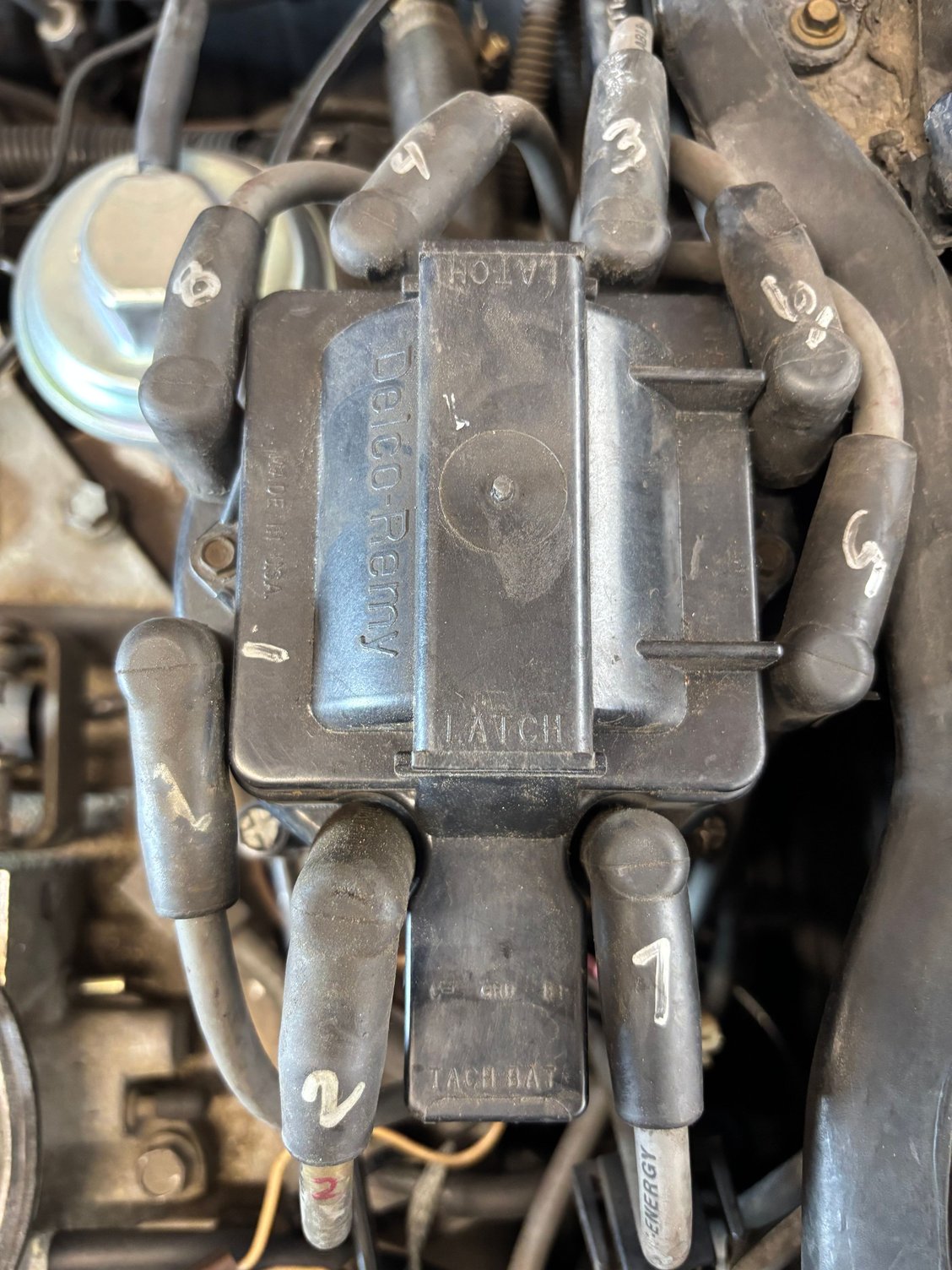

In case you lost track of where each wire goes.
In case you lost track of where each wire goes. Haha.

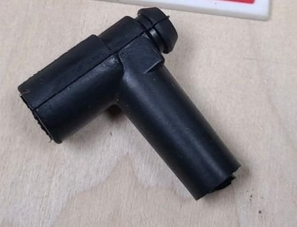

Originally Posted by typical boomer
I think the holes are for plug wires that have the numbers printed on top of the terminals.
The holes retain rubber extension of wire boot.
Typical HEI boot

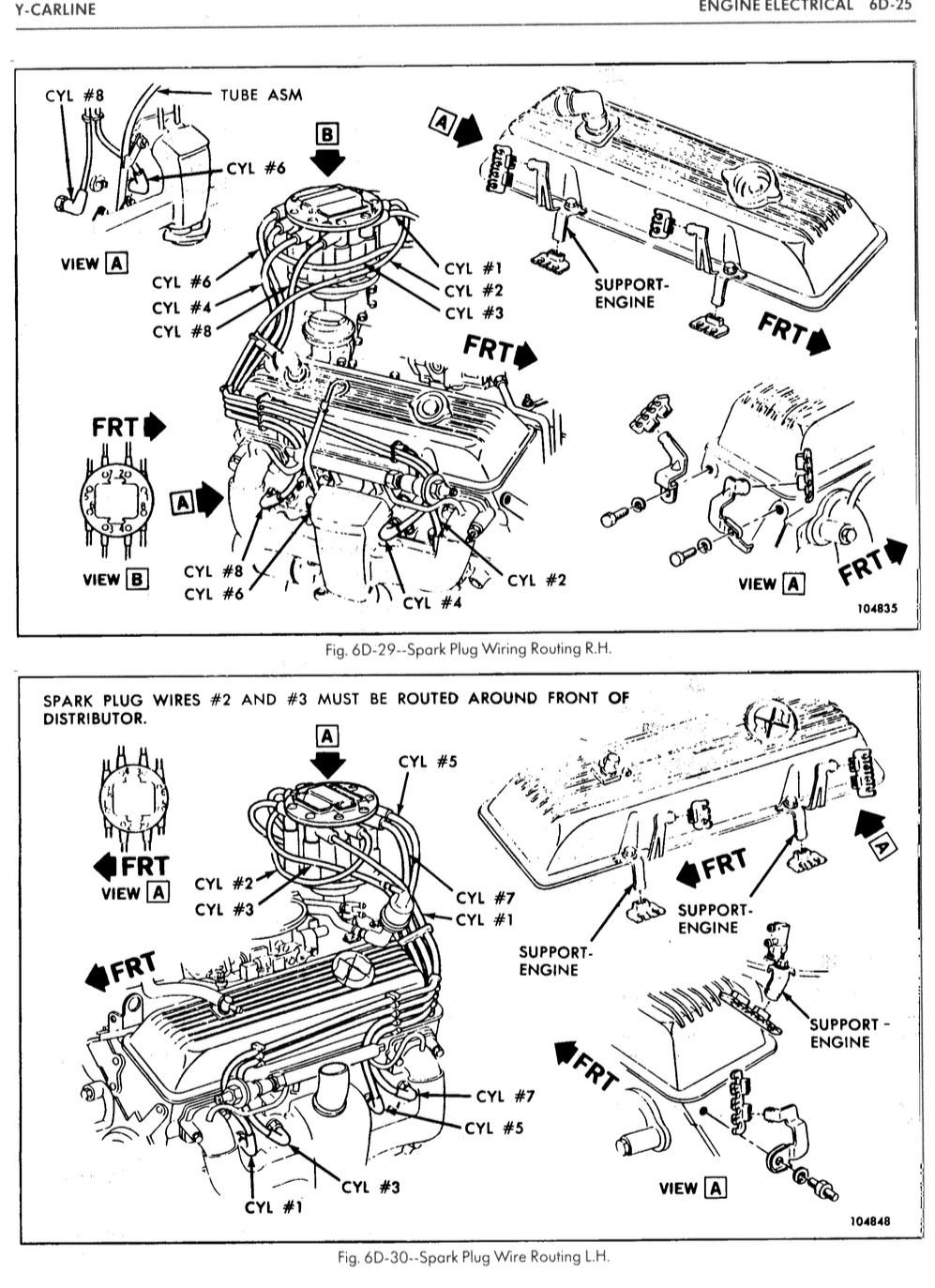

Here is wire route from manual.

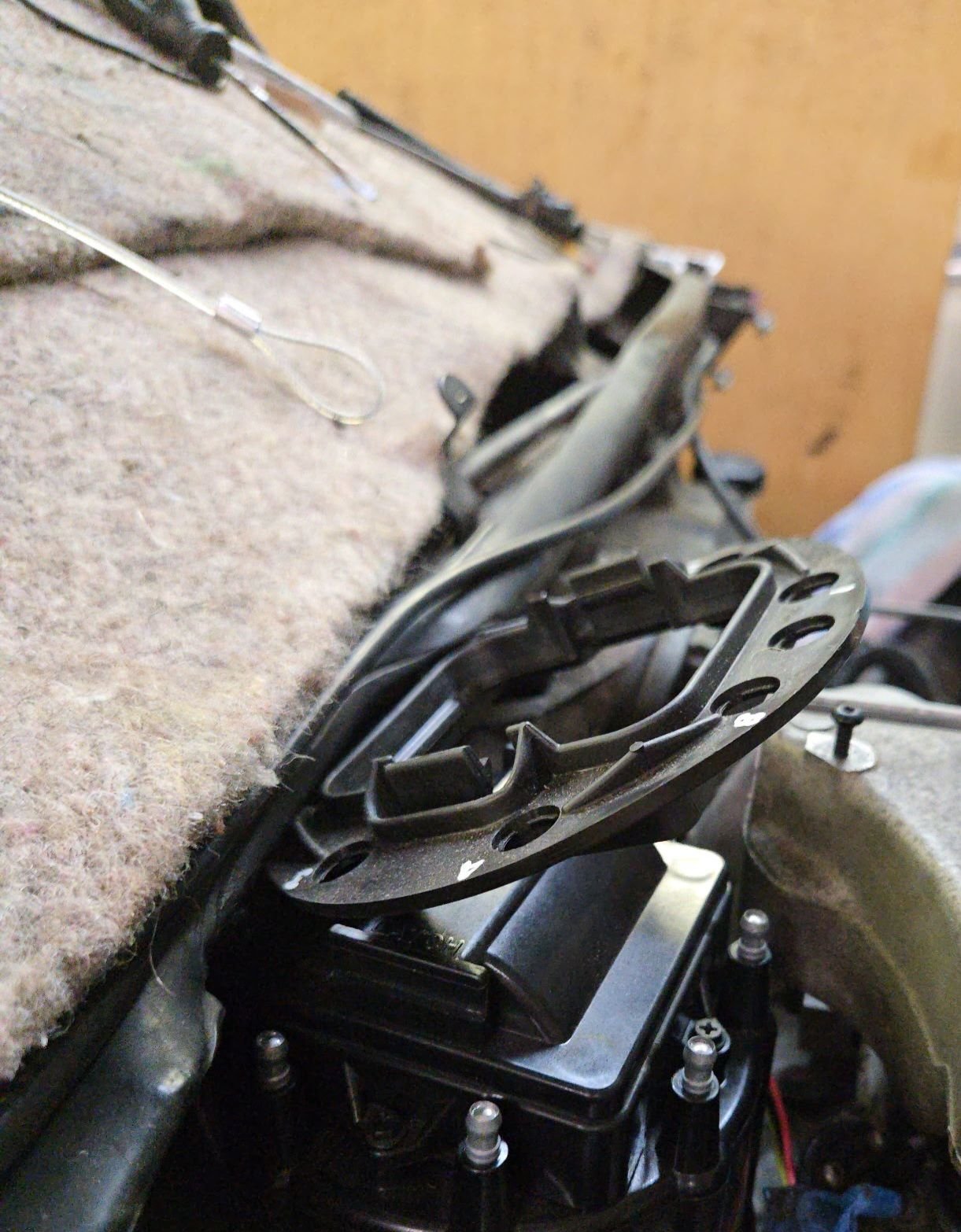

I get how the wires attach to the top plate and how the plate attached to the cap but as you can see from the picture, the firewall is in the way. The plate wont go on the cap.
Typical HEI boot
Yup I went back and looked at my "new" wires and sure enough they look just like the hei boot style you pictured.
