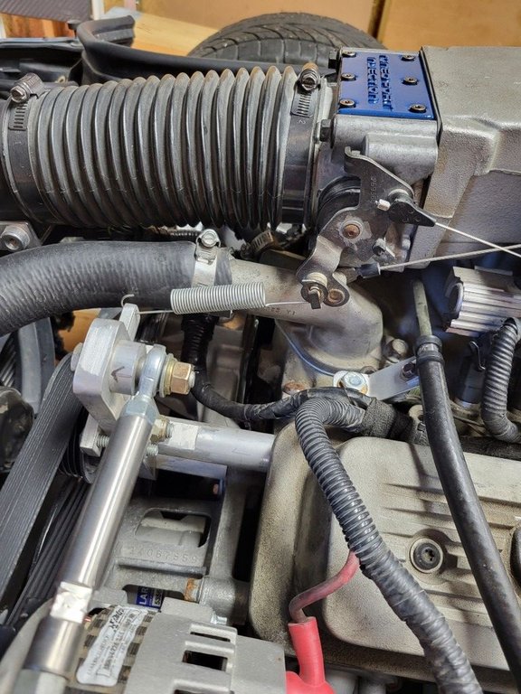

I had the same problem on my 88. I tried all the solutions including the shaft bushings and nothing worked.
This is my fix. The spring is adjusted so there is just enough tension to close the throttle. It does increase the pedal pressure very slightly but nothing you cant get used to. I have had this setup for about 5 yrs and the problem has never returned.

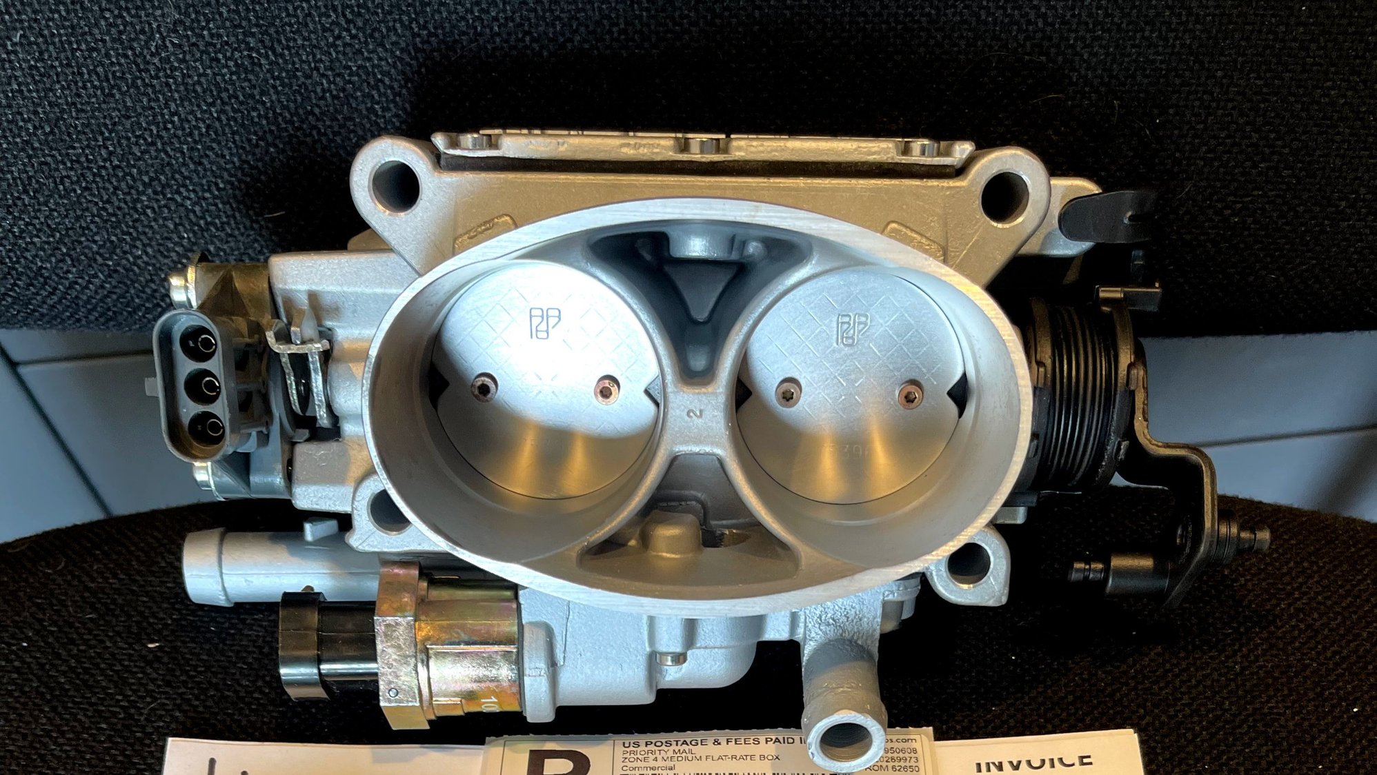

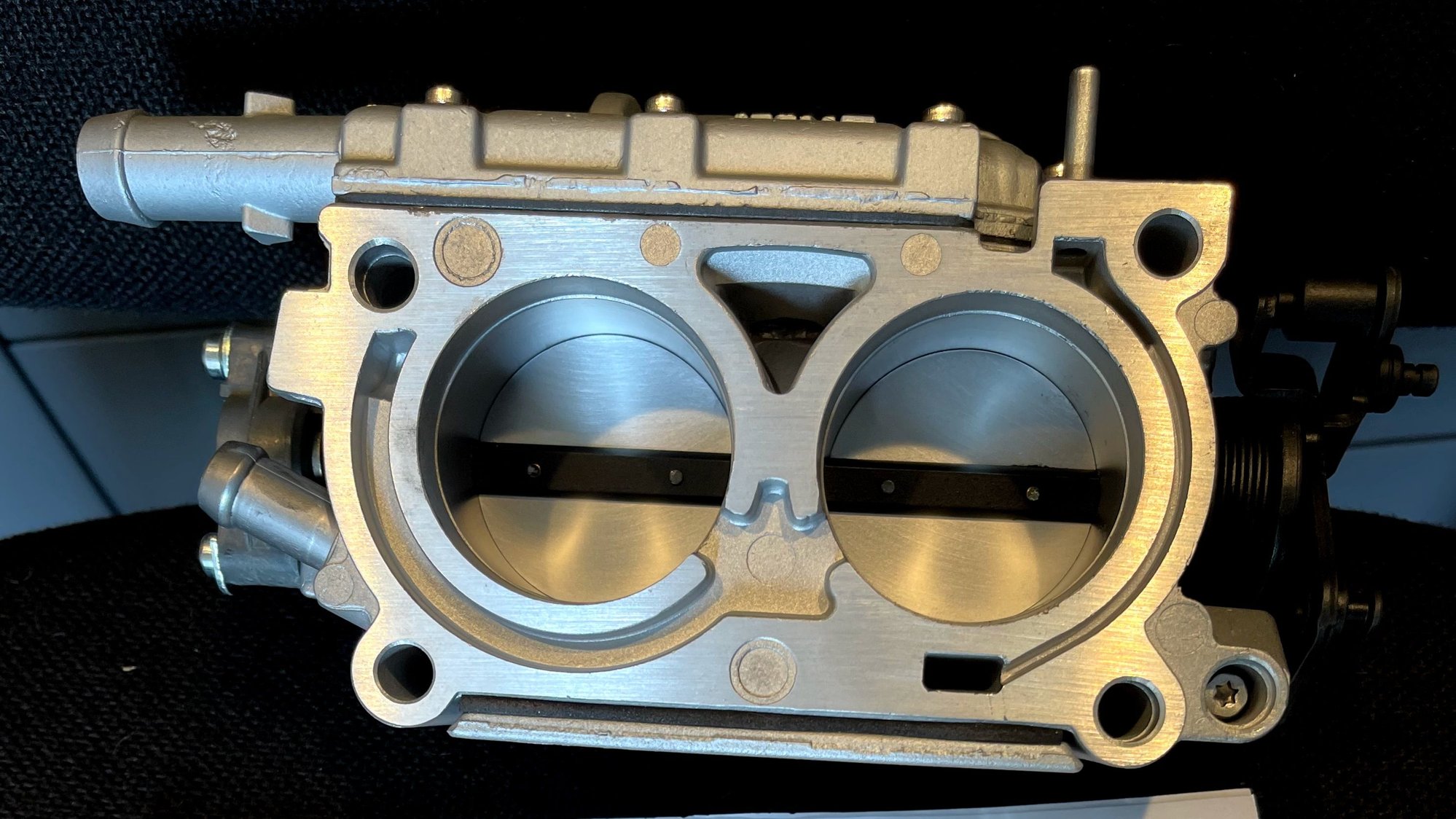

Got my throttle body back from SPR Performance and threw it back on the car. Fired right up and settled into an even idle on closed loop. Took it out and went flying down the highway no problem. Throttle response is perfect (it used to resist leaving idle when you pushed the pedal) and returns to idle on deceleration no problem.
Highly recommend SPR to anyone with this same problem. Well worth the price.

He does clean work.
While for the very budget minded its lossible to rebush, i have to say that workmanship is easily worth what you paid. Bearings should last forever. great result glad your car is good to go.
