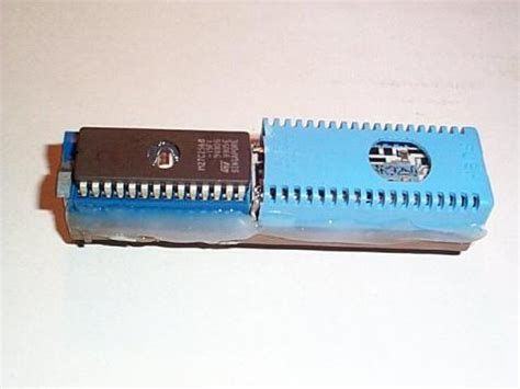

Dont forget the Moates G1 or…
…you can choose to molest your 1and only oem memcal unless you have spares.
