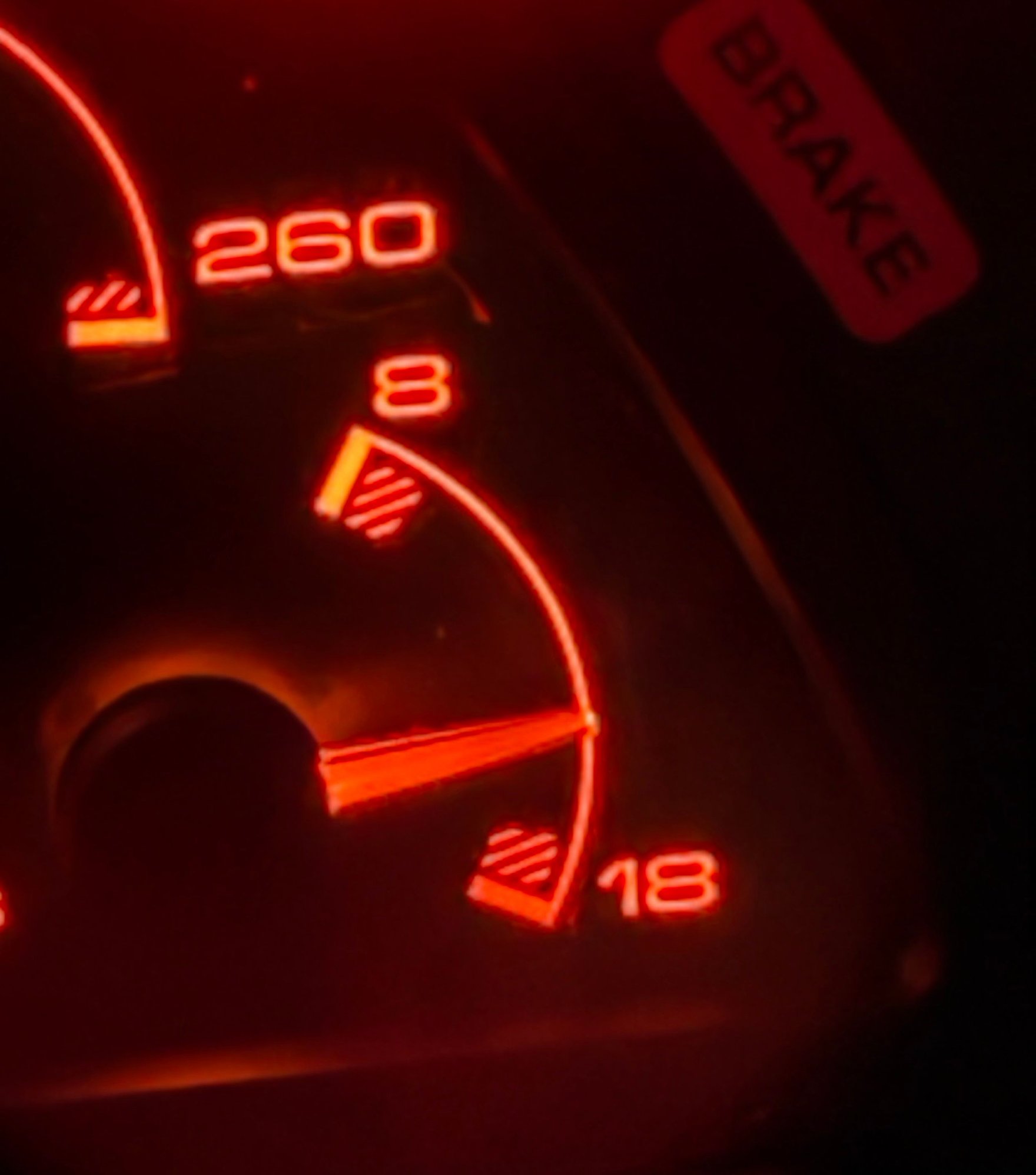

i ended up having to also change the positive cable connection and turning it into a top post battery terminal. The car is running fine and 14.5 volts when running. However, when driving at night and I push the brake pedal, the dashboard lights dim for less than a second and then return to normal when I release the pedal. The volt gauge also goes up like a quarter of an inch, if that, and then returns to its original spot at 14.5 v. Do I still have some type of electrical issue? Thanks!

Now that I changed the positive cable connection, the car is holding at 14.5 volts on the multi meter. It's no longer shutting down immediately. However the interior lights still dim when stepping on the break pedal or using the turn signal. It dims for a second and returns to normal as it "blinks". Also the voltage gauge needle moves slightly as there is a change in voltage as it blinks. A mechanic told me that it's perfectly normal for the dimming to occur momentarily and then return to normal. Is this true? i wanted to post a video but it wont let me. File is too large. While the vehicle is running and driving, the voltage gauge needle basically stays at this level... is that normal??
