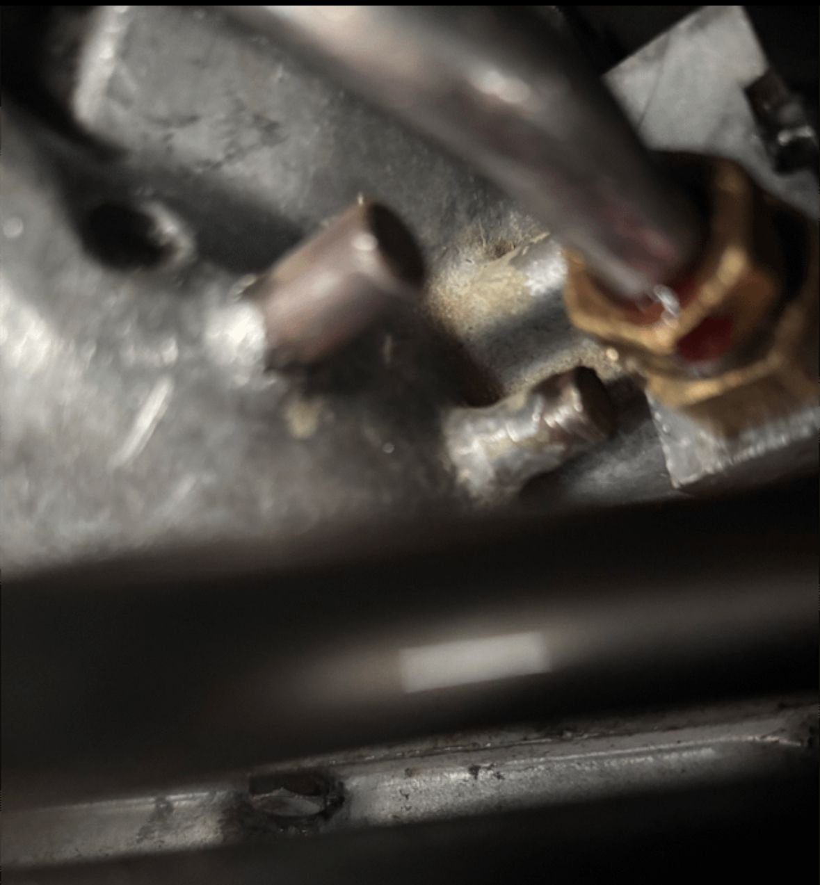

I did notice that behind the small square block that is bolted on pass side of OD unit that of the coolant lines goes to there are 2 steel rods (pencil size diameter) sticking out of the transmission case about half an inch and almost looks like they were punched through from the inside. All the pictures that I have looked at, show the end of the rods are flush with the case. I did not notice the rods protruding out like this when I had the transmission out of the vehicle. Could fluid be leaking from around these rods? The OD unit worked at it should the few times I actually engaged it.

Are these the steel pencil nubs you are talking about?
I found this image from another forum because it was a huge mystery as to what these were. They shouldn’t leak though. My guess is that they’re the entry points for molten metal during a sand casting process. I could be wrong, though.
When my overdrive leaked onto the exhaust, it turned out to be a faulty gasket which was leaking little drops as I was driving. Is your gasket perfectly clean? No rim of ATF around the pan?

Don't sweat the rods there supposed to be there, clean up everything and make many trips under to find the leak. It's common to have output shaft seals leak,
