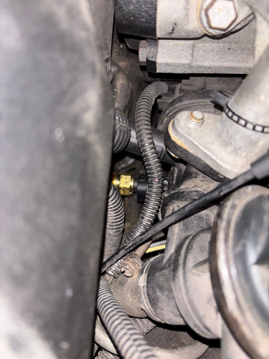

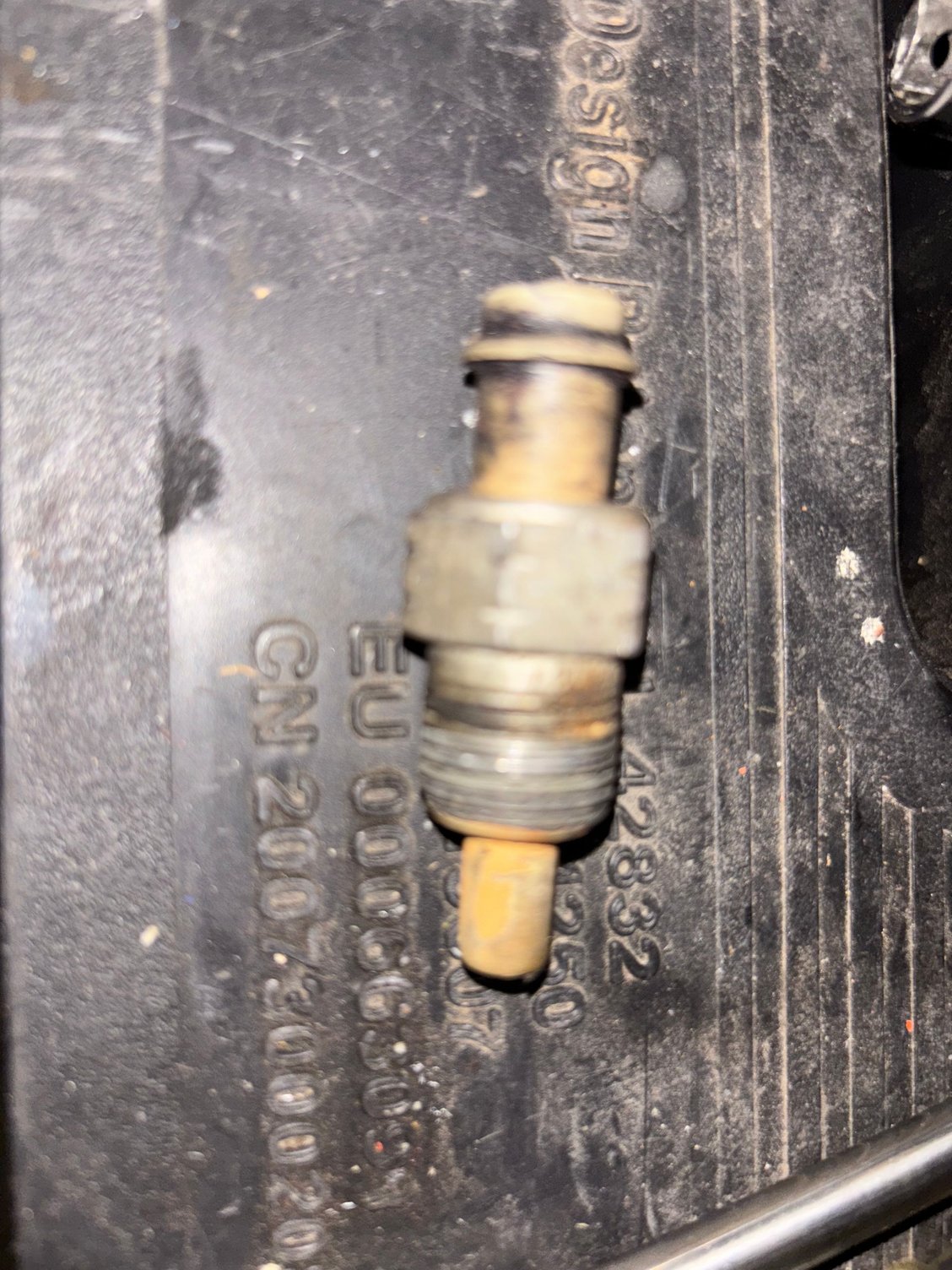

I had a similar experience with my '84. You are describing a classic failing coolant temperature sensor. The ECM uses the signal from the CTS to know when the engine is warmed up. In my case the symptoms appeared way before it finally threw a code 15 for bad CTS. Look for it on the front of the intake manifold. In your case there may also be a sensor for the cold start injector.
https://www.corvetteforum.com/forums...-corvette.html
There is the new one way down there all shiny.
The new CTS came with a new pigtail because the 40+ year old sensor had a different
The new CTS came with a new pigtail because the 40+ year old sensor had a different "umbrella" style connector.
