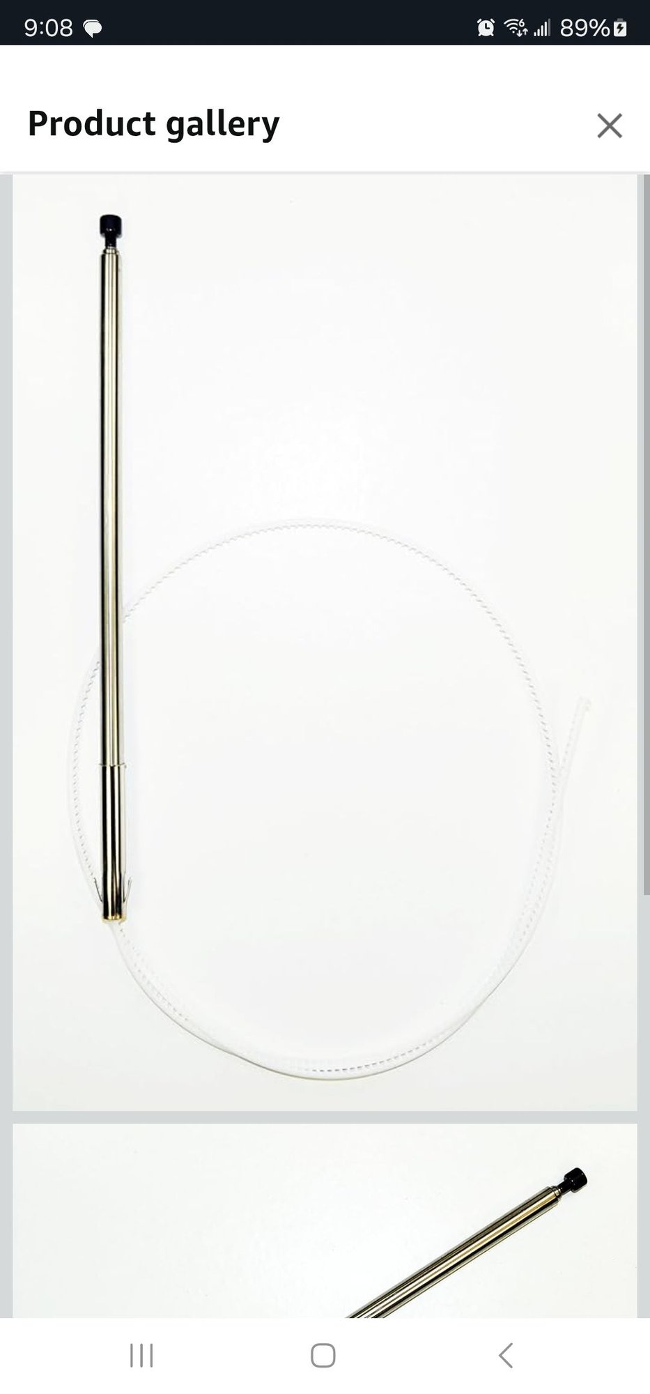

You have a couple of issues going on.
The antenna is the broken plastic mast ribbon, as others have said.
The radio receiver is separate from the head unit in the dash. That receiver is where your problem lies.

Default An example of the mast with the ribbon.
