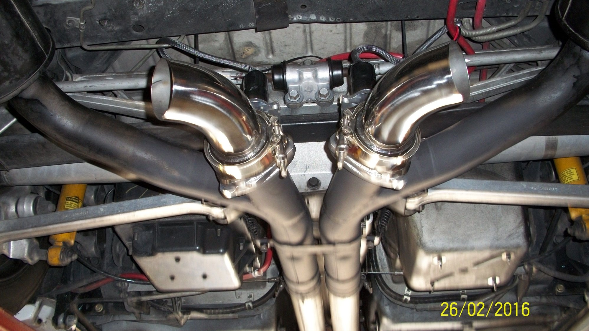

I have installed 3" in cutouts on my 1990 ZR-1 from Qtp, Modified a LT one exaust and had extensions welded just before , Just check the picture
I removed the complete spare tire assembly as i have an extral transmission coller in its place. A switch by the drivers seat controls the opening and closeing and any pl
ace in between.The down pipes are adjustable to the side and down close to the ground.
John

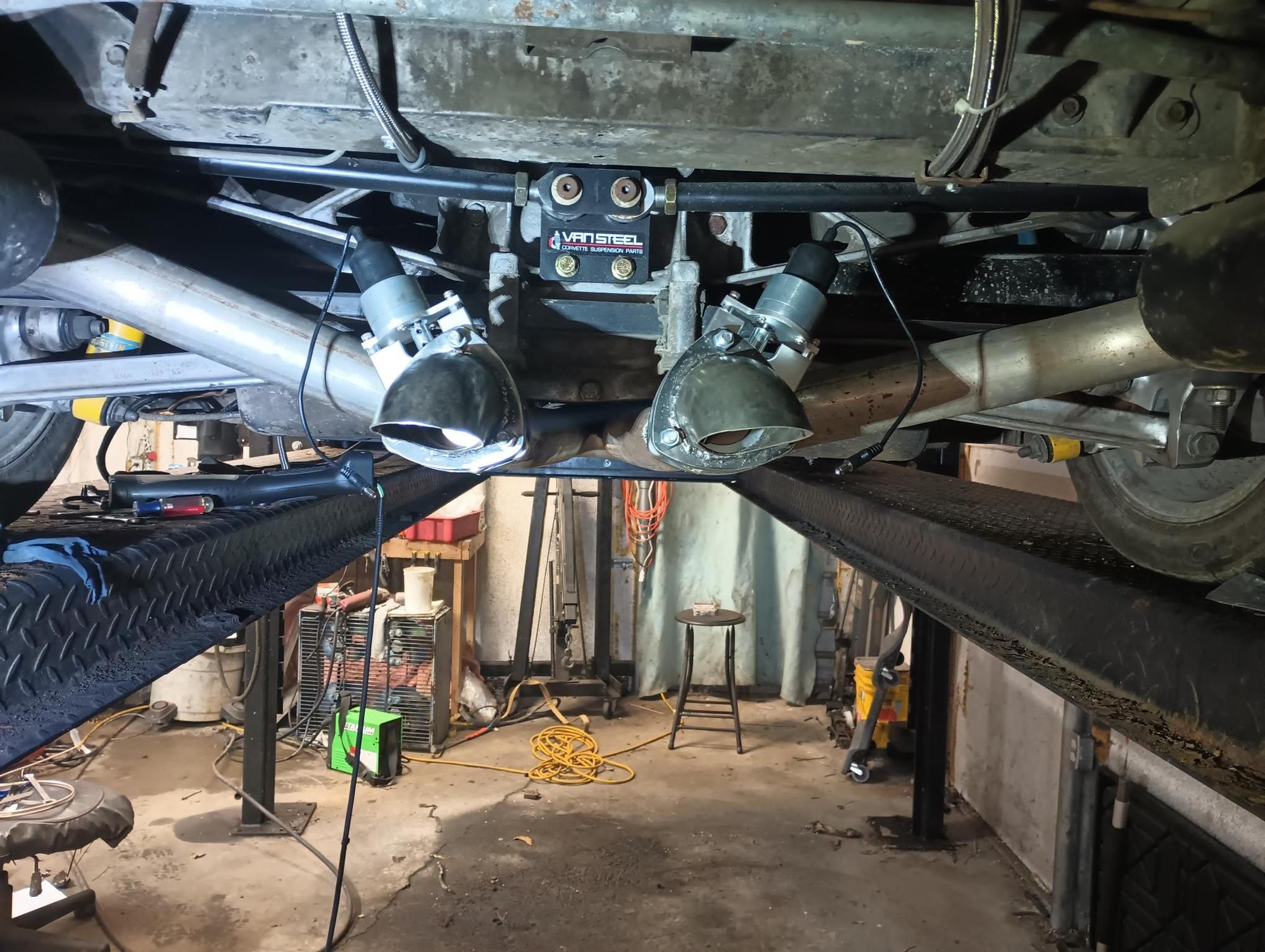

I have cutouts on my 84.
This pick was taken during the install. I didn't have the wiring done yet.
Also if he want's something a little less permanent I fab and sell test pipes for 84-85 C4's. They're nice because you can just swap the cat back on if you need to get it inspected. And there are no permanent mods to the exhaust. They make the exhaust sound better without a lot more drone inside the car.
Here's a pic
